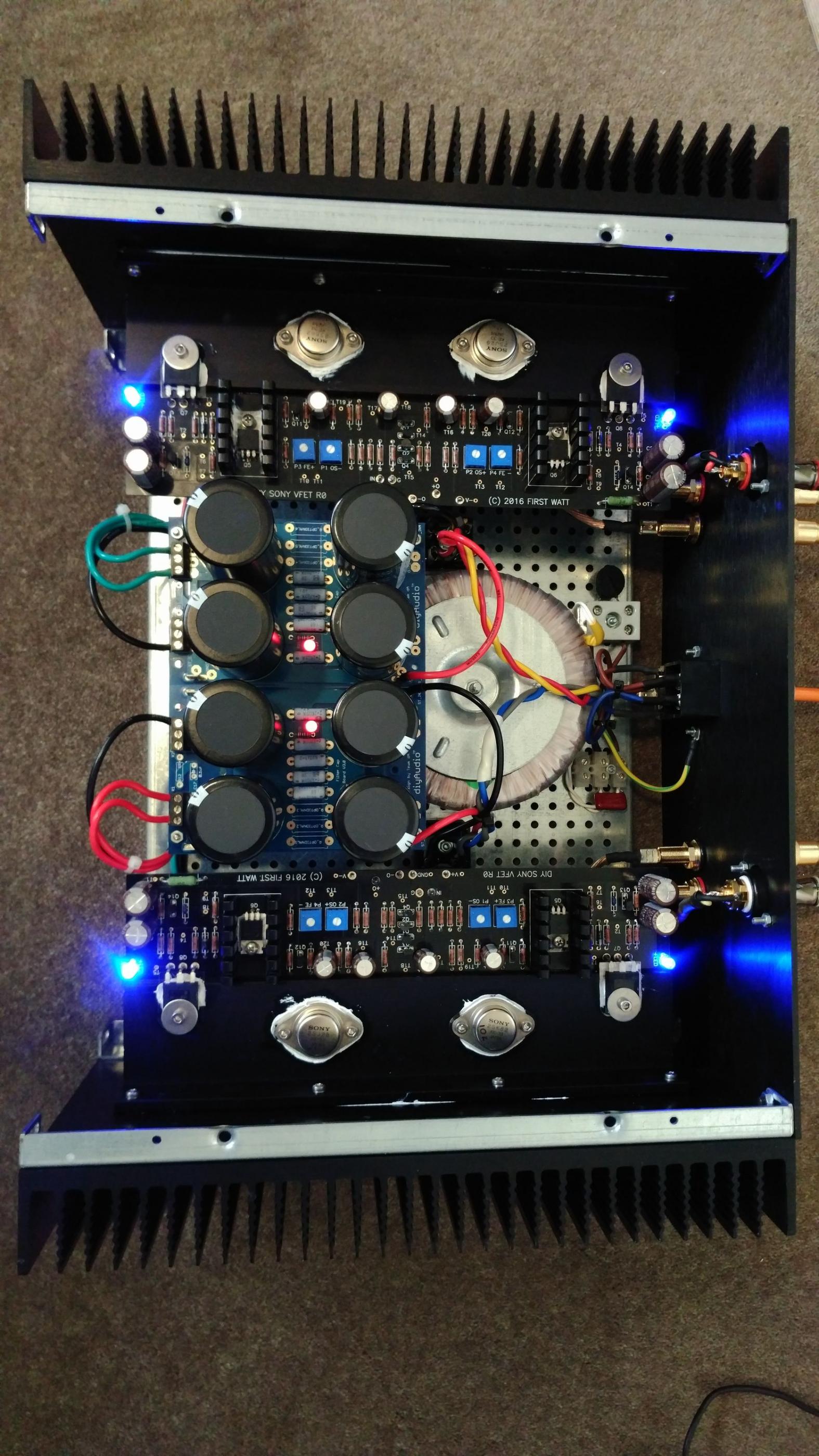

I have mine up and running. Thanks Nelson for your great design and generosity. Thanks also to everyone in the Diyaudio community that contributed to this great project!
It was a challenge to get the bias set accurately. One thing I ended up doing which I think helped a lot was to short T18 to ground then setup the output bias. This was done a once the FE was set for 1.5v drop as close as I could get it. Once the output was bias was accurately set I tweaked the T18 offset using P3 and P4 to get as close to 0v at the output as possible. This idea come from this post by Nelson :
http://www.diyaudio.com/forums/pass-labs/276711-sony-vfet-amplifier-part-2-a-178.html#post4811750
It was a challenge to get the bias set accurately. One thing I ended up doing which I think helped a lot was to short T18 to ground then setup the output bias. This was done a once the FE was set for 1.5v drop as close as I could get it. Once the output was bias was accurately set I tweaked the T18 offset using P3 and P4 to get as close to 0v at the output as possible. This idea come form this post by Nelson :

You will cringe but I ended up using these terminals to make connections to the main boards :
http://au.element14.com/te-connecti...0000001472&searchView=table&iscrfnonsku=false
They are undersized for the holes but were very beneficial in terms of serviceability.

DC offset problem
I've done the Part 1 and Part 2 tests and everything is fine up to there. With P3 and P4 fully counter clockwise I've got 0v across R5 and R6. At that point my DC offset is about 200mV. However as I increase the voltage across R5 and R6 the DC offset starts to rise alarmingly. Can anyone suggest what might be wrong?
Those pots adjust both the current for the VAS and the DC offset.
Maybe you want to review the procedure for this adjustment.
Measuring at T6/7 and T8/9, I went about 100mv at a time, back and forth, to keep a near-balanced condition at all times.
Well I successfully got the voltages across R5 and 6 up to 1.5v with the DC offset at about 200mV. I suppose I was surprised at just how sensitive it is - the slightest movement of P3 or P4 is enough to send the DC offset up to 5 or 10 volts. Is that to be expected ?
I have similar experiences.
Especially, when I used fake 2SK170/2SJ74s.
Actually, in this case, it was impossible to set it correctly.
Now I have DC offset under 5mV.
