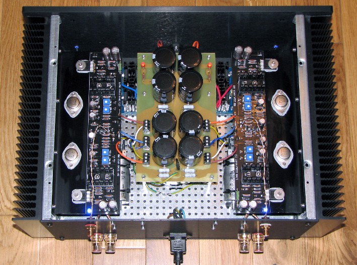

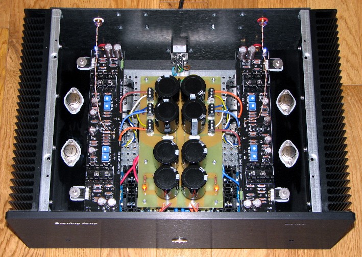

Success ! After being put back on the right path I was finally able to bias up the front end and hit 70 MV offset ( t18-gnd). Very twitchy pots, it might have been a bit easier with 25 turn pots instead of the single turn ones though, but now the job is done. Hopefully I'll find time this weekend to install the VFETs and finalize things. I'll go dig out some cheap speakers for the maiden voyage.
Paul
I have tried both multiturn and single turn pots and much preferred the single turn. It is touchy with either one and easier to me with the single turn. I am now rebuilding my SE BA-3 amplifier with boards I removed years ago and much the same procedure of biasing and zeroing dc offset is involved in the BA-3 front end board. Anyone who has built the BA-3 preamplifier will be familiar with the procedure.

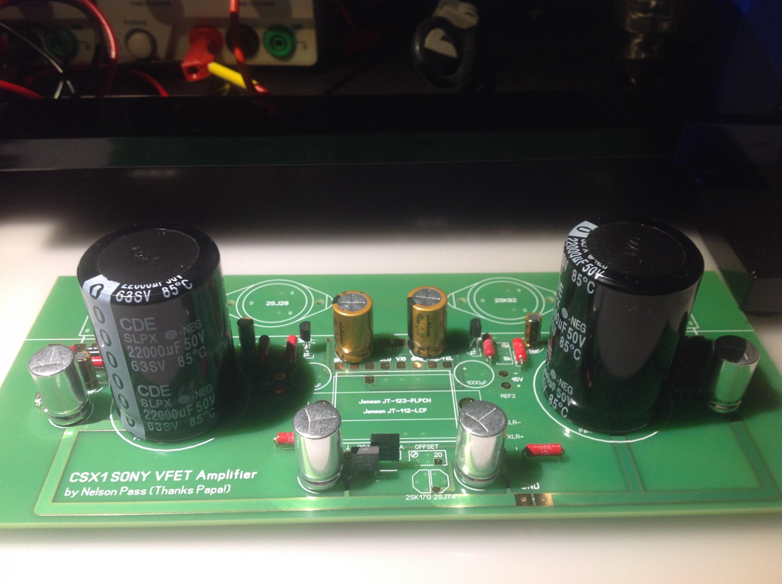

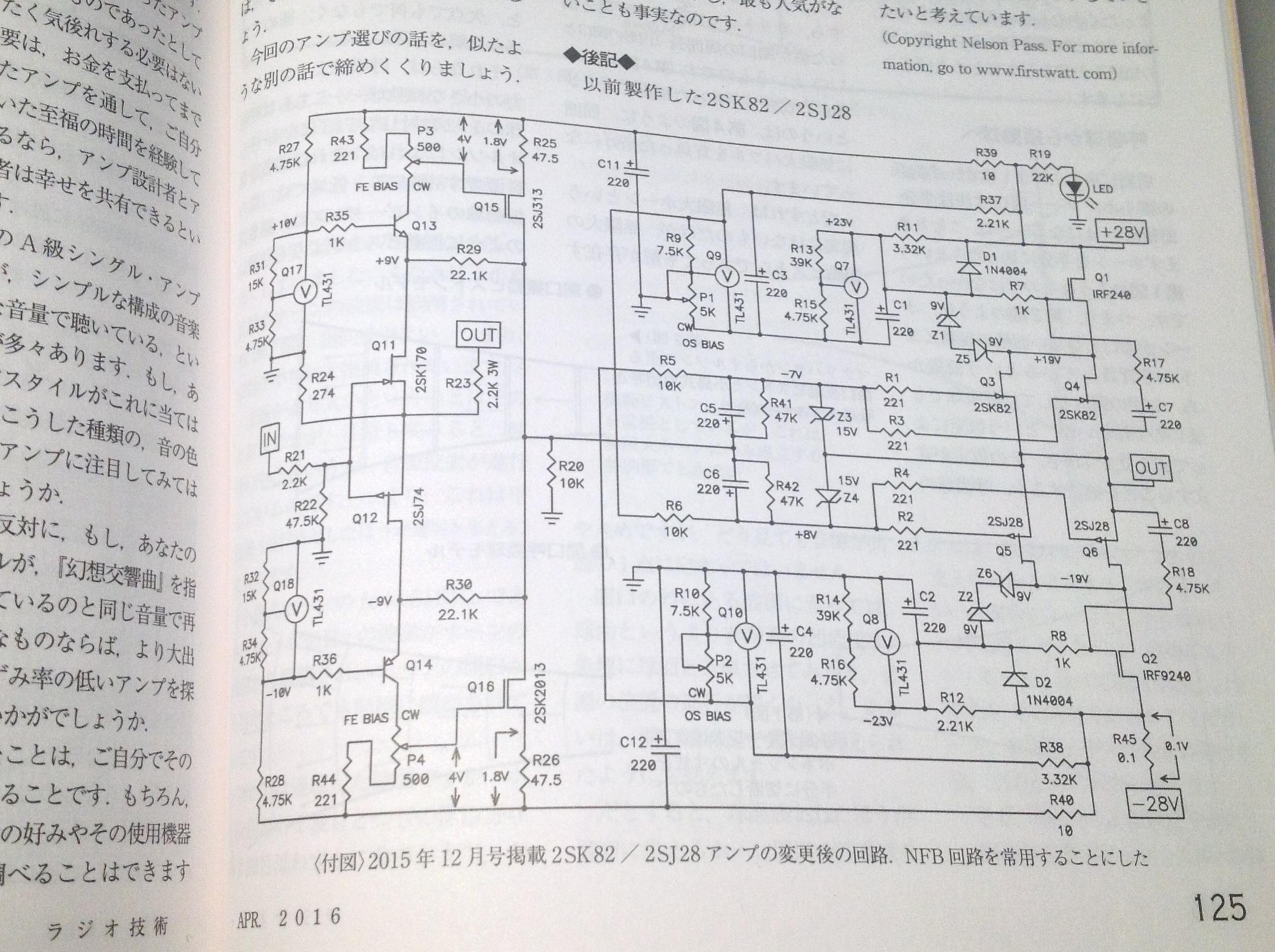

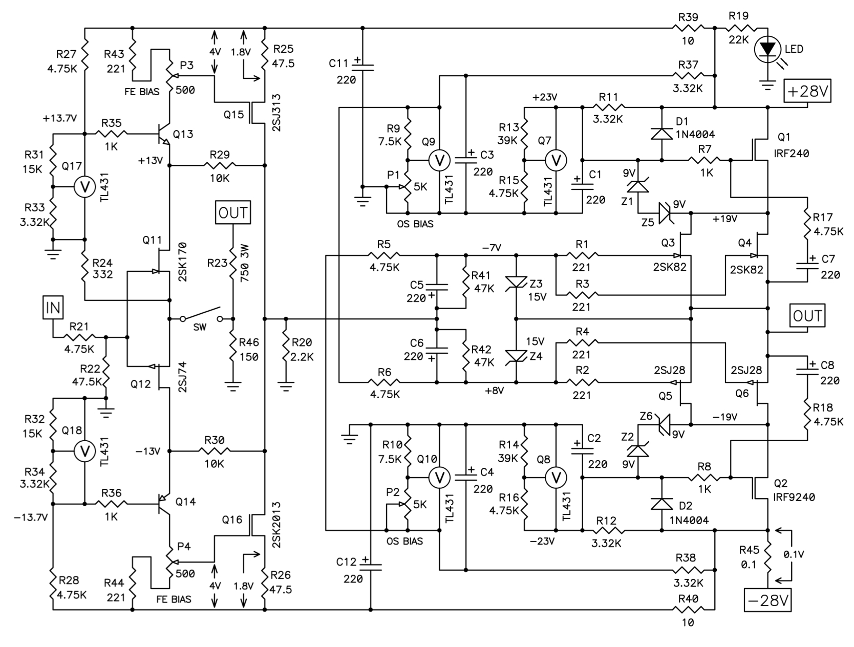

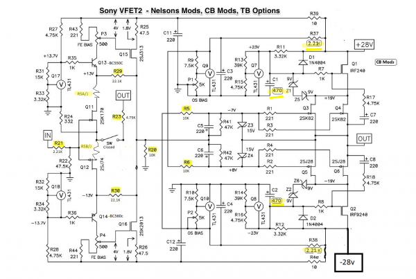

Yes but only 3 pcs in stock today. Papa use 4 x 15000 uF and is sufficient.
All caps 35 V | 15 000 uF or biger capacity ( 22k or 33 k uF )
and higher voltage are ok if they are 35 mm diameter version for DiyAudio Store universal psu pcb´s.
http://www.mouser.com/ds/2/88/SLP-15028.pdf
http://www.mouser.fr/Passive-Compon...4atvZ1ypb2ikZ1yx4avv&Keyword=22000+uF&FS=True
I do solder Cornell Dubilier on Vfet CSX1 boards filter psu last days that industrial nice quality caps imho.
