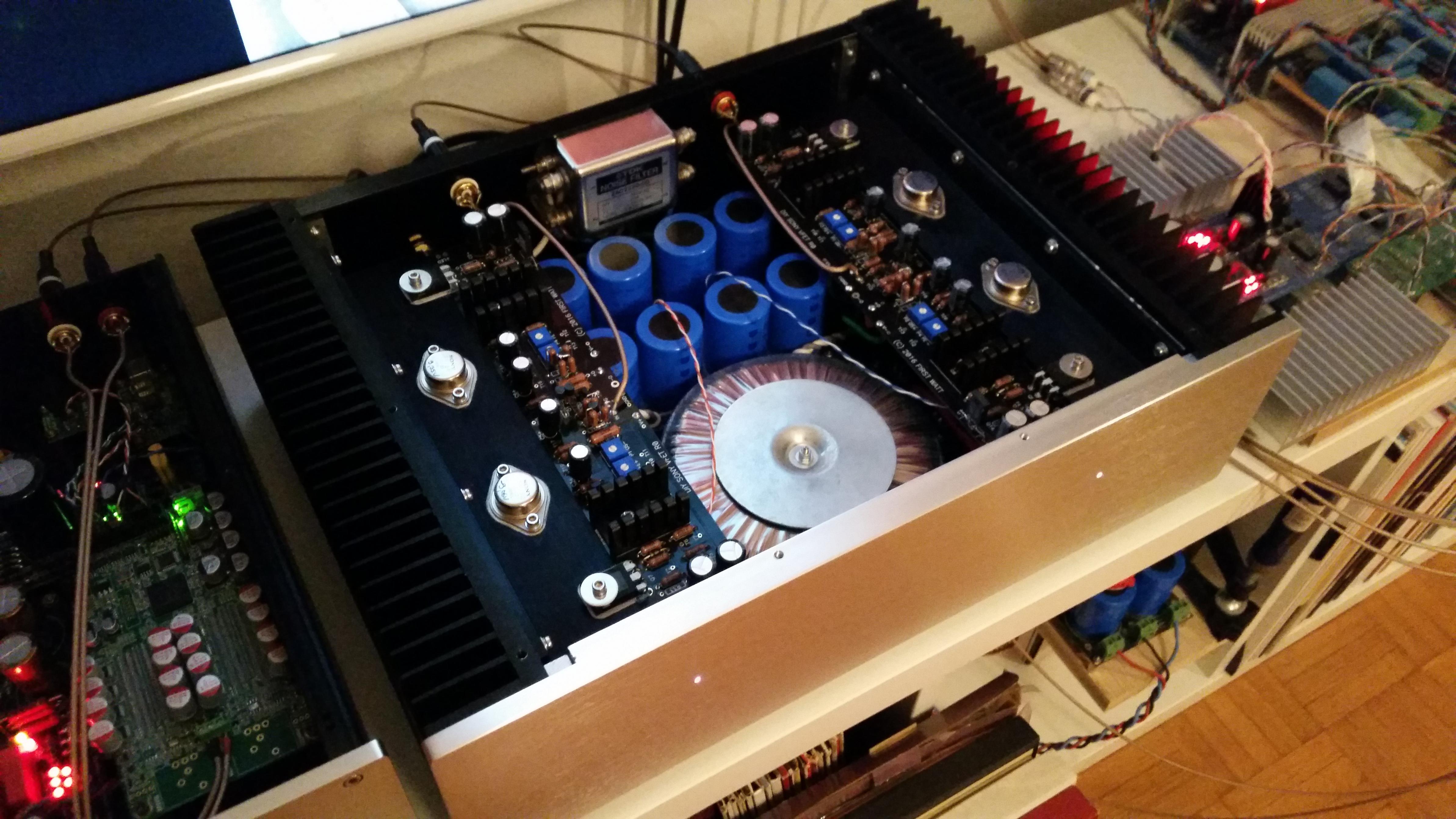

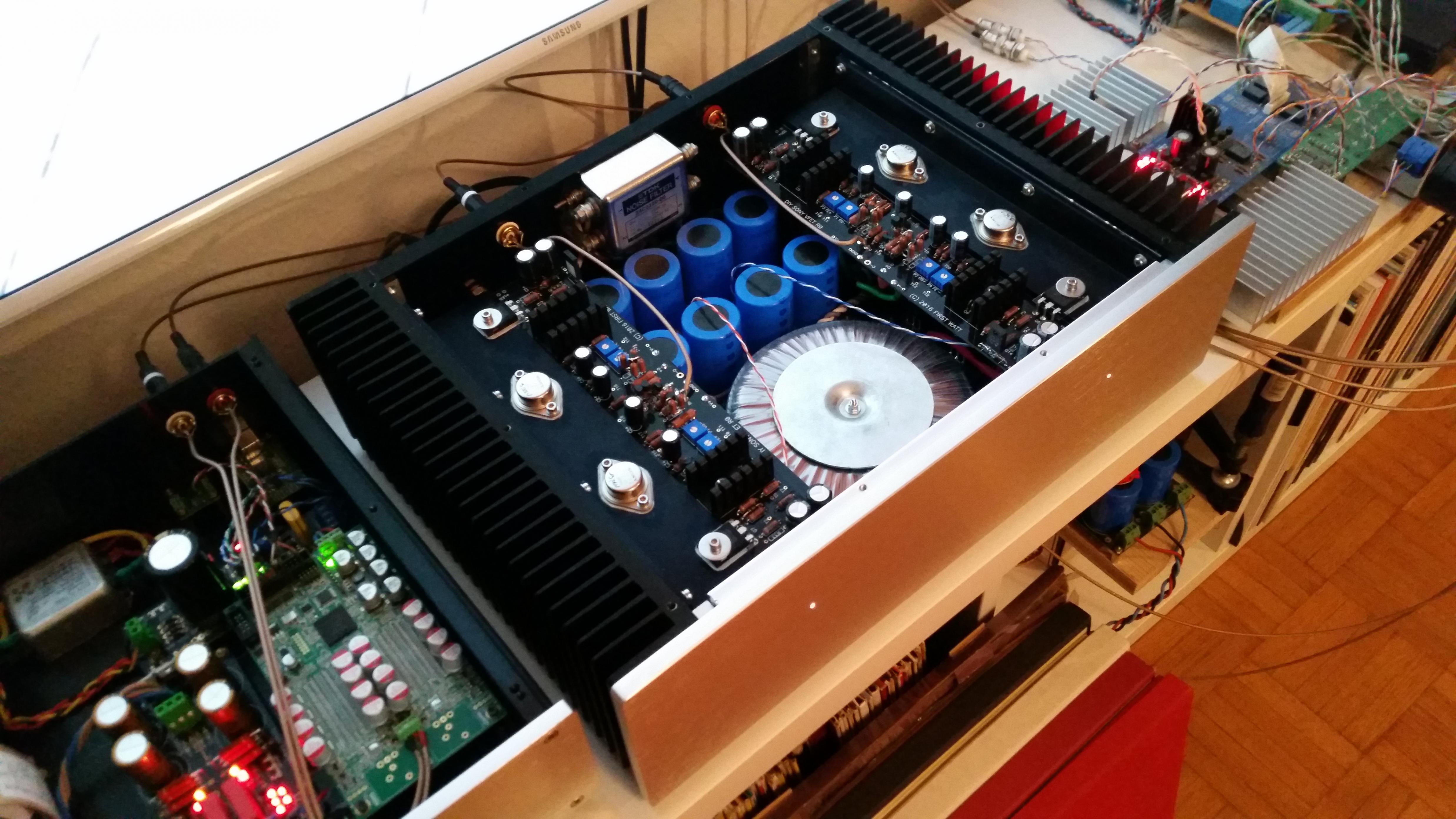

You know when people talk about pieces of audio gear that make them "rediscover their music collection"? As cheesy as that sounds, this amp is one of those.
Nice amp. what is that gizmo behind the filter caps?

Rodeodave, this is a nice build ! From where is your power supply board, it's from the store ?
What preamp are you using with your Vfet ?
