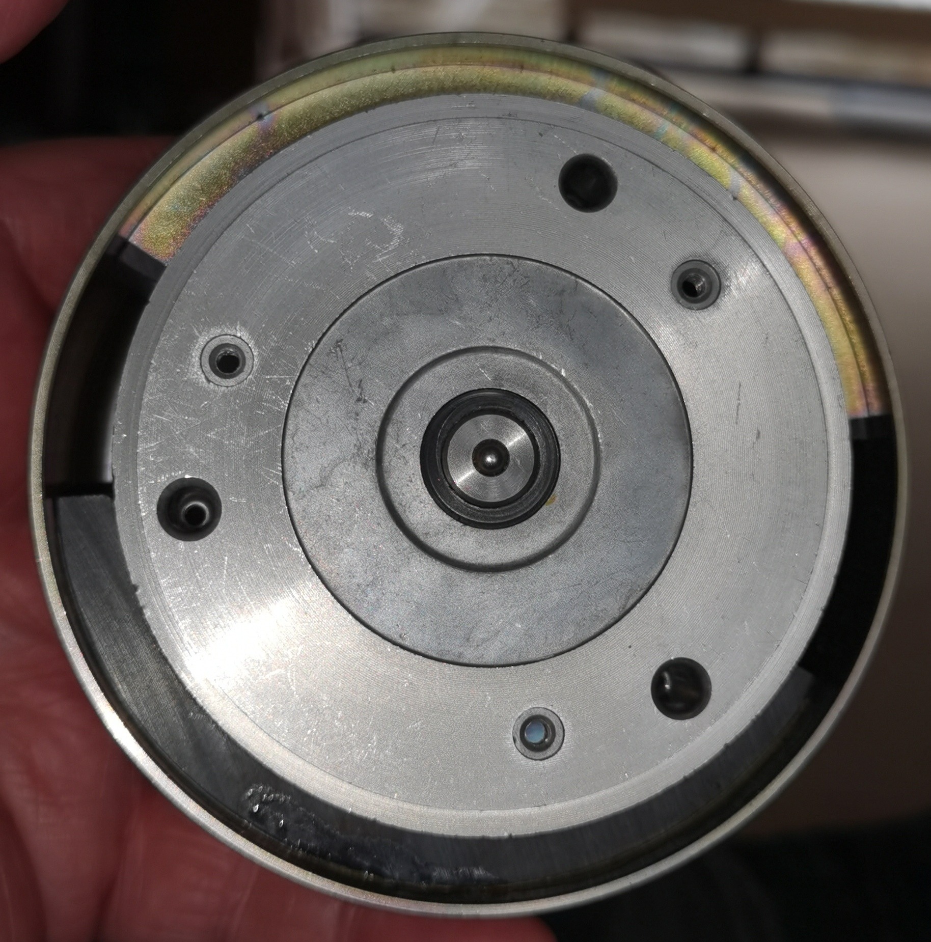

As said previously I was anticipating further work to be undertaken on my Bearing Housing Modification.
This Bearing Housing shown in the pictures, is the one that has been the donor housing and with the work undertaken has now had the operation of removing the bush liners five times if the originals are included and has had New Part Bushes added four times, as part of the R&D and fitting procedures carried out on it.
The Bearing in the pictures has been inspected yesterday and is yet to receive lubrication, the fit of the Spindle within the housing, 'is to my standards', an exceptional fit and a vast improvement to the condition of the original bearing using my recollected memories.
The information requested by group buy members on fitting the supplied parts will soon be offered with additional information that will be useful and hopefully help secure a confidence for other GB members to continue with their ambition to exchange parts.

being torlon (bearing grade) it shouldn't require any lubrication should it? i suppose what grade of oil you use really depends on how much play there is after reaming?
A Thrust Plain Bearing performs at its best, as a mechanical device when there is a Hydrodynamic Lubrication in place.
When this condition is in place on a TT, it is acting to stop parts within the bearing assembly coming into contact.
There are many TT Bearing Designs being developed in the recent years using Thermoplastics and are making the condition of Hydrodynamic Lubrication being present known.
The tighter the tolerances between the rotating parts will mean a low viscosity lubricant, such as a Silicone based Lubricant, can be used, which will mean an decreased coefficient of friction exerted on the bearings function.
Silicone Lubricants are not detrimental to Thermoplastics and there are 100's of viscosities available due to the wide ranging uses of the Thermoplastics in mechanisms that are being produced.
As stated in a previous post, now there is a method in place to contain Oil in the Sump, a fill level of a persons choice can be put into the Shaft, the level of fill chosen can mean the Hydrodynamic Lubrication condition is always present.

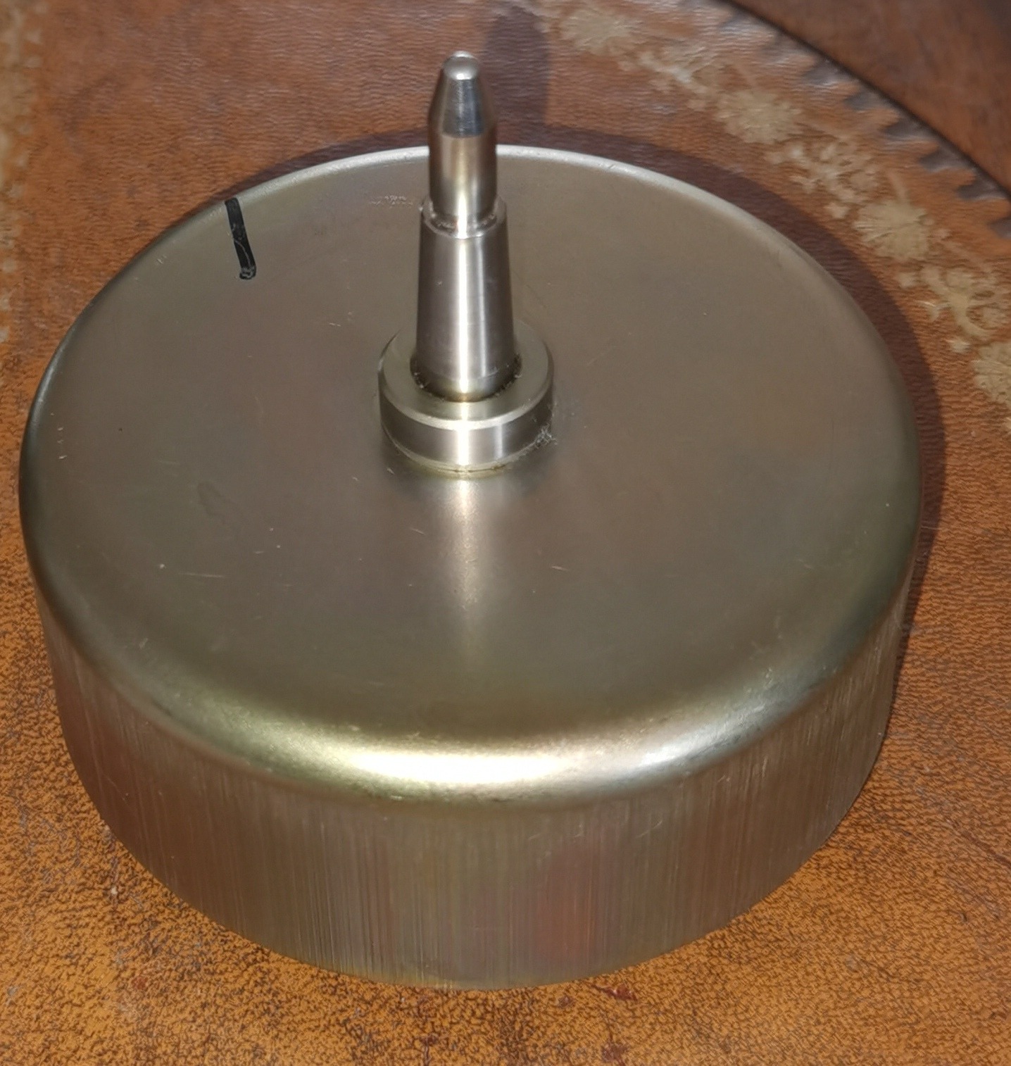

so today i had a chance to fit my new torlon bushes, first i made a bearing puller to remove the old bearings.
next in the lathe and reamed to size.
here's a video of the assembly turntable running and showing the spindle run out.,each line on the dial gauge is 0.01 so im around 0.003/ not bad for a first attempt ! 🙂 click on the gauge photo to see vid.

A interesting investigation, and the Machining of the Parts looks very well executed 👍

cheers john,im very happy with the tolerances i can achieve. further reading on the virtures of lignum vitae bearings can be found here. https://www.google.com/search?client=firefox-b-d&q=lignum+vitae+bearings
I have seen Lignum Vitae suggested as a Thrust Pad Material in the past, to use it as a Bush Material is an adventurous undertaking.

Hi John,Panzer could be tried for sure. experiment is the name of the game here i think.
In the meantime i have made a new set of lignum vitae bearings,these have come out better than the last set as i get used to the process of making them.
I have been running the TT since yesterday afternoon and listened to them most of the evening. I'm happy with the sonic presentation,i think the noise floor has dropped some more over the Torlon but that may be expectational bias, im experiencing a natural tone to acoustic guitar which ive not heard better in my system.
Just now i have inspected the bearings and can report nothing untoward,but then if its good enough for the the aft main shaft strut bearings of the USS Nautilus - the first nuclear powered submarine its going to be fine for my little ole turntable
