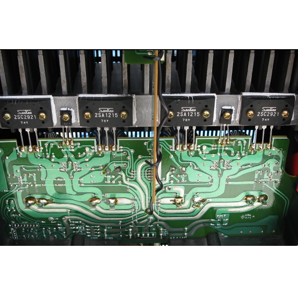

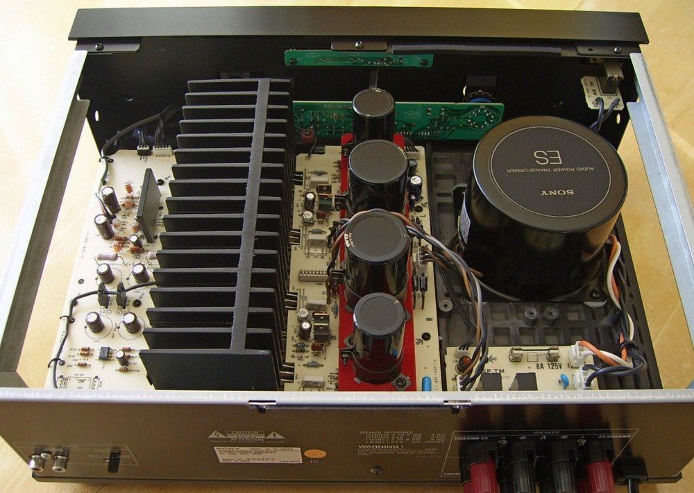

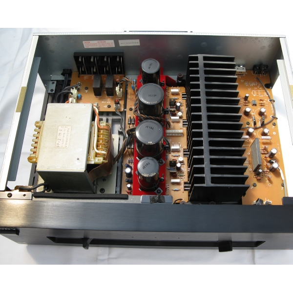

Power output BjT Devices be broken again and again - unknown Reasons
The schematic is here:
Sony TA-N55ES Manual - Stereo Power Amplifier - HiFi Engine
One of the reasons, that I note, are follow:
1) Counterfeits/copies (like iSC) for 2SA1295 and 2SC3264 resp. 2SA1216 and 2SC2922
2) unwanted oscillation occurs in the mode without output power devices (3-4MHz)
Which experiences are present in the meantime?
In the schematic I note, that these capacitors are in use for compensation:
C329 between inv. and non inverted input
C305 parallel at NFB resistor (voltage gain factor ~160)
C303/C308 (lead-lag compensation - go to
http://www.analog.com/static/imported-files/application_notes/AN-257.pdf
for understanding)
Most suspect is for me C329, because at the same place just this capacitor in an Onkyo integrated amplifier caused unwanted oscillations and damaged output power transistors - go to the PDF attachment.
The German thread regarded Sony TA-N 55ES with STK3102-III about
Sony TA-N 55ES Problem, Hifi-Klassiker - HIFI-FORUM
don't provide any advices.
Thank you for your hints for remove the reason for repeated failures at the output.

Hello tiefbassuebertr.
I agree with you for a possible reason for repeated failure in power output.
Another possible cause is the different gain and vbe for the power transistors.It is important a selection for this parameters.
Not only a simple oscillations are the cause of "strange" broken, a simple 1 kHz square wave with 8 Ohm load should be checked at 1, 2, 5, 10 volts.If all is OK, another important stuff is a control over what happens with the output connected to a capacitor of 0.47 uF and 3000-4000 Hz square wave signal at 2-4 volts output.
Caution with this measure, in case of problems the output transistors are destroyed.
The output stage is pretty similar to 630/650ESD. In a couple of cases I dealt with the overheated STK was the problem - it starts to oscillate at 1-2MHz and it leads to destruction of power drivers. Replaced the STK, attached diy heatsink, checked for bad solder joints and both amps are working for more than three years now without a problem.
- Sony TA-N55ES power amplifier
