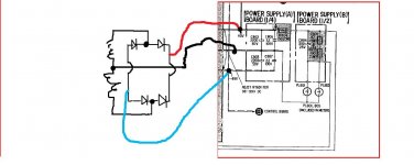

What I was wondering is whether you have a spare ? mains transformer from any other amps that we could rig up too test the main amp is OK.
Any tranny capable of generating rails in the 30 to 50 volt range should be good to test. Even a 0.5 to 1 amp tranny would do. All you would need is a bridge rectifier.

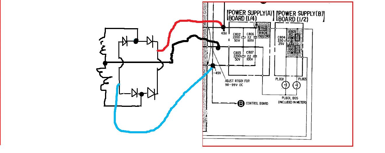

Centre tap of tranny goes to main zero volt point at junction of C802 and C803. That point if you measure it is probably connected directly to the case anyway.
Just imagine your tranny takes the place T603 in the PSU. Wired just the same, all that's different is that your bridge connects directly to C802 and C803 to provide the -/+ rails.

Like this.
A 35 0 35 vac tranny will give around -/+50 volts... maybe a little more at low current. That's not a problem as the 60 watt bulb will pull that down a little.
The original PSU is disconnected... none of it is used. Doesn't matter if the voltage ended up to low to pull the speaker relay in (it won't 🙂) as it still lets us do a couple of quick measurements to prove the amp is OK.

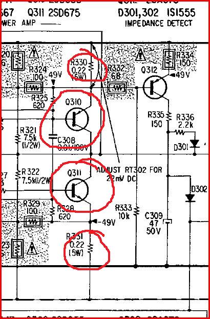

Are you sure all four output devices are OK (none short circuit) ? and also the four 0.22 ohms are OK
If the 0.22 ohms are OK then you can read from collector (the case of each output transistor) to each rail to see if any device is short circuit.
Using a bulb and nothing will pop even there is a short so don't worry, but it makes sense to check as much as possible first.

Hmmm readings on continuity/low ohms setting from the cases of all four On Semi output transistors to each rail on the PSU PCB are completely null. Bad news?
As for measuring the 0.22 resistors it's impossible to get the probes in there as it's tightly packed. I really don't want to remove the heatsinks and the power-amp PCB either as it involves quite a bit of desoldering and shifting around of bits and it's getting a little beyond my DIY experience threshold I'm afraid.
