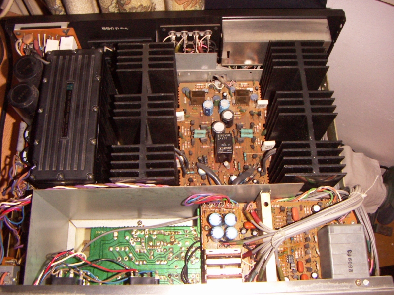

Ah right that's interesting to know - cooler running with that resistor value with the SMPS shut away in that aluminium box as it is, would make sense. The service manual is also dated 1978, and this unit was manufactured until 1981 I believe so there would have been changes that perhaps aren't documented. The aluminum box I mention is said to be there to prevent radiated muck from the SMPS affecting the audio circuit. However I would have thought it seals the heat in too to a certain extent?! Was considering leaving the top off of the SMPS box to aid with convection. Mind you Mooly says the BUT11As are cooler running so perhaps it's not of much concern.
You can see the SMPS box at the top left in this picture:
http://mariuszek.pl/sony2.jpg
- John
No i wouldn't remove it, you will hear the SMPS all over the audio, especially as it's next to the input connectors. It really shouldn't get all that hot as that's the whole point of an SMPS circuit. If they were doing it now, they'd most likely be using MOSFETs

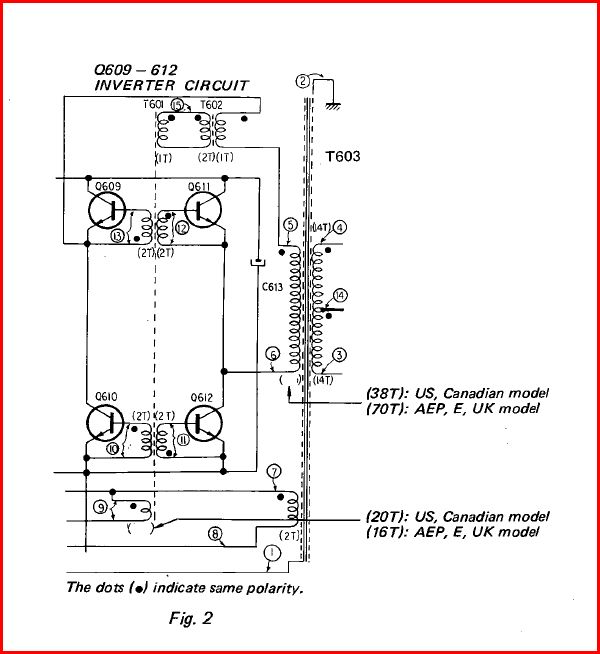

This 'ere power supply...
It's very unusual in that it appears to have major differences between "intended markets. Nowadays a SMPS would work on any input voltage without change.
What I have noticed in the manual, and can't explain is this.
The 120 vac model works on just that... 120 volts and that gives around 170 volts DC as the working voltage for the PSU. The linear reg reduces that to 127 volts as per the manual. The primary winding of the chopper transformer has 38 turns. See attached image.
That's the first version.
The 120/240 model appears to employ a switchable voltage doubler at the bridge rectifier input. This in each case gives around 340 volts DC to power the PSU. Twice the voltage of the single 120 vac model. The output of the linear reg is adjusted now for 250 vdc. Puzzle... the chopper transformer is now shown as having 70 turns on the primary. All else being equal (which it isn't actually) more primary turns will give a higher output from the PSU. That doesn't happen, there is also no "direct" sensing of the output voltage as would be done nowadays... so can't quickly explain that.
As to the resistors... R607 feeds the error amp. It's shown as 56K for the PSU with 340 vdc to feed it and 100k for the one with 170vdc. That too doesn't make sense.
R606 and R609 values do seem right. The lower resistor value on the lower supply as you might expect. The value of R609 in the resistor chain with the pot directly affects the output voltage as it's the feedback network. R606 just feeds the zener reference and isn't critical as such.
It just seems odd having two distinct models... the 240vac one can work in all markets with it's doubler arrangement at the bridge. So why have another "purpose" designed one just for 120vac that uses different transformers etc... dunno 🙂
