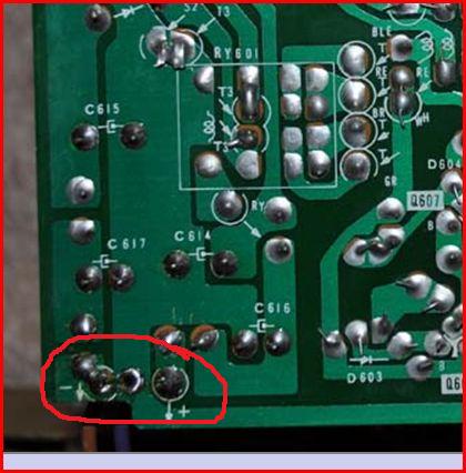

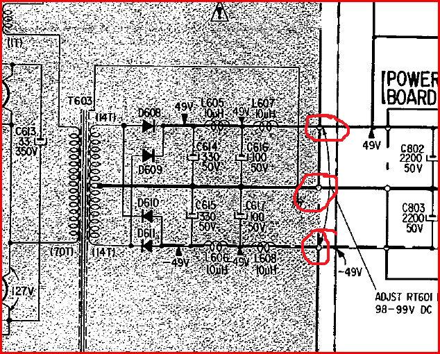

The part to disconnect is as shown here. It's really just the two rails, the plus and minus 49volts that we disconnect.
Hard to tell in your photo, but where I have ringed it looks as though the ground track in the middle doesn't connect to a "wire". It looks like a hole in the PCB ? Is that why it mentions a jumper wire I wonder, maybe the ground connection is completed via another route (as in mechanical when it's all screwed together) and when disassembled the ground connection is missing.
No matter, it's just mains into the board we want and those two rails disconnected. Make sure you note any colour coded wires before you unsolder them. With those two rails isolated it doesn't matter whether the ground circuit is completed to the amp or not.
Does that make sense ?
Edit... I think there are three wires... blue to ground ? It's the one on the right I can't see in the piccy

Aha that makes sense Mooly - mucho thanks! Yes the earth is via screws and directly to the chassis so there's no wire for that. It's starting to make sense now looking at that excerpt from the diagram - there's life in the old brain yet 😉
And there's just two wires in/out from the SMPS board. I'll get some more pics up later.
