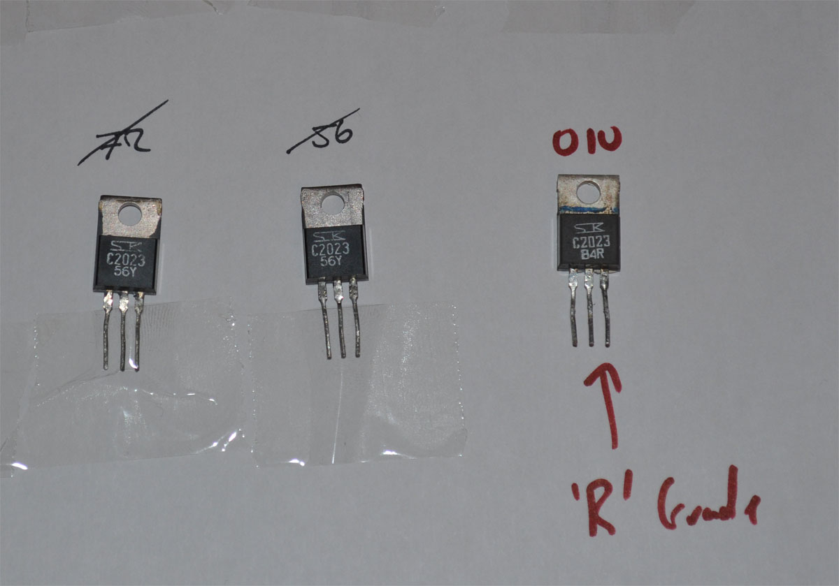

Hi John... just for interest could you perhaps post a picture of one of them. Might not achieve much but I'm curious.

Here's a pic of the transistors:
Interesting to note that the case of the "Sony" C2023 is a very dark grey, whereas the supplied ones I got are all black. I didn't show a photo of it but if you turn over the transistor there is a very tiny number embossed within a circle into the plastic. This is there on both the original C2023 and the ones I received, so I'm pretty sure they're all from Sanken.

They look genuine... that's what I wanted to see really.
Just another thought too... that original one may "read" OK with basic checks but may have run very hot and could in fact be faulty. The data sheet I have quotes 30 as a minimum.
