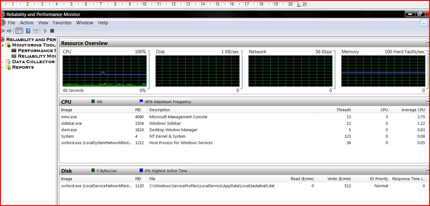

Just to wander of the topic, but I find Vista super stable, quick and generally a joy to use. This screen shot shows the CPU and Disk activity while this DIY page was open in IE8.
Cold boot startup time is around 75 seconds for full desktop/sidebar and aero.
Shutdown time is around 15 seconds.
HDD light barely flicks every couple of seconds.
Four year old Acer Aspire 9301 2GB RAM and AMD Turion 64 mobile.
I clean installed Vista with no "bloatware"... honestly, it's ace.
