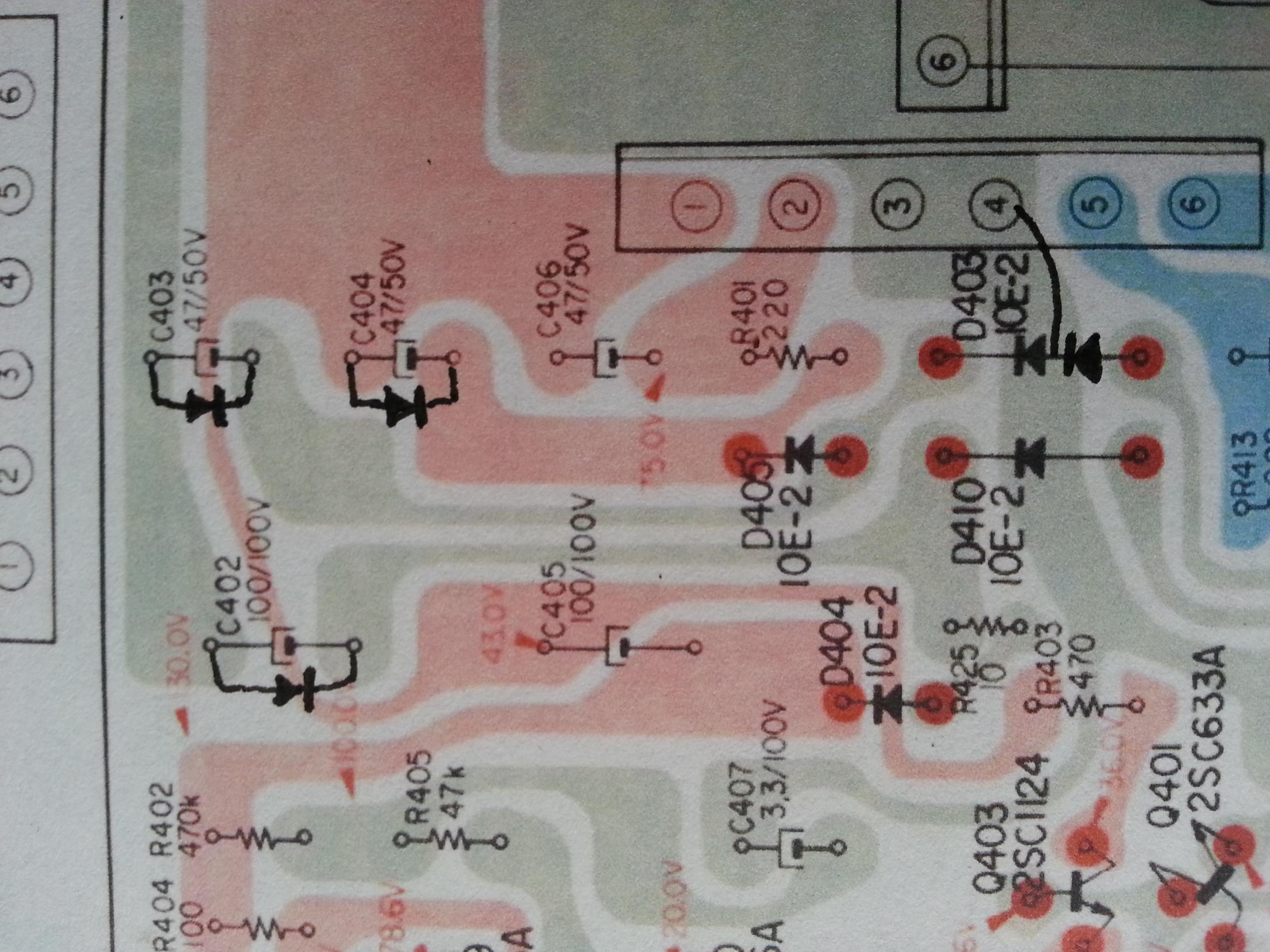

@nashou66 It is coming close to completion, although i am still having issues with the voltages and some further test revealed more voltages are wrong. I did the voltage mod and the cleared up the imbalanced voltages caused by the power supply drifting to one side and it also appeared to initially fix the S-G issue. However its still not right, with the pre and amp inputs separated everything appears ok, as soon i connect the amp and pre or short the amplifier inputs the polarity of s-g reverses and the voltage goes down, at the same time the voltage of the positive and negative bias supply is affected. I have been working with Joshvi trying to track down the issue and he is a massive help. Heres a few photos that show whats going on and how i implemented the voltage doubler mod on the TA-5650. I plan to do a post showing the restoration of both the TA-5650 and the sony st-4950 tuner that came with it once and if i get the amplifier up and running. I've been following your thread over at ak, all the best with your 4650, looks like you're having a little more luck then me at this point.

I've replied to the thread over at ak but i will also post a copy here just so members here don't miss out,
Sorry i haven't posted any updates the last few days, every chance I've had to look at the amp keeps getting taken away. I'll grab those measurements for you tomorrow Smufer and see if i get AC, i do recall testing at some point and i think i did but cant recall what voltage. I too have considered doing exactly what you did and installing the v-fets. The reason i thought this is the amplifier did play for the very brief moment i tried it before i touched it, the bias was a mess but it did work. Once i pulled the v-fets i found one seems semi faulty, potentially still working but damaged and the voltages to be all weird? On one meter it would read open circuit as it should, on the next meter i'd get 0.99v and then 0.55v reversed, its to late at night to remember what pins that was on. After the reccap and double diodes on the amplifier board along with replacing everything else i hoped it would fix the issue but it didn't. First i'm going to try replacing all the small value capacitors film and ceramic, i have had troubles in other amplifiers before that had me tearing my hair out only to find a small value cap that would appear fine then do funny things under certain conditions. Next it has been suggested to me to add a small value cap to the place on the board near the bias adjusters, there is the screen printing for it labeled c306 and c356, they are not mentioned in the service manual, . Apparently earlier versions of the amplifier had this capacitor and ilizm who suggested it had found that some of the newer models that had oscillation problems were solved by adding it back to the circuit. What i do know is i defiantly don't want to blow anymore v-fets, i was extremely lucky that Joshvi happened to have a used one of the rank i needed and was willing to part with it, it would be a nightmare trying to replace all 8 of them!

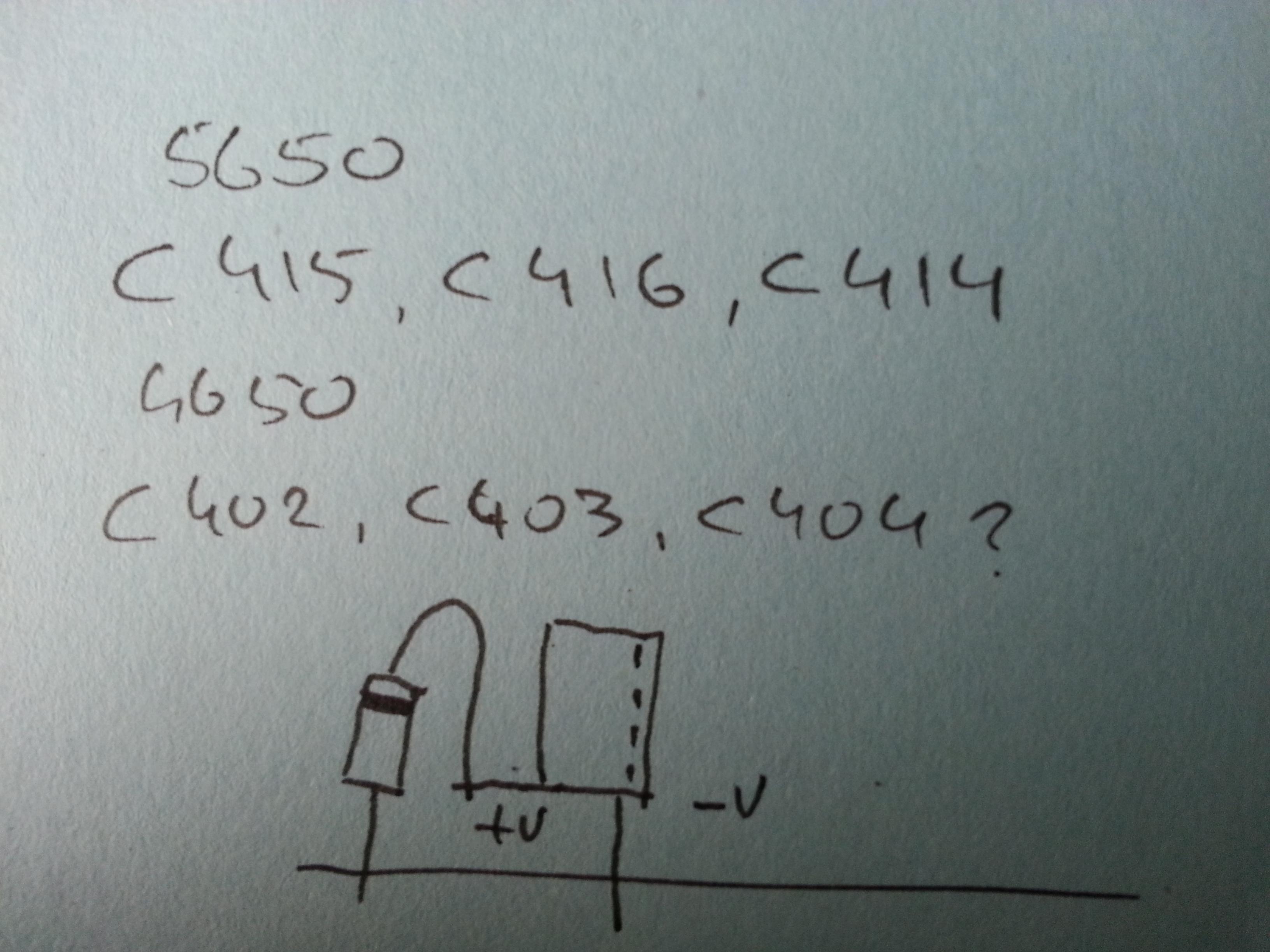

Hi there,
Need some advice about the mod, more specific about how to mount the diodes at C414, c415, c416.
For the 4650 the location of these diodes is C402, C403, c404?
Thanks...
