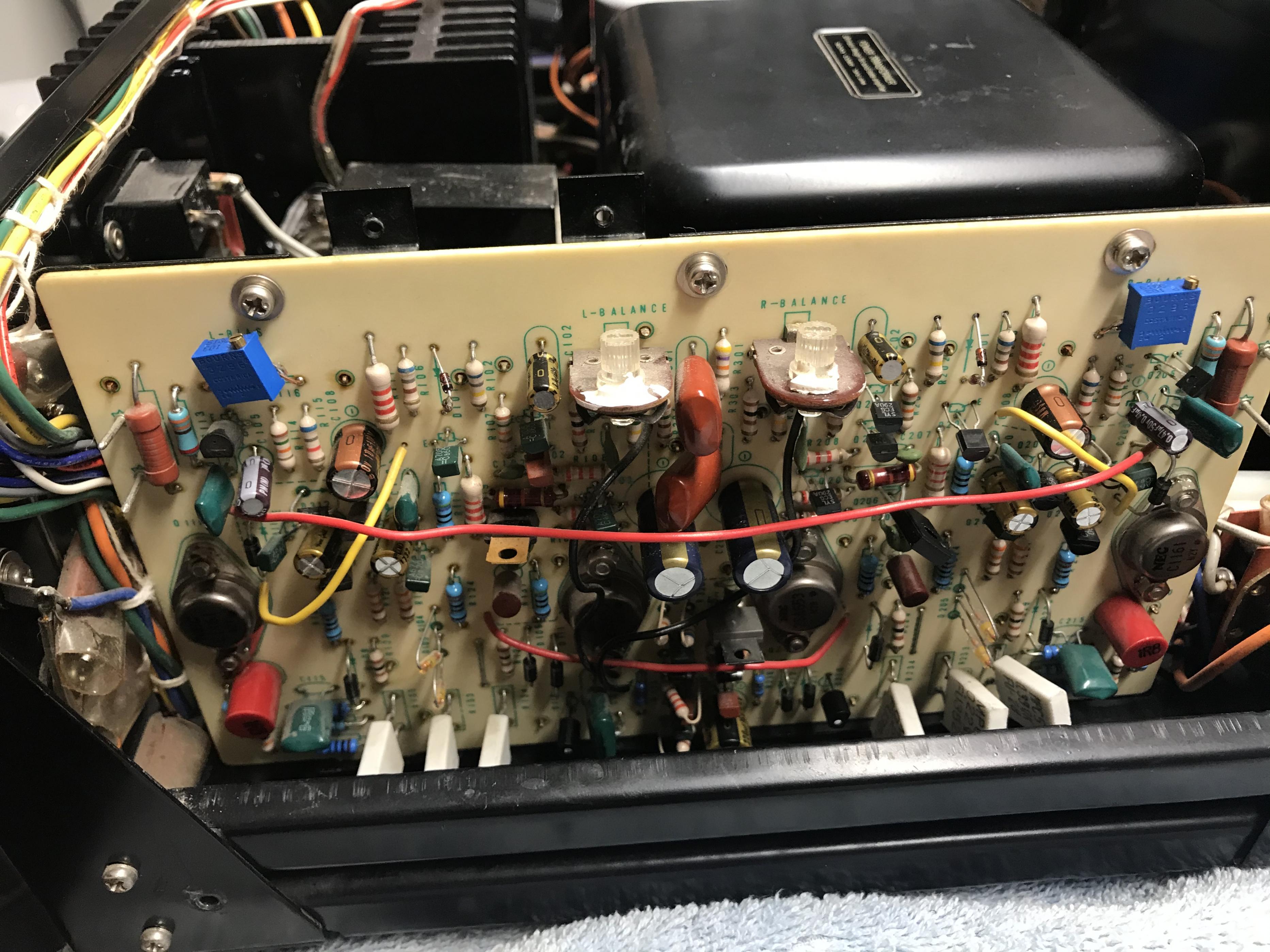

I was given a Sony TA-3200F that cosmetically is in very nice condition, but electrically it was pretty bad. When I received it both of the fuses on the power supply board were blown and there was a dead short in the amp. So I set to rebuilding it. I did a full electrolytic recap, including the main filters. The power supply board is basically new. New 1N5404s for the bridge rectifier, new 1% metal film resistors in place of the old carbon comps, new fuses, every other diode is new and of course the electrolytics. Pretty much same treatment for the amplifier board, all new diodes, etc. I thoroughly cleaned all of the controls, removed the outputs to measure them and put them back into the heatsink with new insulators and thermal compound.
Now here is the issue I’ve been chasing that’s causing me to lose all of my hair lol. This is the right channel only, when the gain control is all the way down I get a pretty decent buzz out of the speaker and it causes the heatsink to get pretty warm. Once it’s warmed up a bit then it makes the buzz when it’s all the way down and all the way up. Like just the last 5% of either extreme. After about an hour of music play then the buzzing in the right channel is there no matter what position the gain control is in. If it was only there when it was all the way down and stayed that way I wouldn’t care too much.
Here is what I’ve done. I thought it might have been the gain potentiometer would I pulled them both and swapped them between the channels. Didn’t help, so not the pot. A suggestion of a possible transistor starting to go was mentioned. I got my can of freeze spray to see if I could isolate the issue. I sprayed Q205 and the buzzing went away completely, eureka! I changed out the transistor and the buzz was still there. I sprayed the brand new transistor and the buzz went away completely until the device warmed up again. Same thing with Q204, sprayed it and buzz when away so I replaced it, no help. I sprayed D202 and again the buzz went away, so I pulled both and swapped them between the channels and no luck. Those are the only three devices that when sprayed make the buzz go away. I sprayed every other device on the board with no change at all. I also swapped the outputs between the channels to see if the buzz would move to the left channel.
Pretty much every transistor in the right side has been replaced. When I got the amp it looked like several had been replaced, maybe looking for the issue. There is a power limiter switch on the front that lets you choose full, 1/2, or 1/4. The buzz is only present in the full position. When in 1/2 or 1/4 the buzz goes away. With continuity checking it seems I have good ground where there should be.
I’m desperate lol. Oh and my unit is one of the highest serial numbered ones, above 811,000.

Quick thoughts not fully thought through...
See if the problem remains if you 'break' the Q/R connection to switch S5-2 while also shorting R202 out. That grounds the power amp input directly.
The power limiter looks interesting and you say only one channel is affected and that the noise disappears at lower power settings. Are D316/7 OK? Check both, not just the obvious right channel one.

Hi, thank you for helping out. What do you mean exactly by breaking the Q/R connection of S5-2? Do you mean to just desolder them from the switch all together? I’m sorry, I’m just not sure what I’m supposed to do there. And shorting R202 out, just clip a lead from one of the resistor legs to ground I’m assuming?
D316 and D317 are new, 1N4004s. I’ll remove them just to double check though.

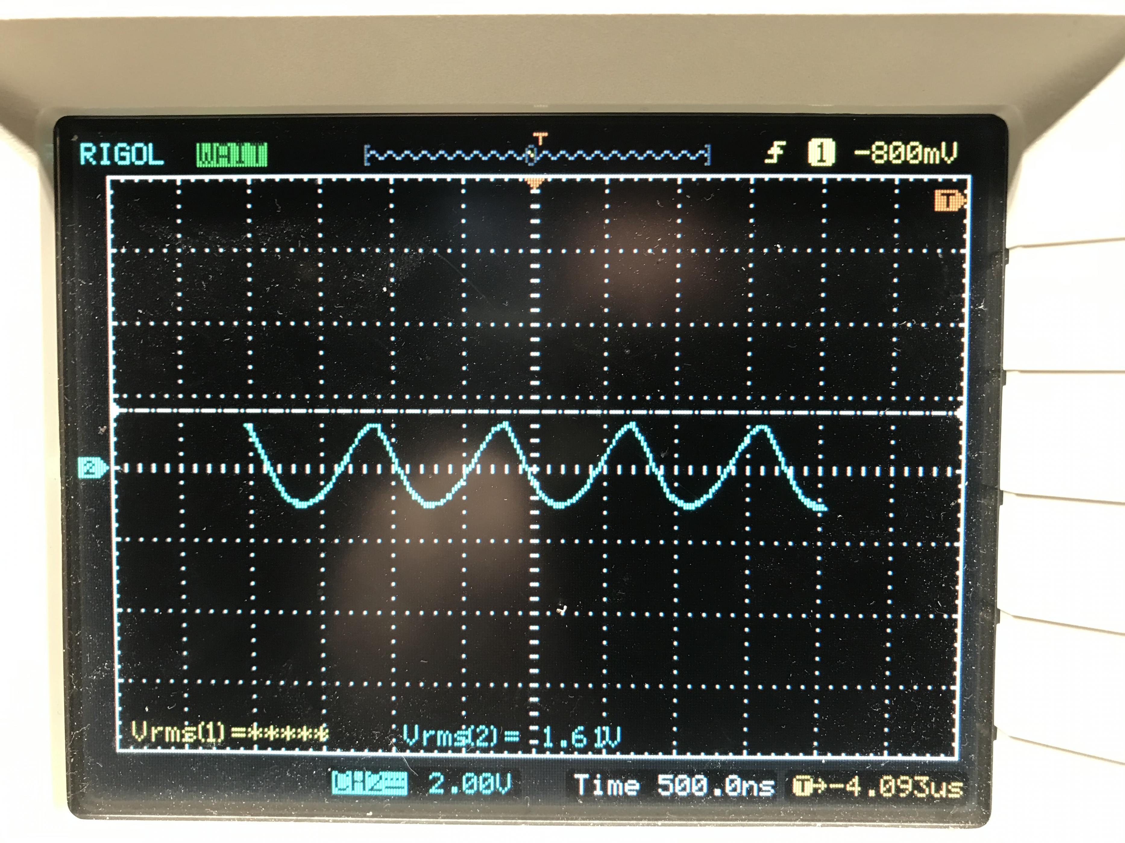

Sorry, I woke up with chills and fever so I didn’t really do anything yesterday. So here is what the signal looks like on the scope. Let me know if you want me to take anymore pics with the scope set at certain settings.

Interesting...
The time-base setting (is that 200ns per division?) implies that is a very high frequency signal.
F=1/T and so 200ns per div would be about 900ns for one cycle on the first image giving about 1.1MHz which is typical for instability.
Second image looks the same. You are showing 500ns per div which again is about 900ns when you just visually look at the screen.
Main related hum would be at either 50 or 60 Hz and the multiple of 100/120Hz for ripple. That would be 20 or 16.6 milliseconds and 10ms and 8.3ms.
So it does begin to look like there is some instability going on here and that could be really difficult to pin down as it is probably semiconductor related.
It may be possible to tame that but working 'live' on full mains means that you could just as easily provoke more oscillation that could be destructive. As always a bulb tester might be a good start, however you may find that limited supplies alter the problem and don't give a true indication of what works and what doesn't.
I would say nothing lost though in having a tweak.

Excellent, thank you for the information. Do you have any thoughts on what the two channels would share that would cause right channel buzz to be eliminated when freezing left channel components?
Would a good start be shotgunning all of the small transistors?

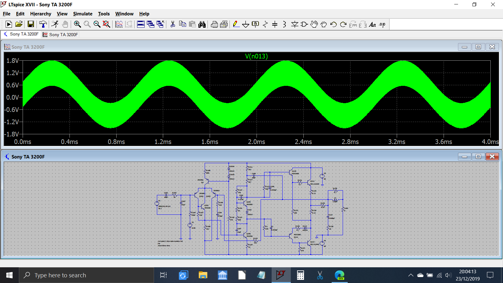

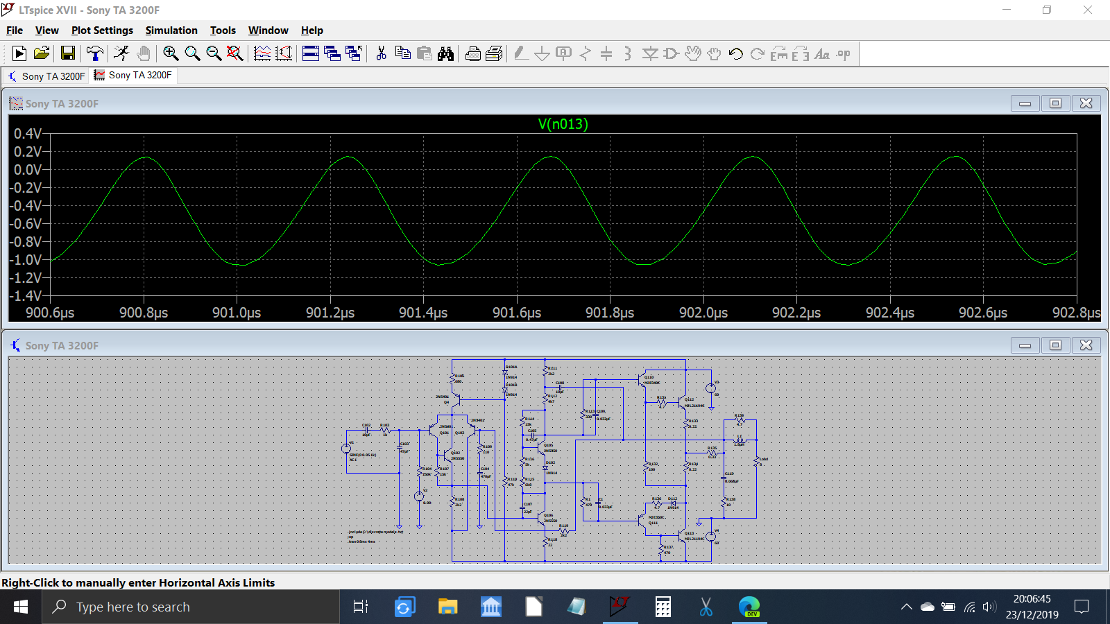

Just for fun I threw the design into LTspice... wow... in its raw form using the transistors I picked (all general purpose type) and without setting bias, in other words first run... and it oscillates just like yours does.
How 😎 is that 😉
The instability looks very similar and is around 2 and a bit Mhz.
How 😎 is that 😉

Really?! Does that mean I should really source original parts? That definitely would not be easy. Ugh.
Dan
I'd say near impossible to get known genuine parts on something this old...
Now I've just noticed a small error in my sim in that I missed C106 off completely, however the amp is still twitchy and is fairly close on the edge of stability even with this fitted and so I would suggest a little tweak of the compensation networks such as increasing C106/107 such as a 47pF for C107 and an 82 or 100pF for C106 and see if that improves things.
