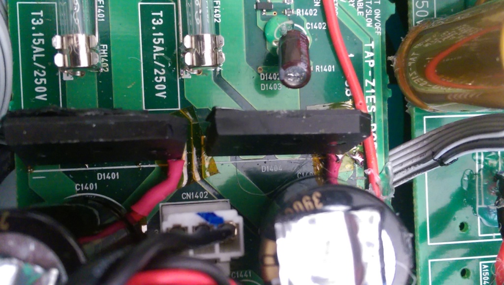

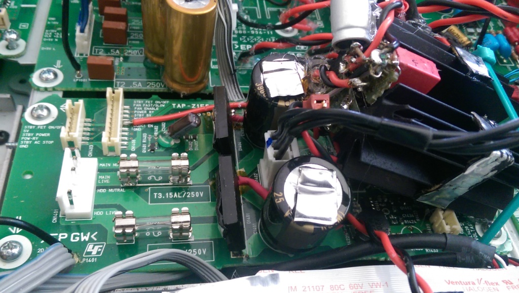

First are two full pictures of the modified digital supply board.
Then a closeup taken straight down on the diode bridges showing the connection on the output leg.

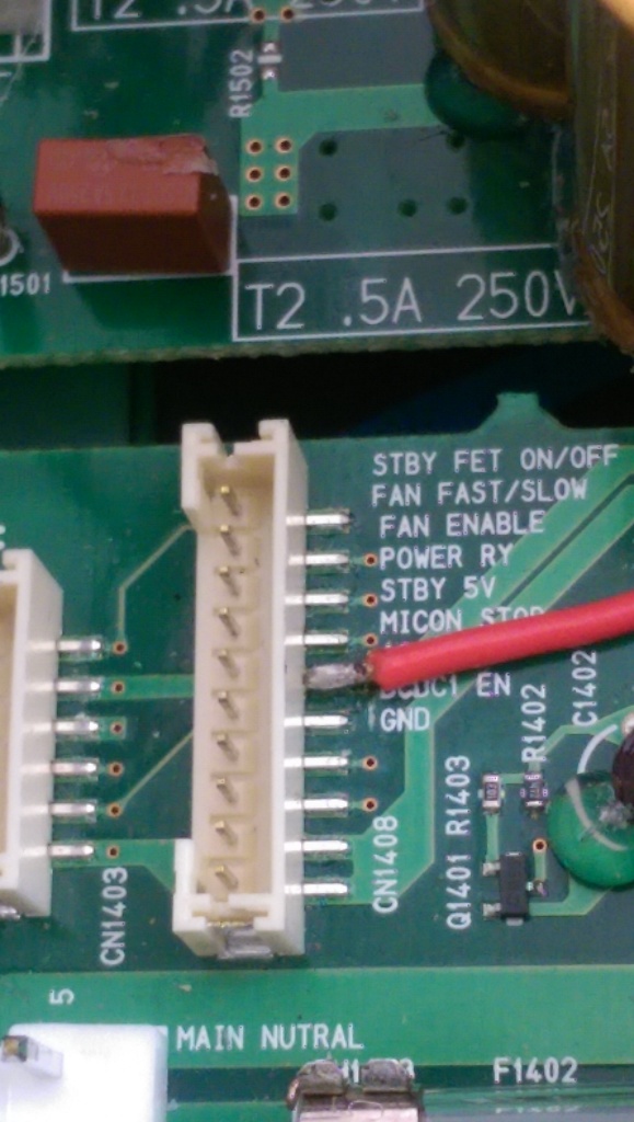

Next a closeup showing the connection to the STBY 5V on position #6 of connector CN1408. Note that the cut trace is directly under the end of the insulation on the wire and you can see a bit of the knife mark in front of 'GND'.

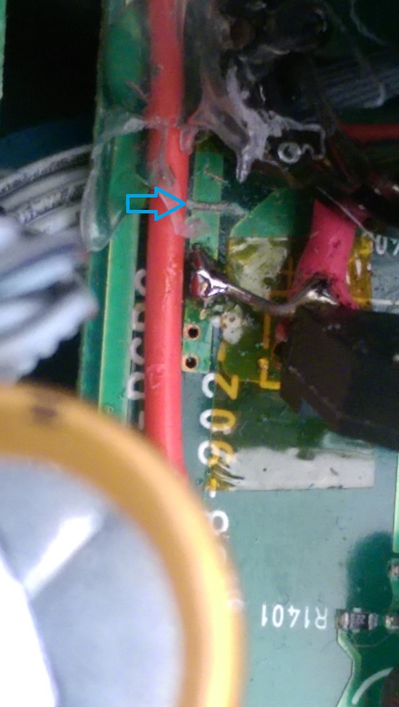

Then a very closeup showing the cut trace for the STBY POWER (marked by the arrow) and connect from the 5v Main diode bridge output leg to where I scraped solder mask off the trace.

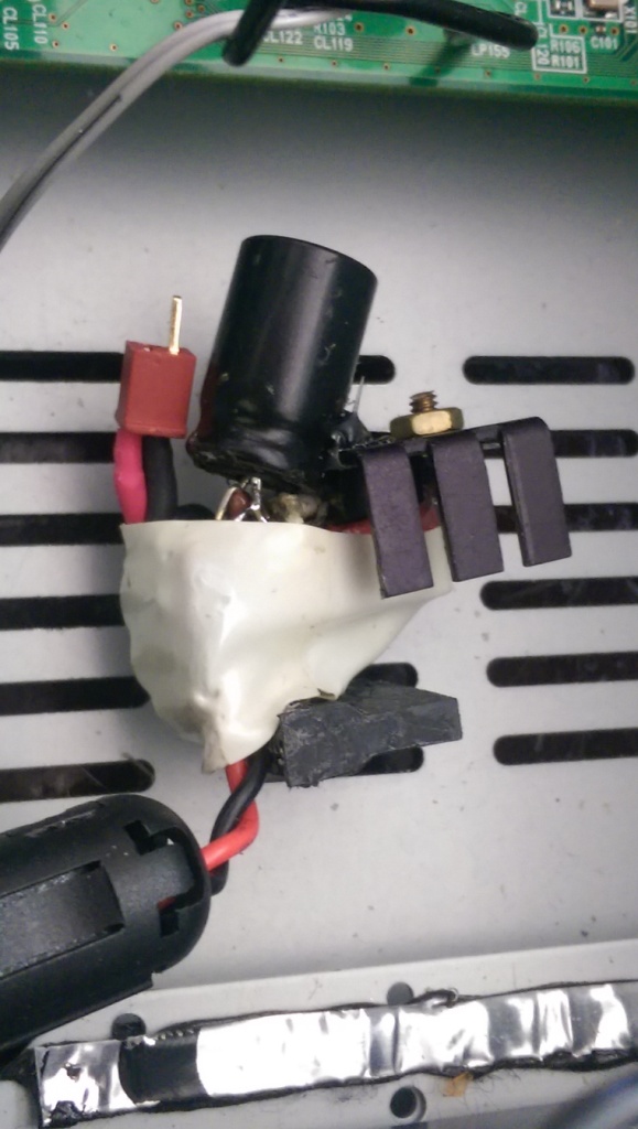

Finally a shot of my regulator mounted right on the SATA power cable.
Hopefully these are useful. Please ask questions and for more shots, but be warned I am not going to take it apart for more pictures!
Hopefully the methodology will be usable by most who want to do this. There is NO SMD soldering or removal needed (I did quite a bit of SMD work on modifying the Analog board and have more planned!). Nothing is very tight. And because your regs will be above-board, you have a lot of flexibility in placement. And finally, I've planned the cut traces such that if one wants to revert, they can scrape back the solder mask and solder-bridge across.
Greg in Mississippi
