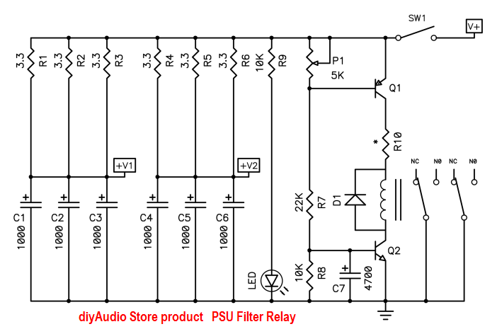

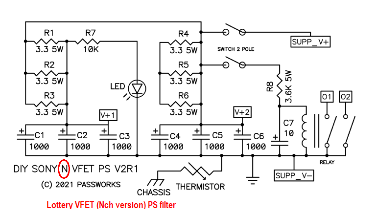

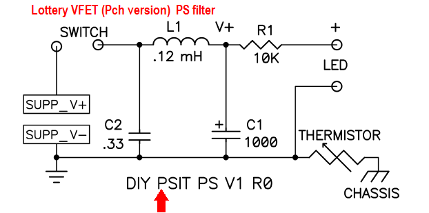

The three PSU filters that Nelson designed for VFET amplifiers, are shown below. Two of them include relays, one of them includes a big toroidal inductor, and one of them includes a trimmer potentiometer for fine tuned adjustments.
