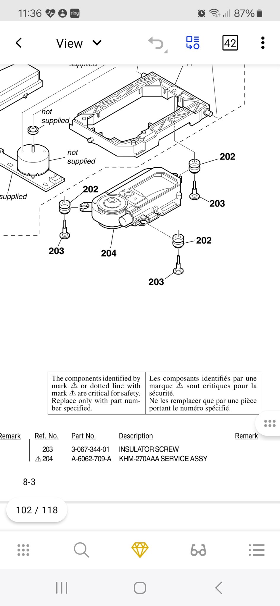

Yesterday my Sony DVP-NS930V SACD died on me. I have it since I purchased it new. It was once serviced by Sony because it would not read discs anymore (no disc). That was a costly affair of about 130 Euro. Before I put my unit back in use yesterday it has been out of service for several years because of the same problem. I was hesitant on spending the same amount of money again. Then I came across the service manual in which I discovered the Test Mode in chapter 6. I have tried the drive auto adjustment but not a lot seemed to happen. Then I tried the 6.5 drive manual operation / 5. auto adjustment / 1. Auto Track offset, whilst a CD was selected and I got a reading of 1F. I tried this because my assumption was that the laser was misaligned and could therefor not read / find the disk.
I am not 100% sure that this was the fix, but when I tried it started reading CD's and DVD's again. So I connected it to my stereo and played a CD with the violin concerto of Tchaikovsky with Boris Belkin. Unfortunately, shortly after the intro, the music died. The display showed an error (can't recall). Since then it doesn't load CD's anymore. The servo keeps seeking, but nothing shows on the display. My bet is the laser is bust. I noticed from this thread that the DVD uses a different laser so I inserted a BBC Planet Earth DVD and this was properly loaded, recognized and plays. This confirms my assumption that the CD laser is dead. From the test menu I had noticed that the CD player had only 730 hours on it, but yes, it's over 20 years old.
Now to this brilliant thread: I guess my best option is to go look for a donor unit and find a replacement laser assembly.
Two questions: 1. what is the laser assembly of a DVP-NS930V, is this also the KHM-270AAA? and 2. What are the donor units I should be looking for? Based on the looks of the machine, the NS905V/NS915V may qualify, but there are likely many more?
Thanks in advance! Jan
Solved question nr. 1: yes, the 930 uses the same optical assembly, see below snip from the service manual.
So that leaves question nr. 2: what units to look for.

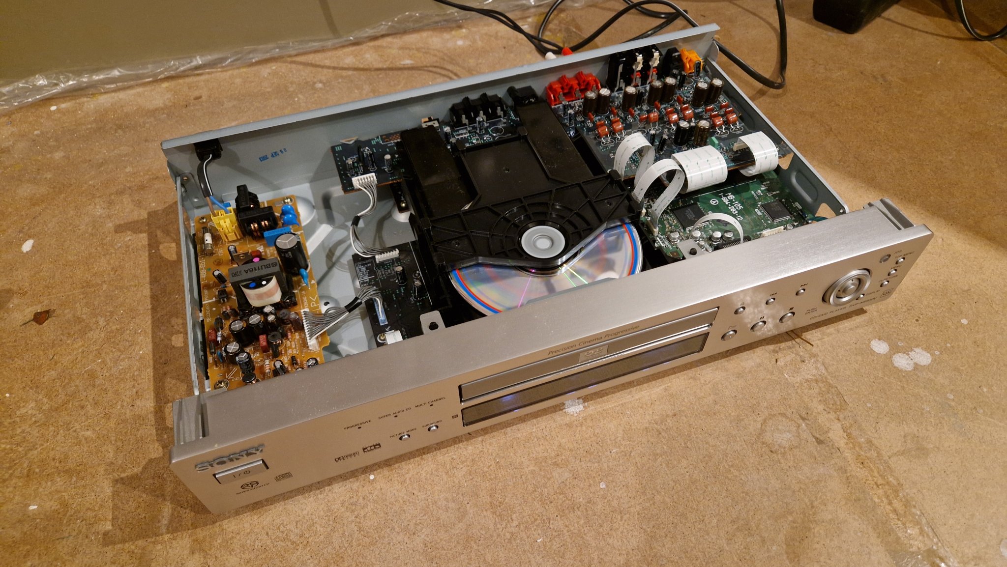

Today I performed surgery on the NS-930. I replaced the complete drive assembly of the 930 from the NS-410 donor unit. The ribbons on the 410 are a bit longer than on the 930, but I decided it was to much of a bother to change them out.
Other that that it was a quick replacement. I tested a standard CD - for that is what I use the 930 for - and it ran straight of the bat without any calibration. So this was a successful repair of my 930 for 17.5 Euro plus postage for the 140.
Thanks for putting me in the right direction.
