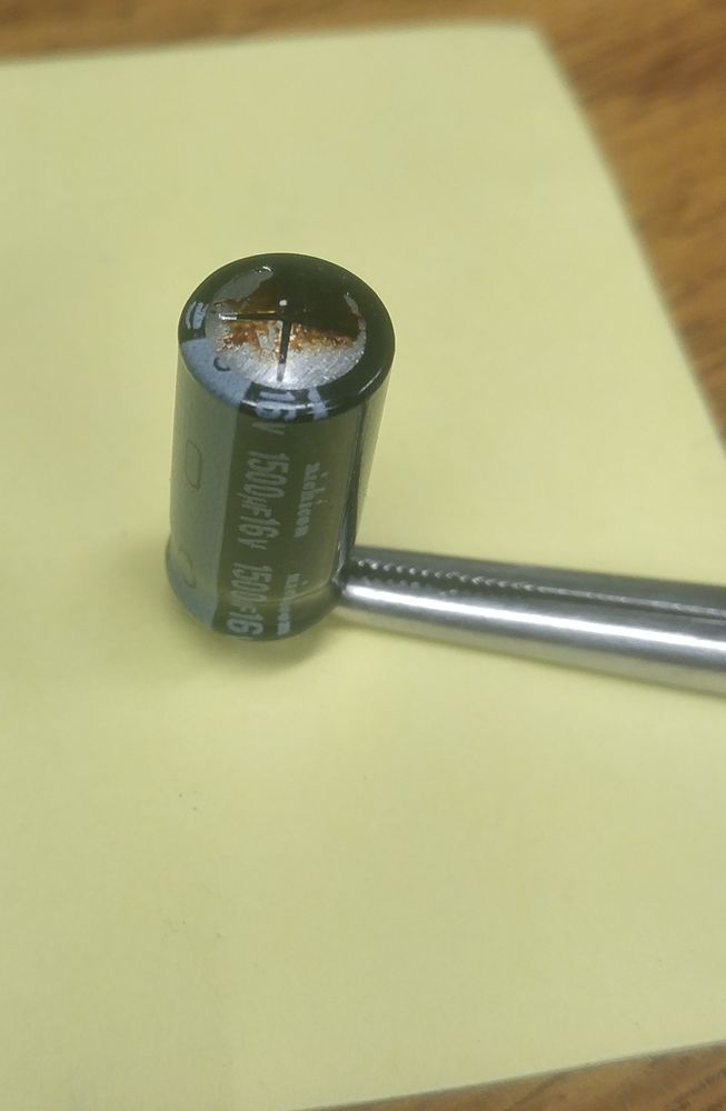

Have you or your repair technician checked all of the electrolytic capacitors in your DVP-S9000ES for high ESR?
At this age (20 years) this starts to be an issue.
I obtained a "totally dead" Sony DVP-NS999ES which had an obviously exploded electrolytic capacitor in its power supply section.
Small electrolytics, such as those on the main logic PC board, also tend to "dry out" without looking bloated or leaky.
Therefore ESR testing is a valuable tool.
I wound up replacing about 10 electrolytic capacitors in my Sony DVP-NS999ES.
I also put a different optical pickup into it, transplanted from a Sony DVP-NS715P.
It works great now.

I suggest finding a different repair technician.
It appears your technician jumped to a conclusion of “faulty optical pickup” without inspecting or checking anything else.
It’s pretty clear that electrolytic capacitors fail with age.
The generic “$10 transistor tester” devices widely sold on eBay and alibaba can also test capacitors for both uF and ESR.
For items like CD players the ESR of the electrolytic capacitor is the critical item.
Tiny electrolytic capacitors contain only a few milligrams of electrolyte solution. If that evaporates or leaks out then the capacitor becomes an open circuit.
Also, there was a worldwide “pandemic” of electrolytic capacitor failures between 1999 and 2006. This occurred because one of the major vendors of the electrolyte paste used by every capacitor manufacturer messed up their recipe for a couple of years. Because of that electronic products manufactured during those years 1998-2006 have a 2-3 times higher rate of faulty electrolytic capacitors than items manufactured earlier or later.
I routinely check the ESR of every electrolytic during restoration of older items. I think everyone who considers themselves “skilled” at repairing vintage audio gear should learn to suspect electrolytic capacitors and be prepared to test their ESR and replace them when needed.
Please note that it isn’t often necessary to replace every electrolytic capacitor. If the uF and ESR both measure within spec then an old capacitor can still be used.
As for your DVP-S9000ES, I recommend checking the ESR of every electrolytic on its power supply PC board and additionally checking ESR of all tiny surface—mount electrolytics located on the main logic PC boards.
-EB

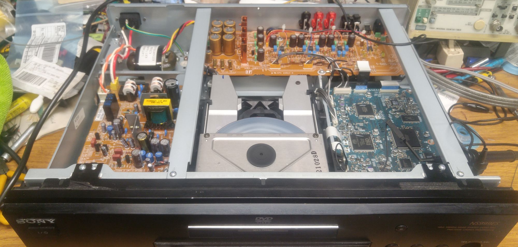

The optical pickups in these Sony DVP players contain two laser diodes:I never had the SACD/CD identification problem and it still plays fine on Audio discs.
My problem is on DVD play.
The visible red laser diode is used for playing DVD & SACD discs.
The infrared laser is used for playing CD discs.
Only one laser is switched on for any given disc.
It seems your machine got totally locked up that time. A faulty optical pickup rarely causes that. More likely there is an electronic fault on the main logic board or perhaps a power supply fault. The most common symptom of a faulty optical pickup is that the machine fails to detect, initialize, or play one or more variety of disc. It might still play every CD perfectly, but fail to play any DVD or SACD.Last summer, I tried to play once a DVD-R and it didn't play. It did not came as a surprise, since DVD-R playing on this machine is hit and miss, and no big deal after all, but I just try it sometimes. But that time was particular, because instead of the usual error message, it blocked every function of the player and I couldn't even eject it! So I switched it off then on and fortunately could eject it later.
However a faulty optical pickup should not cause a complete lock-up of the machine.
Faults that happen intermittently are more likely caused by electronic problems rather than by worn out optical pickups.Everything seemed fine again for a few hours of use but one day I started having distortion and pixelation and mosaic-like patterns on pictures (looked like bad DVB transmission) with otherwise pristine DVDs. It started moderately first, very randomly too, and not necessarily affecting every playing session, but as time went by, became more prevalent and aggressive on the screen and on every session. I tried the auto-calibration procedure one to three times and the problem completely disappeared!
It is often possible to obtain a working optical pickup from a low-end DVD player model which used the same optical pickup. I have done this many times with models in the more recent Sony DVP-NS series. The DVP-S series is a couple of years older. It is likely that the optical pickup from a low-end DVP-S machine will be compatible with your DVP-S9000ES.So I brought my DVP-S9000ES to my local technician, and he ordered the optical pickup replacement but he was told it was discontinued.
The calibration procedures are similar for all Sony DVD players of similar vintage, regardless of whether it is a high-end or low-end model. Perhaps the service technician was unfamiliar with every Sony DVD player of similar age?My technician had never seen or worked before on this unit, so he was obviously unaware of its service tricks and was impressed by the quality of the inside mechanics.
Did you perform the auto-calibrate procedure using a DVD-R or CD-R?I suspect my failed DVD-R attempt was the culprit and did some damage or misalignment to the laser.!
If so this could incorrectly change some of the internal servo parameters which are stored in EEPROM. However this cannot permanently damage the machine or the optical pickup.
These machines do have a service menu function to “restore EEPROM to factory default.” After doing that the calibration can be performed again.
There is one section of the calibration which is best performed manually and I prefer to do this before attempting any of the “auto calibrate” procedures.
The Sony service manual refers to this as ”disc check memory” or as “mirror time adjustment.” This procedure requires only 2 discs:

Circling back to this project for a quick checkup. I had time to pop the lid off of my S9000 to visually inspect all capacitors for signs of trouble. Everything looks good, save for just three caps that look ever so slightly unhappy. They are, as expected, part of the standby/power switch board AC-113. I confirmed their specs with the service manual, so will add those into yet another Mouser order.
I don't currently have a way to check ESR on the caps yet but have earmarked a few bucks to consider getting an ESR meter.
Otherwise, I was so surprised to see all the rest of the caps in excellent condition, and was also surprised at how many Rubycon, Nichicon Fine Gold and Nichicon Gold Tune caps were inside. Oh my.
