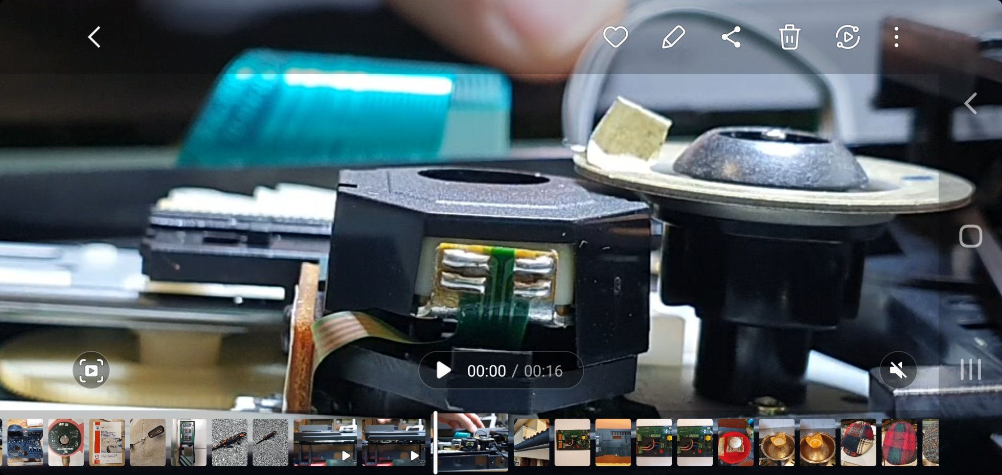

My next step would be to at the RF when it spins up and see where the amplitude is at. It will probably look blurry because of no tracking lock but the overall amplitude would be a good guide.

You haven't listened to me. I said early on you need to get the correct table height. You have been told it is a critical adjustment. You did move it, you have not measured another in order to set it correctly. Therefore step #1 is to put the darned table back exactly where it needs to be. We already know this isn't correct yet. So why on earth would you continue knowing this has to be set correctly first?
The next step is to observe the eye pattern - after you have the correct height. If the focus is off, the eye pattern will not be at full height, we know this.

Hi anatech,
I'm sorry I made you angry. But I haven't other machines with the same laser, so I cannot make any measure of height and therefore I cannot get the correct height. Also searching on e web. This is the reason that I didn't listen to you :-( The other way is wait, searching on the web, maybe to find that data. Or throw my machine in the bin :-( :-(

I have been looking for a machine I can measure to get the height. In service, we don't do it that way (we use jigs). Anyway, if I can find it I will let you know. Anyone with the same transport can measure this for us as well. So the KSS-240A and KSS-210A/150A head transports are the exact same distance. Probably the KSS-213A also, but I can't be sure.
So let's just put it out there. Anyone with these heads in a CD player, can you measure between the top of the turntable to the chassis where the motor is screwed to in mm? If a few can measure this we can get an accurate idea instead of depending on one person who may get their caliper on an angle.
You absolutely need this first before you do anything. Once we have this done we can get somewhere.

Hi Andrea,
I'm a working tech, I don't have time to play with pictures. But I have told you more than once.
From the top of the turntable to the top of the metal plate supporting the disc (spindle) motor. Simple.

This was also my procedure when the disc motor (spindle motor) was replaced beforehand.Find another CD player with a KSS-240A, KSS-150A or KSS-210A head in it. Carefully measure the distance between the top of the disc table and top surface of the CDM. Use calipers or something accurate. Set yours to the same exact distance.
That is your starting point. Don't do anything else until you have it set correctly, and I mean nothing!!!
To find the right position of the motor pulley for the exact height, I always chose the point where the collimator lens in the laser unit no longer changed its position when the cd player was switched off during playback.
The prerequisite for this is a disc that is so full that the lens can be clearly seen from above during the last seconds of playback and the disc doesn't show any vertical runout (this can be recognized by the fact that a pronounced up and down movement of the lens can be observed).
If a turntable resp. pulley is in use with a grub screw instead of a pressed version simplifies the height adjustment considerably.
Unfortunately, this is usually not the case.
Measure the top of the table to the surface of the mech. The lens will sag slightly when unpowered. Do not get creative, do it the way the service manual recommends.

@elpossa It appears from your video od the PU lens attempt to focus that it won't sweep all the way through its focus range. There is no outward travel of the lens, which is why it wouldn't start spinning the disc. The focus offset is likely the issue and possibly the servo output to the focus coil. It may be a bad servo drive transistor or the coupling capacitor / feedback loop. Also advise to check the spindle height, but the focus issue would be independent of this and improper spindle height would usually result in intermittent skipping at the end of the focus range. This can be masked by the lack of focus travel range.
You're supposed to use an oscilloscope to monitor the focus drive. You'll see the focus search range, DC coupling on the 'scope.
There are no coupling capacitors in focus or tracking servos. They have to respond at DC. Some focus servos run with an offset of about +100 mV, depends on machine and head.
