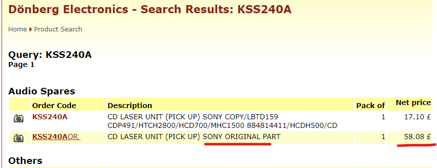

Is possible to buy anywhere a good replacement for my KSS240A ? Seems that the 10/15€ ones found on the web are fake ... is it true ?
@Mooly I've read your posts at the top of this thread, and I was hopeful to resuscitate my cd player in the same way ...
Fake is maybe the wrong word, they are non Sony replacements and should not be advertised as such. So I suppose 'fake' in that sense. The original Sony's went out of production a decades or more ago as far as I recall. I haven't fitted one in many many years now and wouldn't like to say what the current state of play is with replacements.
Having said that Donberg claim to have originals at a price of course.
https://www.donberg.co.uk/descript/k/kss_240a.htm

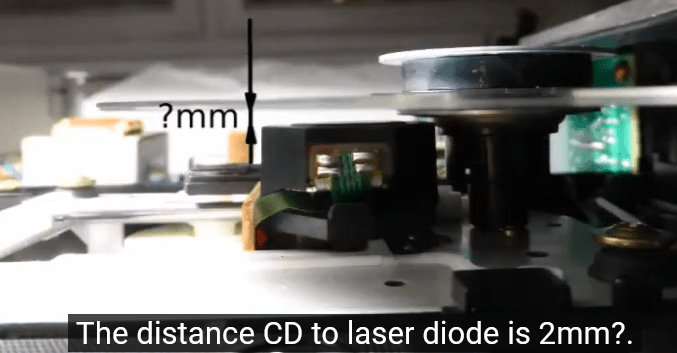

Ops... I found another mistake...
Months ago, the first time spindle motor won't start, I desoldered it to replace. but it wasn't the problem :-( so I re-placed the same old spindle motor.
Now, reading other infos on web (and thinking more...) I saw that the distance CD to laser have to be 2mm: is the same for all CD player?
Hi elpossa,
That distance is critical. I have always cautioned people when messing with that.
They normally have a jig to the base of the turntable to the transport surface, or a jig to the bottom of the turntable. The lens to turntable top surface (bottom of the CD) will be the same for everything using that head. Normally they don't measure it that way (but it would make sense).
If this is wrong it will cause what you are seeing, and other issues. This is a critical adjustment.

@Mooly @anatech I've tried to put a (piece if) cd took by hand above the lens... and the spindle motor start to run !
So (I think) motor is ok and laser isn't broken.
But seems that the cd support on spindle motor is too high. On my video, played 0.5x speed, the spindle motor runs when the cd is a little bit under the support. but the support is on the lower position as possible (touching the metal structure of cd mechanism).
So I think: where is the problem?
It is possible to focus the CD a little bit far by turning the trimmers? Or the problem is that the lens can't go out enough? Mooly said on #364 'The starting point looks very low as if the suspension has sagged'. Could be this the problem?
If you need I can attach the video of my test.

Hi Andrea,
Find the correct mechanical height by measuring a similar machine. This isn't like any other mechanical device. The focus must be bang on to take into account CDs with varying focal distances, and warps. It is a critical measurement.
We were issued or had to buy precise brass gauge blocks to adjust machines where you could remove the disc table. These were better than 0.1 mm tolerance. Some machines had plastic guides you could snap out (early Pioneer machines). In any event, table height was not intended to be set via trial and error. Depending on the machine you could measure the focus offset, but this may also be an electrical adjustment as well. You have to understand the machine and alignment procedure.
If the machine was in front of me on my bench I could probably get it set properly. I would either recognise the transport and select the proper gage, or have another I could use my calipers to measure. I can't do anything remotely.

now my spindle motor runs putting a cd 🙂
But does not recognize the cd :-(
I filed the base of the CD support, the side opponent of the CD. So the CD is nearest to the lens and the focus (seems) to be ok.
Unfortunally I don't have a working scope now. Maybe I have one next week.
Which is the next step(s) to do for me? What do you suggest?
PS: It's very strange that I had to bring the CD closer to the lens.

Andrea, the distance is very critical. If you are out of lock range it will not read the CD. You cannot do this properly by trial and error. Period.
Find another machine that no one has messed with and measure that distance, set yours exactly the same.
You are not using logic or following good advice. I'm out of here.
