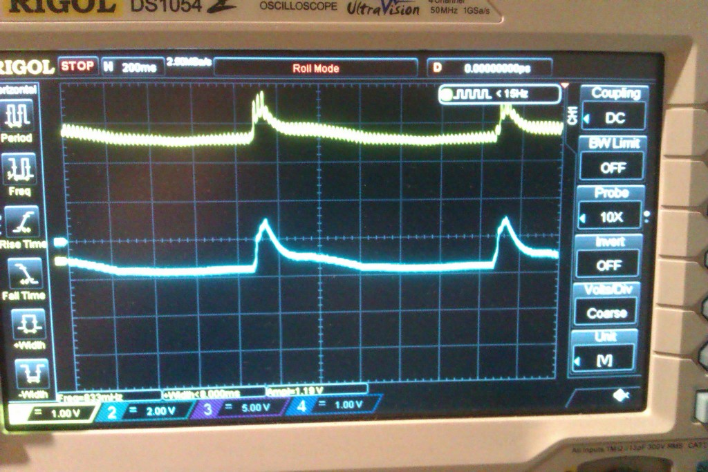

I managed to fit some lead wires on the optic unit itself, in order to see some signals that might be of interest. The first is the LDON signal (First picture) This looks like it's happily going about it's business, and it is ON when powering the CD player on, when inserting disk....it looks OK. Note that the LDON signal is the yellow trace, while the blue trace is the -2V line.

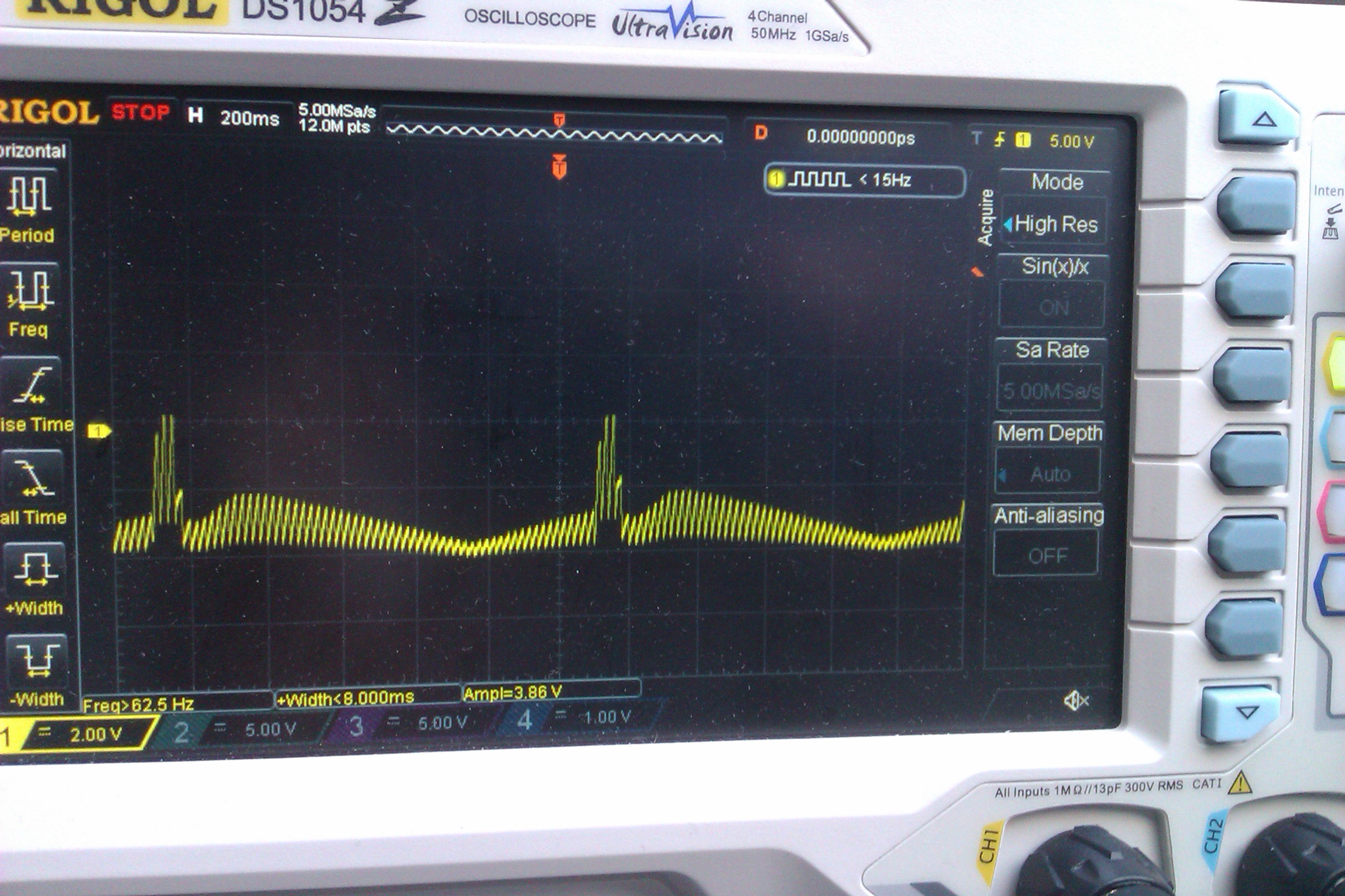

The second signal is Pin 25 on IC 102 (Second picture, yellow trace) and this looks like it's following the click that I hear, also visible in the -2V line (the blue trace) as rising peaks. The signal is the output from the comparator for the SRDR and SFDR signals.

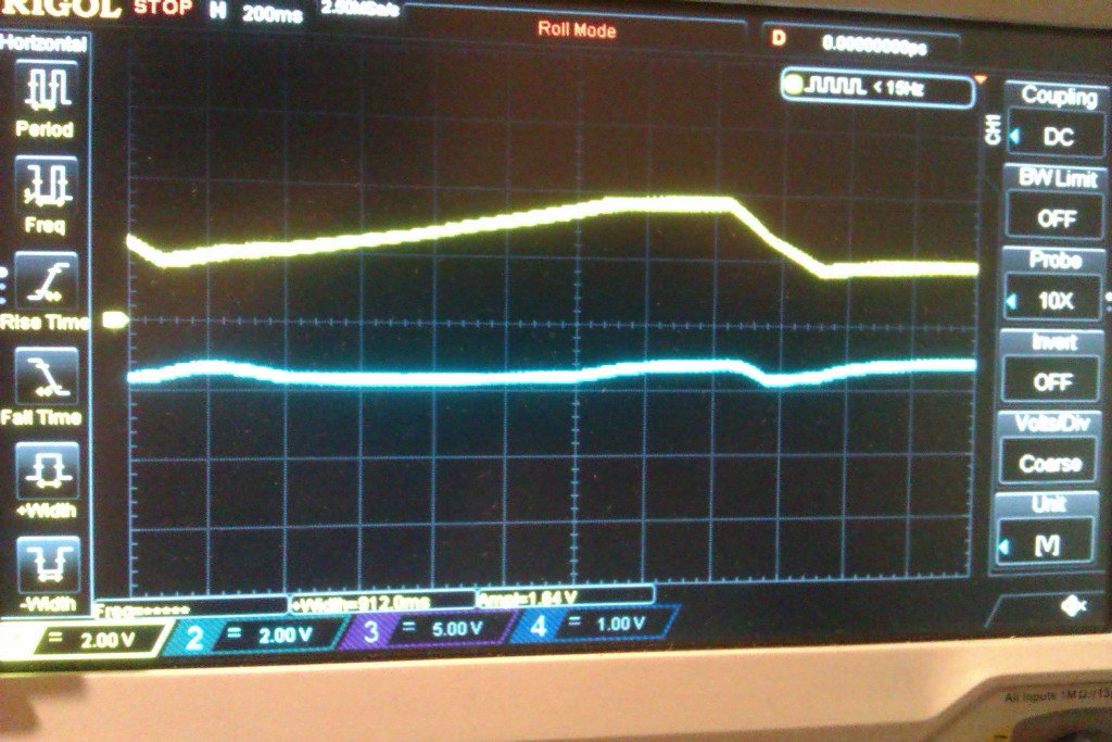

The third signal is Pin 11 on IC 102 (Fourth pic), basically what would be the signal from the feedback coil. Now this looks kind of promising....there's a nice ramp, and at some point, the signal falls abruptly (for about 70-80 ms), the comes back, and so on, this also coinciding with the rises in the VEE line. This signal comes straight from the Digital Servo, IC 101, so my guess is that this wouldn't have any reason to behave like that, would it ?

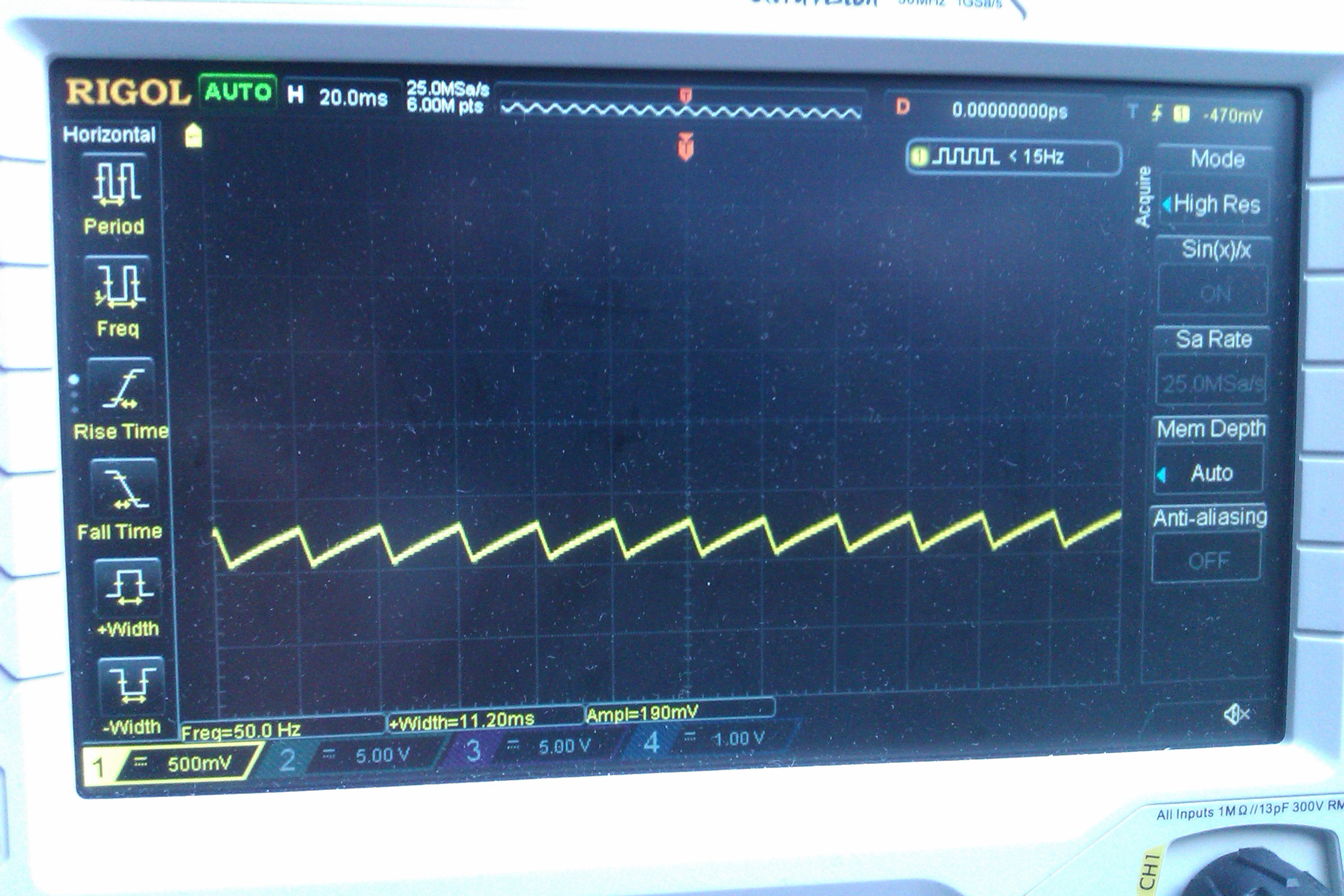

Also, I scoped the same line when the CD player is turned on (last picture) and it moves the lenses, to figure out if there already is any CD inside, and, with no disk inside, I see a nice ramp, so it's hard to believe that IC 102 is at fault here.....

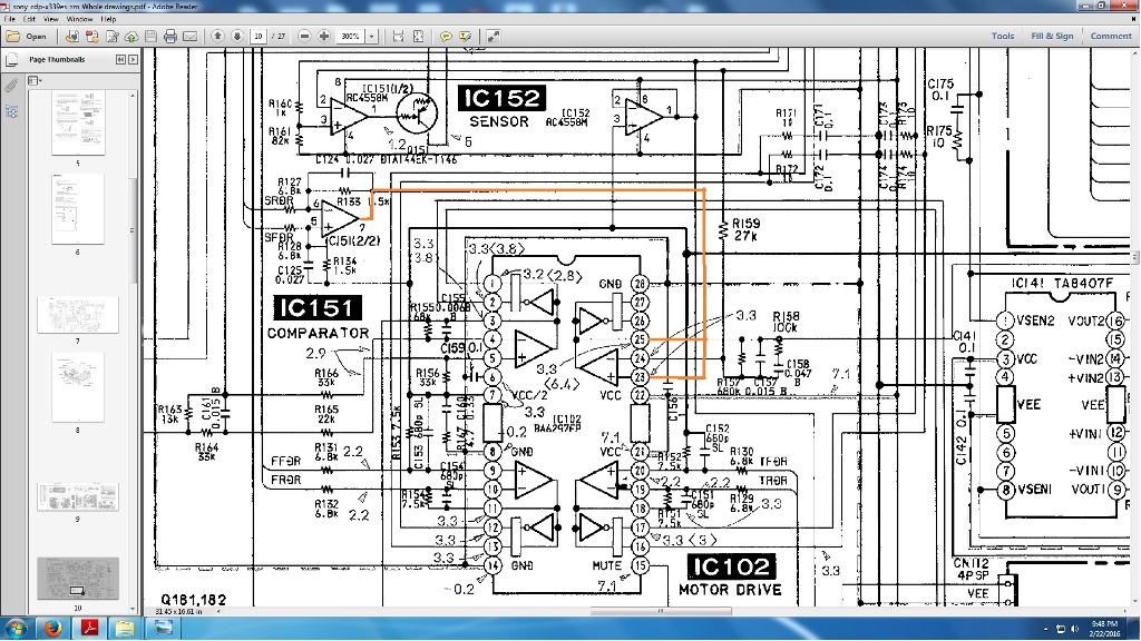

Maybe some of the comparators, IC 151, IC 152 are causing this. Or maybe there's something actually going on to the digital servo controller (bad caps, resistors...) ?
