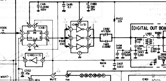

My problem is with the +5 V regulator.... It overheats:hot:and it seems I could relieve the power by cutting the supply to digital out...
R306 : digital data input
Bar on top is : +5 V
Pin: 10,11 of ic480 + on/off switch , + the pin 7 of the digital filter MUTE is the MUTE circuit...
How do i disable the digital supply without muting the digital ??

Gabdx1 said:
Hi, thanks for answer :)
I already disabled headphone supply and inputs : no difference in sound ..
That's interesting. In my case, it realy "relaxed" the sound signature, the ocaisonal harshness in female vocals had gone, also midbass "hump" was no more. I simply disconnected the signal and ps cable of the headphone out pcb.

Let's first see if we are talking about the same player :)
My player is a CDP-222ESD, and I don't have anything simular to the attached pic in my service manual? :xeye:
What were the symptoms when you disconnected the power supply from the IC480?
From what I can see on the dagram, only 2/3 of IC480 are shown, what does the last third do?
Have you tried disconnecting the pin 7 of the digital filter from the IC480, and seting it low?
Cheers!
Hi, I think most sony are the same... mine is 610esd
Your ESD = digital out , you should have the same circuit somewhere , maybe its different
Pin 7 of the digital filter is 0 when the digital out is off.. there is no power there required at all
When you turn on digital output it sends 2 V ( not 4.8 like in the shematic) to pin 7 wich turn the Digital filter off so there is no ouput to dac.
Disabling digital out is a good idea because if you touch to the regulator of 5 V close to the tda, its very hot and wastes lots of power on the digital out even when it is at off. :snare:
I don't know how the inverters work very much, so I need advice of an electronician...
What i understand is that the pin 10 IC480 must produce around 5 V so the muting logical circuit is never activated.....
So I can't cut all power to the IC480, at least it should get power on pin 10 , can also cut the pin 10 fromt he IC480...
I don't want to send to much amps also...
Last problem is the IC481... Pin 3 goes to the digital filter... with 2.4 V SCK ... i have no idea if it would work again when power to ic481 is cut off.
Correct this if its wrong :att'n: :
1. SCK = digital out... --- goes to digital filter directly , ( I bypass the IC481 Pin 2 is linked to pin 3)
2. The pin 10 of Ic480 is cut and linked with pin 9 and goes to the 5V source = logital gates will prevent muting.
Pin 9 of IC480 is another inverter, the last 1/3 of the IC

Gabdx1 said:
Damn ... I disconnected to supply 5 V to the pin 14 of the inverter IC480... sony just wont power up since
I reconnected everything and the motor wont start...
All voltages seems normal...
What the....:bawling:
