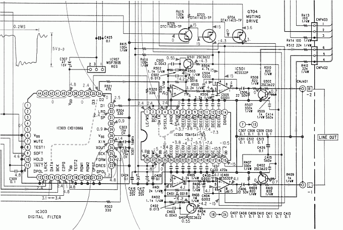

tvi said:From the CDP222ESD/505ESD/910 service Manual
Regards
James
Hi, sorry to bother you, but is there a possibility for you to send me the service manual, or point me to it on the web?
Also, do you have an better picture of the shematic?

For a start I would replace C506 & C406 with at least 47uF 50v Nichicon Muse or Black Gates or Elna Silmic.
This should give a deeper more controlled bass responce
Chris🙂

hi scorpio , you should try a I/V conversion with a simple resistor of 100 ohms tapped between iout of 1541 and ground .After that you hook a wire and a coupling cap(8 uF) between pinout and RCA plug , that's all .No need of pos-filtering since there is O/S .
Try it and say us how you feel . Thee only drawback is that you
got to loss some level , you would have around 400mV instead of
2 V , but i think it's sufficient .Ah , don't forget to cut the path to the analogue stage .(generally there is a serie resistor between the DAC and the first opamp).Now you have almost the same implementation than a10.000 euros Wadia 2000 .Enjoy !

Re: 222ESD mod
Not only will you loose level,you will also loose drive and your CD player will now be extremely sensitiive to the kind of load presented by the cable and downstream kit.
And you will have nothing remotely comparable, technically speaking, to a Wadia.

222es IV out mod
Another down'r of doing an IV mode on this setup is that you would loose de'emphasis on discs that require it (dont know how many disks are actualy recorded with de,emph though).

OK, thx, will try this. Sorry to ask, but what kind of capacitor should I use? 😕
Will an simple pulling of the opamps out of their sockets do the trick for "loosing the analogue stage", or I'll need to desolder an resistor?
Can you point me to the name of this procedure, so I can do a search and see all pros and cons, rather than bothering you all to write your thoughts on it again?
I would also replace C416 & C417 with 470uf 25v or more Nichicon Muse
Chris 🙂
