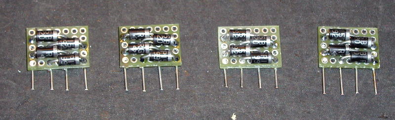

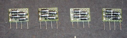

I must gladly report that the original bridges that Sony used are actually quite good and they do not need to be replaced.
When I was modding ML37 and BiDAT I replaced stock rectifiers with custom made bridges using RGP 15B diodes with very good results. I first noticed those diodes im ML31.5 and they worked there very well, and were actually better than MSR860 I'm using in my NOS DAC.
So I made such custom bridges also for Sony, but unfortunately the results were less spectacular: somehow I got less air and dimentionality. Today, I put back the original parts and again, I started perceiving familiar signature: nice resolution in highs, improved bass, dimentionality and air, that I quite liked in that player after recent mods. So Sony bridges stay. I replaced the other 4 diodes (in analog section) with MUR860 (not parallel as originally) and I didn't notice any major improvement nor degradation.
With regards to output series resistors, I didn't like 244R Vishays S102 there. I placed 33R Rikens in that place though and I think it is better than without any resistors.
Diode bridges
Peter,
Prior to converting the CDP to batteries, I installed four custom low-current diode bridges made up by Reference Audio Mods in the USA and noted a major improvement in bass articulation, dynamics and pretty much all other metrics. However, I found little improvement when replacing the stock Sony high-current rectifiers powering the +/-16V supply to the Audio Board. Further improvements were obtained replacing the stock reservoir caps with 4-pole Jensen and the stock filtering caps with inexpensive Rubycon ZA and ZL.
Dave
I tried few times Rubycons, but somehow I was never impressed much by them. I like to use BG N in digital circuits and if those won't be better than Silmics, I will leave the Silmics in place. I am a bit reluctant to touch capacitors yet, as Sony "house signature" is quite acceptable.
And I've listen to audiophile "approved" diodes before, but it was usually pushing the envelope too much for my taste 😉
I am not sure why Sony uses diodes in parallel in audio section. From my experience, things in parallel ususally don't work as good as single.
I will be also disconnecting from PS all the unused sections of output stage soon and this should bring some improvement as well.
