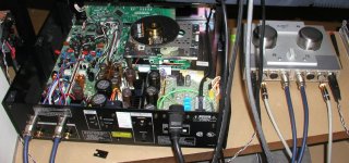

CN705 and to a lesser degree CN706 on the Main Board is where most of my troubles occurred. By rails I mean the pins inside the header are bent 90 degrees & come out over the PCB pads where the solder joints are made. I was surprised how SACD skipping and intermittent read problems were resolved after cleaning up these joints with solder removal braid, then resoldering them while downward pressure was applied to the pin with a small screwdriver.

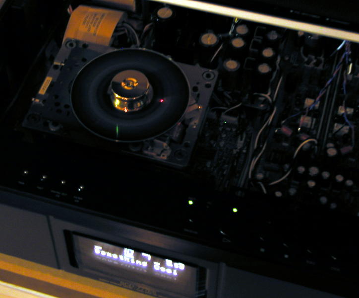

David Garretson said:Are we certain that SACD laser light is visible to the naked eye?
It is certainly visible, pretty strong actually.
I made my first "upgrade" today. I run output wires directly from I/V op amps (I replaced them with LM6172) and installed a set of XLR connectors in the rear panel. The output is connected (through BG N 10/50 coupling caps) to S&B TX102 transformers in balanced to single ended mode. Works fine.
BTW, I'm pretty much impressed with the effort Sony put into building that player. While I also have ML37, ML31.5 and CEC TL0, the Sony unit doesn't come short in build quality to any of those other transports.

Laser Light
Peter,
When I posted about the laser light I had not yet figured out how to defeat and remove the top cover while spinning disks. You shouldn't need the coupling caps with the traffos & it must sound better without them.
