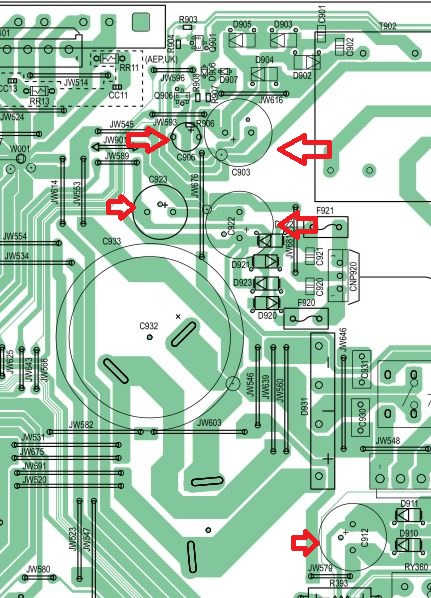

The unit is a Sony Stereo STR-DA1500ES 2-Channel Audio Receiver (2009/2010 model). This is a 2x100W+ RMS amp.
Now, I get the well known "Protect" mode message. Trying to fix it I referred to a pro. There is no patience to "discover" the real cause of this amp and I have been told to not bother fixing it. So, considering this thing "dead", I have decided to learn some basics to test it myself (very basic following of web instructions and a multimeter).
So here are...
The facts:
🙁 Speakers and headphones receives a noise signal that increases for some seconds (loud enough) until the protect mode circuit activates and shuts it down. It has the same behavior in headphones even if the volume is @ -oo.
When you use the volume control (it is digital I guess) there is a continuous loud clicking sound, like tik-tik-tik ....
This behavior started when I switched off by mistake the UPS instead of the unit. After this, it played ok for about a week and then, has been locked in the protection mode.
I had the unit disassembled easily, there is some basic pc hardware based experience.

final and correct measurement
Thank you Sakis for your quick and informative response on such a misleading topic. First of all excuse my ignorance, as I am not an expert, it seems I could not filter web info about it
e.g. this video: https://www.youtube.com/watch?v=OEmxfNzTnsQ
but this is the success of this forum also 😱. there could be some luck to others also by estimating right this test for a case like this.
UPS is just for safety reasons because I use a notebook/soundcard alongside with the amp that plays only music. I thought it is best to plug everything there. As a mutter of fact I have less radio FM interference using the ups (if I use the pc, the amp has nothing to do with it).
I will find the transistors and replace all of them. Before this...
do you think I can do this measurement you refer to? Can you be more specific when you say "at the middle point of the dual resistors" Do you mean to measure between the middle pins of each couple? (I can see that they work as couples @ each channel)
Protection mode shuts down the unit @ about 10 seconds, do I have to see the measurement before the protection event when the unit is on, am I right? Or there is some kind of voltage leak that is happening to standby also?

You should find that all clues will be in the voltage measurements. Checking the DC offset of each channel is the basic starting point.
As you can see those are terms that are new to me.
With instructions from:
Amplifier Distortion, DC-Offset, and You! | Audiokarma Home Audio Stereo Discussion Forums
1. Speakers disconnected (or connect the meter to the 'B' speakers and set the front panel speaker control accordingly)
2. Input set to an unusued position (not Phono)
3. Volume control at minimum.
4. Balance in center
5. Tone controls either defeated or set to mid position
6. Set your meter to read DC, and set to a low scale (300mV scale is common) Connect directly to the Pos and Neg of the speaker terminals
7. Give the amp 10 minutes to settle. Report back...I'd like to see how healthy all these old amps are.
Both outputs measurement, starting from 0 with a progressive increase to 100mV, then the protector kicks in.
Both R and L same behavior, I guess this is the voltage value of the increasing noise phenomenon in the headphones/speakers.
A proud finding or what?😉

Yes, a finding 🙂
If you are measuring at the speaker terminals then you are measuring the DC up to the point the relay trips out. If you measure the voltage before the relay then you would see it rise further.
This fault sounds a little more obscure tbh. DC offset issues are usually 'hard' faults... hard as in a total failure causing a massive offset instantaneously, and only on one channel (the failed one). DC offset is also silent, it simple pushes the speaker cone out.
Both channels producing a 'noise' suggests something very different and not a failure in the output stages. I'm wondering if this is more deep seated, something much further toward the front end where all the signal processing and so on is done.
Ideally an oscilloscope would be used to see what is going on. I suppose there is a possibility it could be a voltage rail problem somewhere, again that's 'scope territory to quickly check that the rails are clean.

Ok, very useful. The dc-offset/noise is a stereo effect. Both R+L is exactly the same (headphones test).
No visual fails/leaks etc. But as yesterday I had started measurements of resistors and capacitors, all resistors I had access, checked and they seemed good.
Some capacitors though, had a strange behavior.
They had some voltage and resistance but they seem not to discharge the value I get. I'm not sure though because this is the first time I test a capacitor.
The big ones (10000μF 71V) for example discharge OK. This is what I have done: I have measured the resistance and then I've checked the voltage. But some of them do not discharge as others, and I thought that they are some kind of slow discharge components.
![2016-05-11 23_05_07-sony_str-da1500es_ver-1.0_sm.pdf - [00_01-04_STRDA1500_02.indd].jpg 2016-05-11 23_05_07-sony_str-da1500es_ver-1.0_sm.pdf - [00_01-04_STRDA1500_02.indd].jpg](https://www.diyaudio.com/community/data/attachments/511/511817-11a8b74899882c5b20a75621d2a9ae79.jpg?hash=Eai3SJmILF)
Attachment shows the possible capacitors with this behavior.
2x nichicon 3300μF 16v
1x 2200μF 25v
1x 1000uF 25v
At least one of those behaved as like not discharging, but no visual fail artifacts. I hope this is not a misleading information as I have to reconfirm.
1x 2200μF 25v
1x 1000uF 25v
