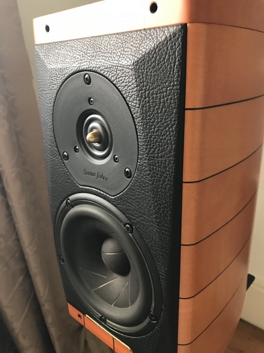

Dear DIYers,
I need your help with my SF Cremona Auditor.
One of the Woofers is broken and I am struggling to find a replacement.
I search in the web but nothing show up.
Maybe someone have a spare or can identify a proper substitute?
Thanks in advance...
Enrico

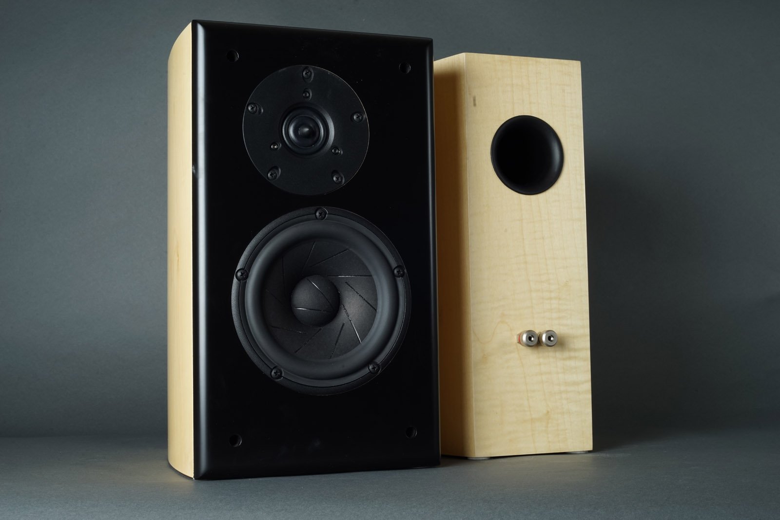

I think they are woofers made by Scan Speak, possibly with some modification requested by Sonus Faber, the magnet seems reinforced. Troels Gravesen made a similar construction. I think you have to go to SF, or replace the two woofers of the two cabinets. In the first case, you will probably have a higher expense but the security of the correct speaker. In the second case, you may be able to save some money, but I don't think the TS parameters are the same.
https://www.scan-speak.dk/technical/diy/
http://www.troelsgravesen.dk/Revelator-4R.htm

It’s probably a pretty stock 15W8530G or 15W8531G with magnetic shield for CRT tv sets. Of course SF wants to let us believe it’s proprietary, but fact is the DIY units are quite optimal implementations. If you don’t care about restoring the SF 100 percent, get the Revelators.
Btw, did the litze wires come loose (known issue) or is there another defect?
Thanks Mark, actually I don't care too much to be SF 100%, what I care is that the speaker remain with the same sound.
I give a look to the speaker and gently I pull the wire to see if they are loose where join the cone but seems all good.
It's sure the coil because with the ohmmeter measure Mohm but I can't see anything wrong in the connections.

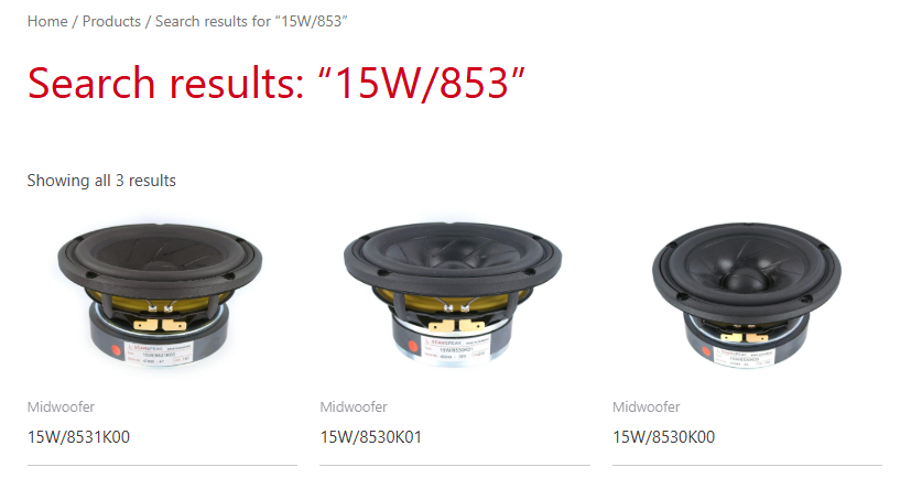

I just checked in the Scan Speak website and there are 3 Revelators available but not the ones you mention
I give few days to SF support to reply to my email.
If as I suspect nothing will happen I will try to get one of the 3 above from Scan Speak.

In the Scan Speak website only the 15W/4531G00 are available, so 4 ohm are only un-coated.
[Edit] It’s likely that you need the 4Ω version. The 15W4531G is a good replacement, the only one available for DIY. In fact, Scan offered a shielded version in the past too. Resembles your SF version 😉
