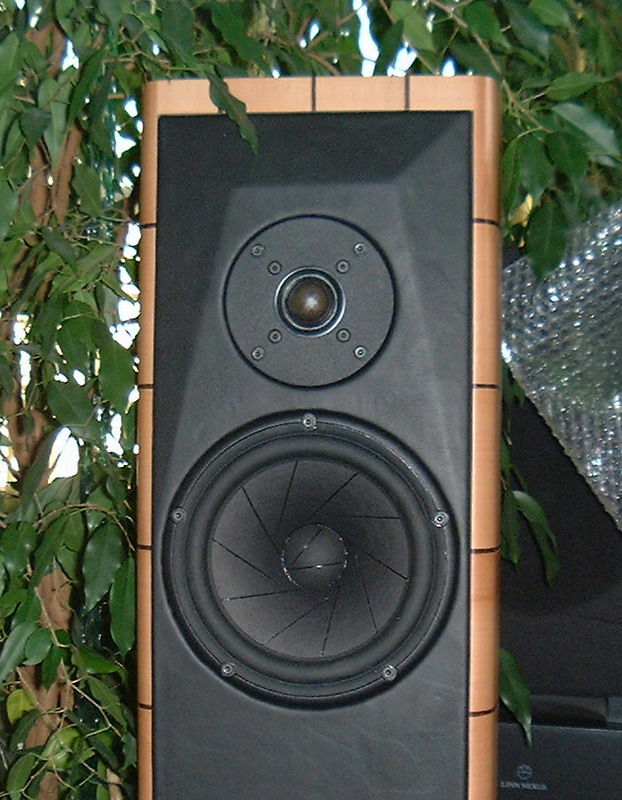

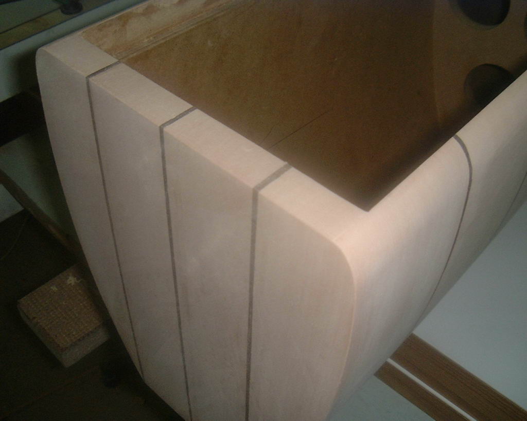

Someware along the line I lost the interest (read as FUNDS!!!) to build a sonus faber clone. However, in a recent article in audioXpress (about Zero impedance transformers) there was the picture of the bottom corner of a loverly curve-sided speaker with flat front and rear baffles. Since I still had some 6mm ply I decided to make some.

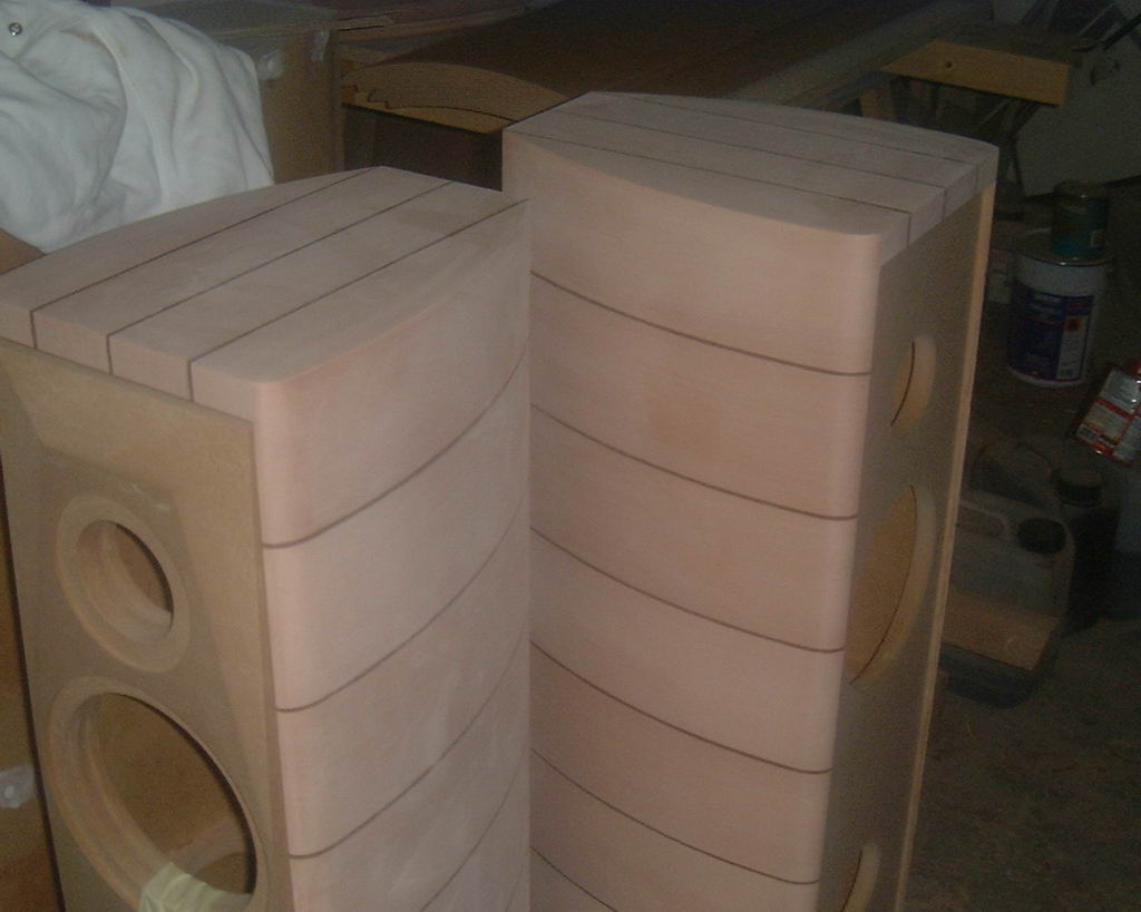

The method I used to bend the wood produced excellent results and fast. I got a fence post (of about 100mm diameter) and laminated 2 sets of two layers of 6mm ply. With these two sheets, I put one of either side of the post and clamped their sides together. After about four hours, I checked them again and had the perfect contour.
I'll trim them next weekend and start with the baffles.

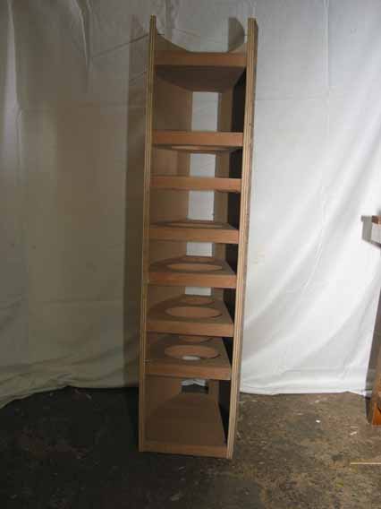

I have used teh technique you have described. Since I posses the worst wood working skills of anyone on this forum i had to keep things very very simple.
1. build a simble frame for 1 side of teh speaker (the other side is a mirror image) I did this with a free hand drawing on paper of the cruve then followed that drawing to make the same curve on 3/4" ply. made 3 such plys. laid the 3 plys parallel to each other (24" apart) and lay a thin 4mm ply on top of the 3 3/4" cruved plys.
2. once this is done I took a 4'x8' sheet of 4mm ply and 1 4x8 sheet of 3mm MDF. cut each sheet into 6 pieces of 4'x16" (my speaker was 4' tall x16" deep)
now I had 12 sheets of ply and 12 sheets of MDF enough of one speaker. no wastage.
alternately lay one sheet of ply then MDF them ply then MDF etc... on the curved form created in "1".
3. I found 3 x 3mm MDF + 3 x 4mm ply to be strong enough
this makes 1 side.
since a 4' speaker is pretty tall and a tweeter or woofer at that height is not at ear level I sectioned the cabinet into 3 parts.
1. top 5" for crossover
2. middle 12" for 6" 2way woofer above tweeter
3. bottom 30" for 8" woofer used for difraction step.
Dave (planet 10) might have pics of cabinet without baffle so you can see details.
