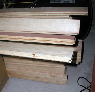

Hello Mezzo,
That is beautiful work you have done. I'm wondering if you can tell me what the material is that gives the appearance of the dark line between the "layers" on the side. Is it just thin strips of a darker veneer variety? Thanks,
George

The sides or they built in MDF layers and how thick are the sides. Did you build the curved sides around a form or just did you use the internal speaker braces.
In addition, I have found that using acoustic foam can really over damp the bass. I had the problem in my speakers and had to rip the foam out in favor of a acoustic fiber material. It was a big improvement in the bass.
hello jim 😉
they does not miss low a whole😉
ammortissement with optimized with listening it etait is a double bass reflex camera there is which ammortissant in the superior part, the inferior part is the resonator for information the HP are: 18w4531g00 + 9700 in 36 liters of volume .
the with dimensions one one etait taken in sandwich in a gabarie, stuck and préssé (6 sheets of MDF of 5mm)
