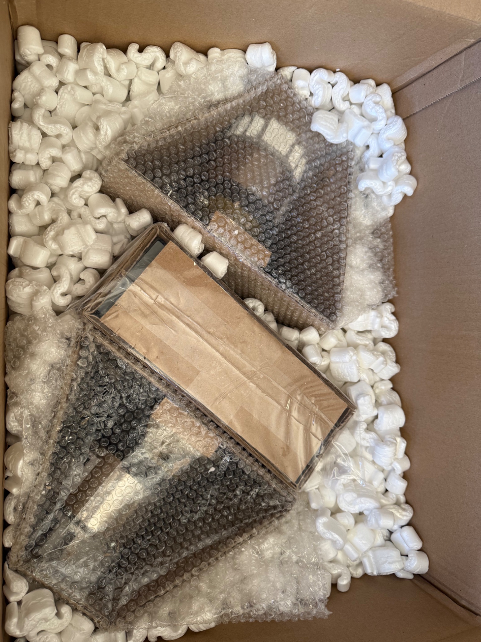

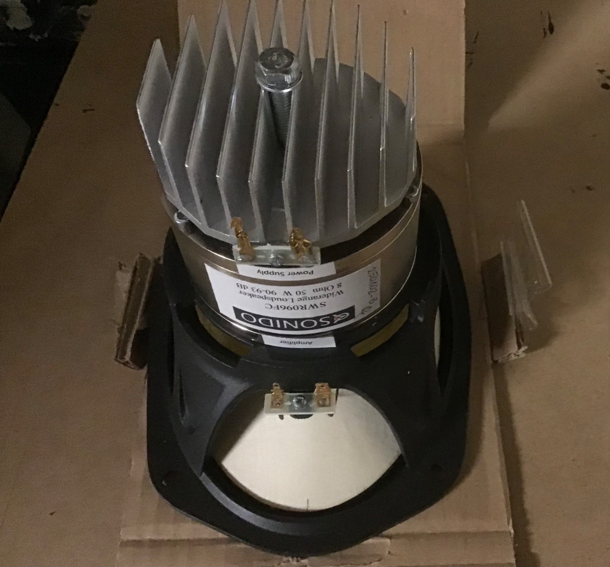

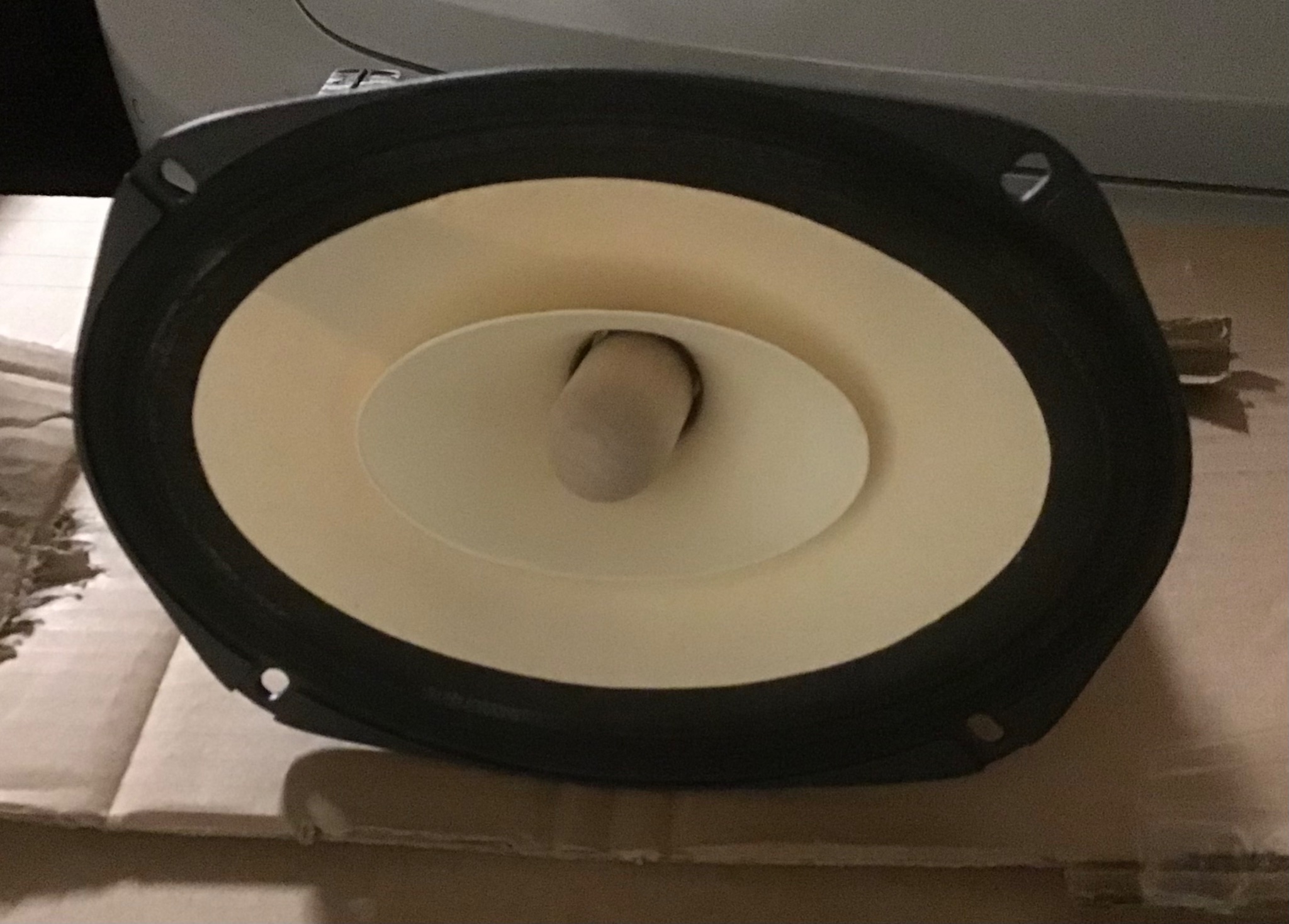

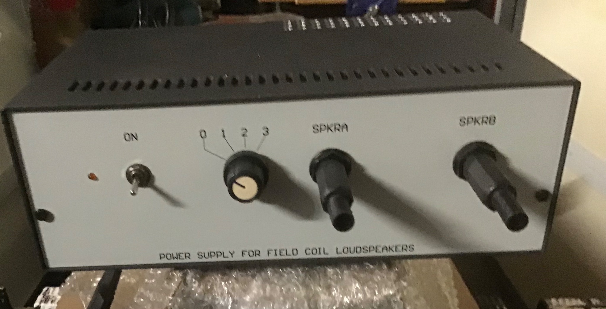

Went ahead and took a “leap of faith” and decided to build the Sonido Towers with the SWR096FC drivers. They arrived this week and look to be excellent build quality. Was a bit disappointed the speaker FC power cables and cabinet port tubes were not included in my packages. Contacted Istvan and he immediately offered to send them. Great customer service!

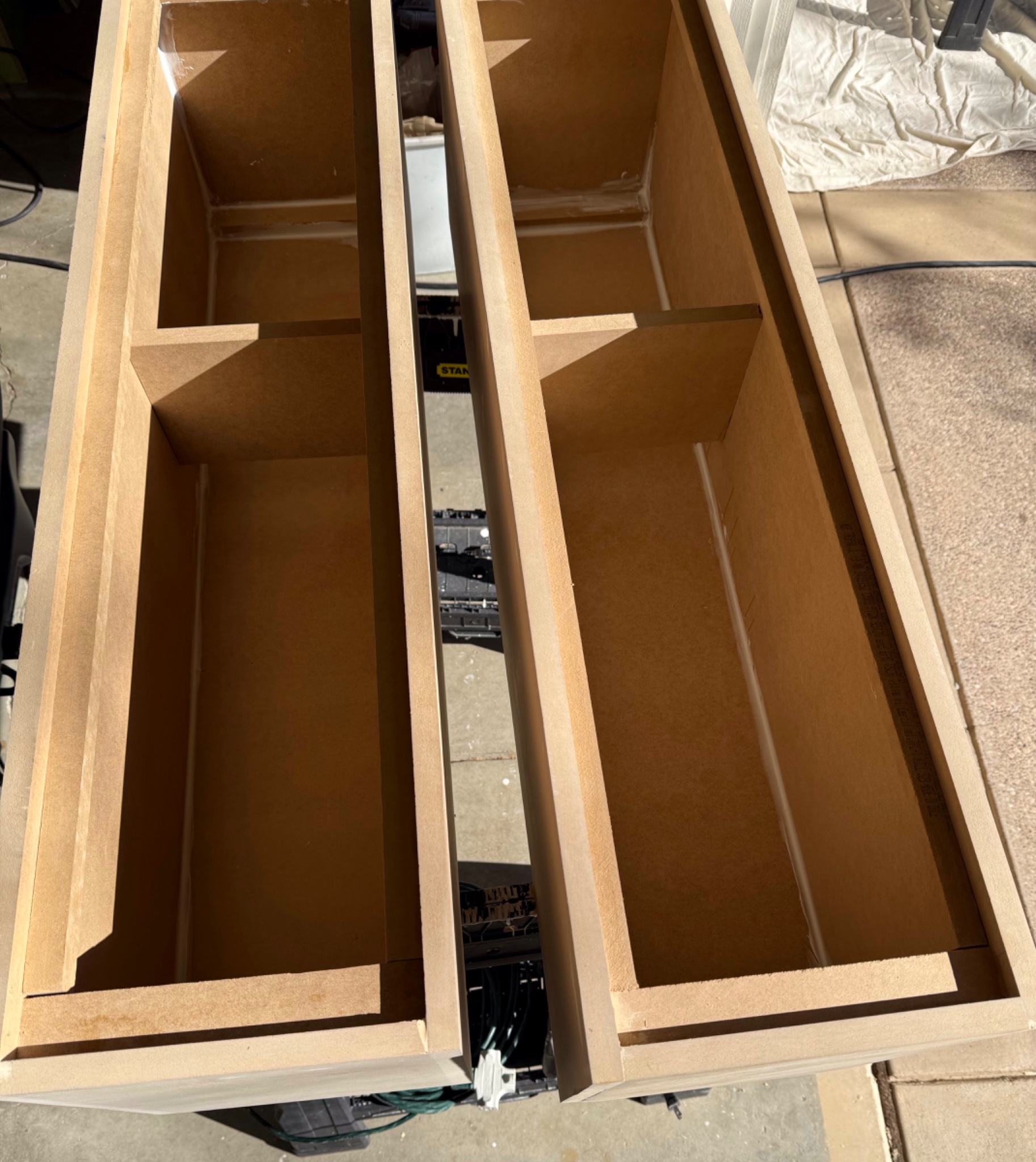

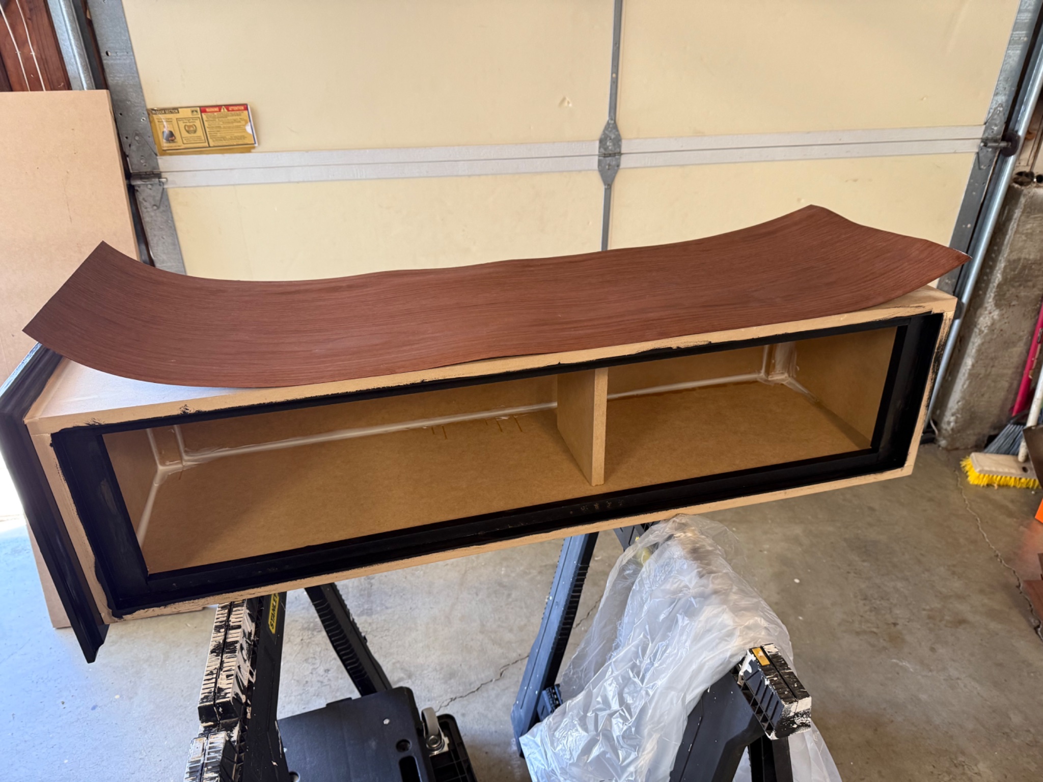

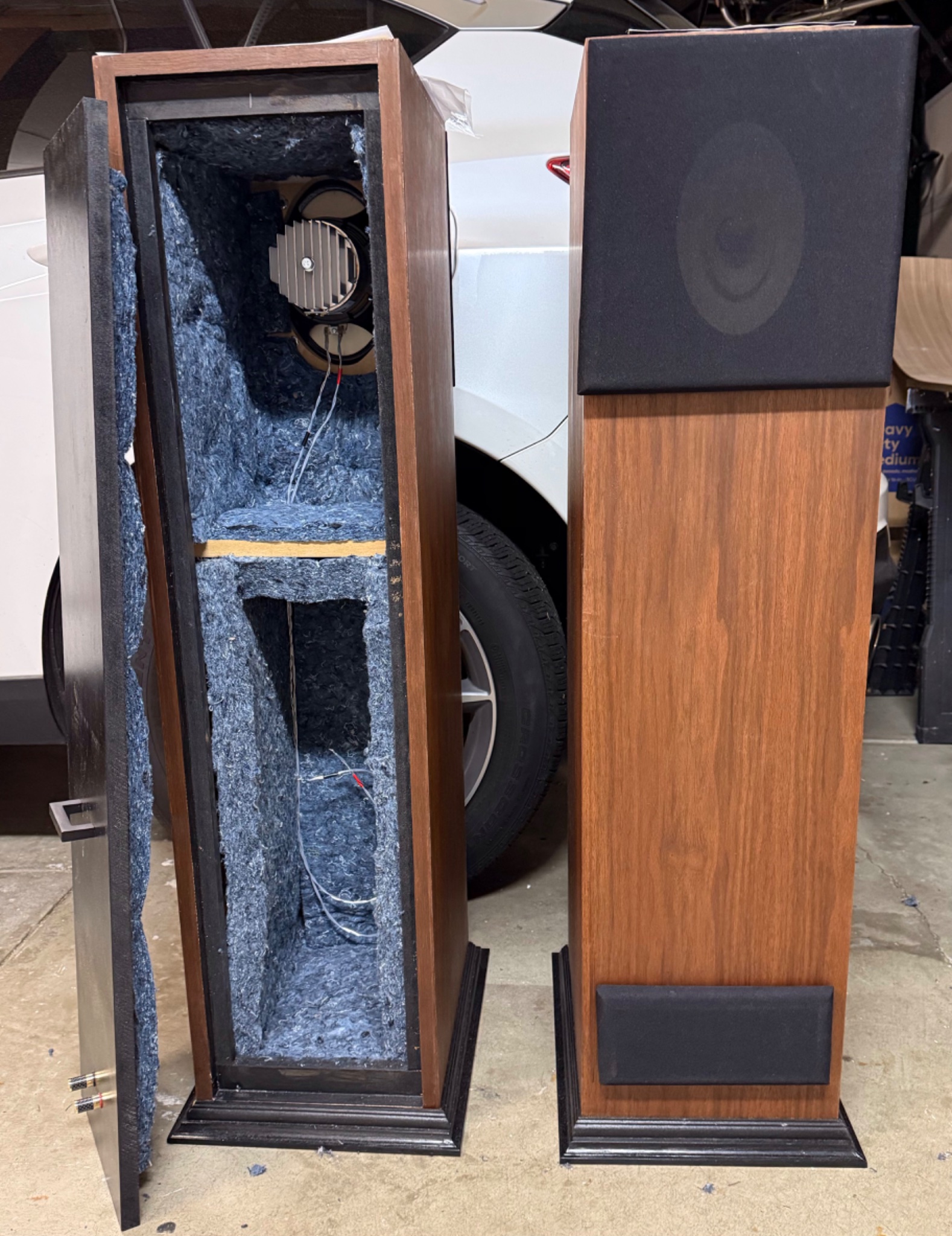

Having fun playing around in my garage with this build. Used Sonido’s plan which was a simple build. Some pics…I’m just waiting for the port tubes, FC power cables and walnut veneer just arrived to finish the tops….

Finished the build and with 2 days of listening. Even though the cabinet is a simple ported design bass reflex the bass sounds excellent. I was thinking of doing a horn or full TL but decided to give Sonido’s design for the SWR096FC drivers a go. I figure Istvan knows better than myself. It was an easy build with low cost so I may build additional cabs to try the drivers in. Maybe an open baffle🤔 or full TL…I feel this is just a beginning 🤪

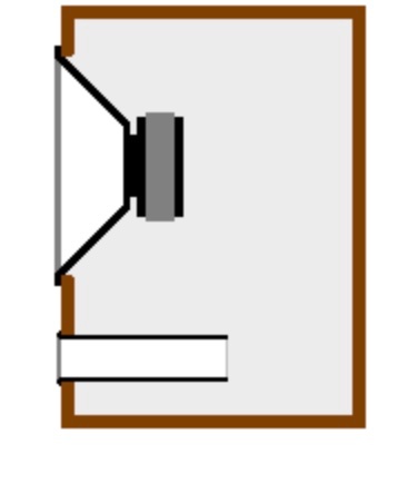

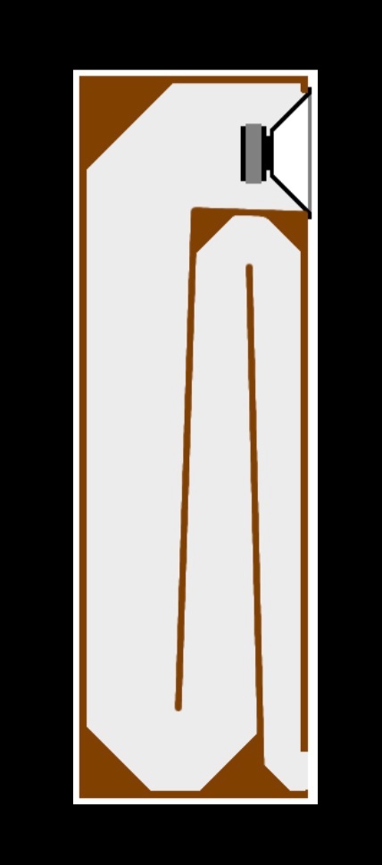

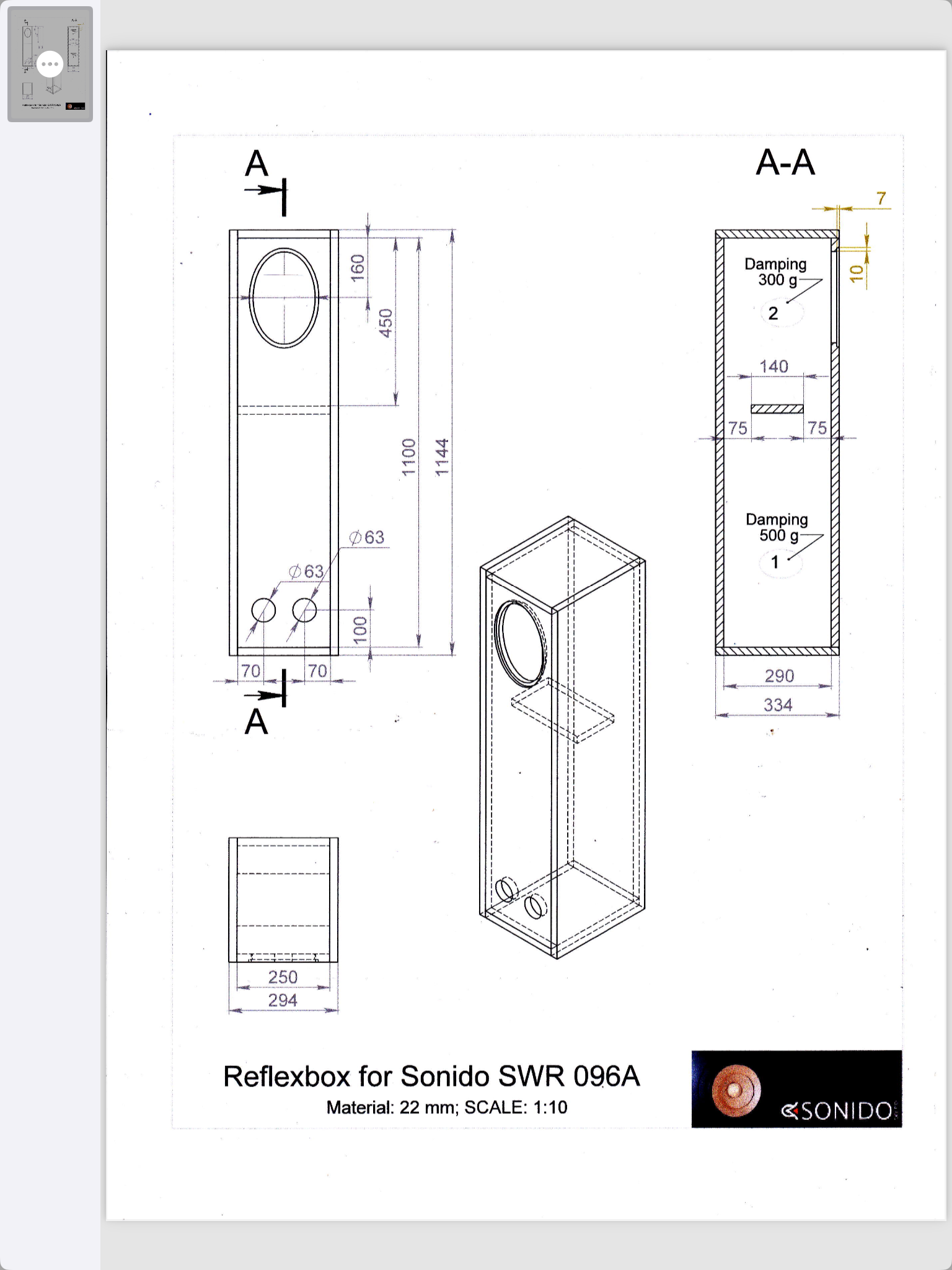

Dave,
Ok , certainly not an expert here on speaker enclosure cabs. The pics attached are my limited understanding of the two cabs. Does the center brace and cabinet size make the Sonido cab a TL? Just here to learn. Thanks
Any time one dimension becomes significantly greater then the other 2 a quarterwavev eigenmode is formed. A transmission line.
A reflex assumes an approx “cubish” box, one who’s dimension ratios are not too large.
Since it ks called a reflex and not an ML-TL i instantly distrust the design.
dave
