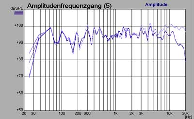

Any low Qts driver need some help with enclousre for low and upper bass. But at my opinion powerfull magnet and very well controlled movement of the diffusor (good relation between Bl and MMS) is realy great advantage of such drivers.
Yup. More motor power the better IMO.
Somebody should build one of Horst's designs to hear if they're as good as claimed, compared to some other designs that he has stated his ''better-ness'' too, i.e. Bvr's, Frugal , Bib's ? etc, etc... Dave 🙂

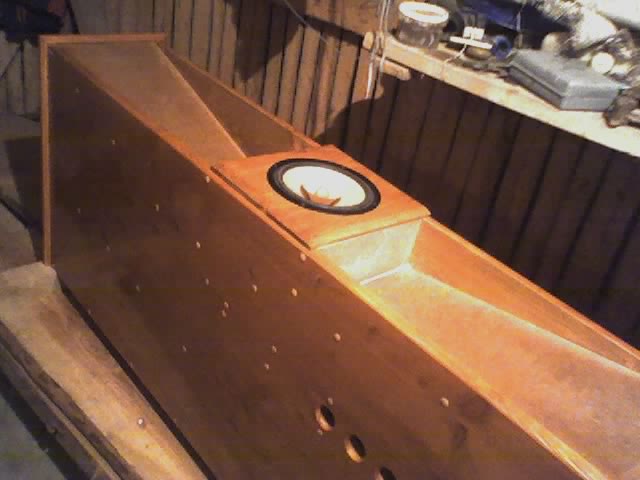

Don't forget that the 'ear bleeding' frequencies you refer to are well above the BW in which the cabinet is operating. It's a question of driver, not enclosure, characteristics. You might be able to do something about it with amplifier, wire or a series resistor, but short of putting them on an extremely long horn, there's little the cabinet itself will be able to do.
Scottmoose said:Don't forget that the 'ear bleeding' frequencies you refer to are well above the BW in which the cabinet is operating. It's a question of driver, not enclosure, characteristics. You might be able to do something about it with amplifier, wire or a series resistor, but short of putting them on an extremely long horn, there's little the cabinet itself will be able to do.
Hi Scott,
Could be wrong but I say nope, I had them on a simple ob and also in the bib. On ob these Sonido drivers sounded amazingly even. There were no problem with "ear bleeding" tendencies at this particular piece of music.
The only difference between bib and Sonido horn is that the resonances occur at different frequencies. However these Sonido boxes are better than the bib regarding the leakage of mids. And in both cases, problems disapear by blocking the mouth with damping material.
Peter
For sure there are issues with panel vibrations which I'm going to attend with braces.
Reflections back through the cone is a probable cause then. I can't think of any case of output at ~300Hz or lower being 'ear bleeding.' BTW -forgot to ask, were your BIBs in the room corners?
Scottmoose said:Reflections back through the cone is a probable cause then. I can't think of any case of output at ~300Hz or lower being 'ear bleeding.' BTW -forgot to ask, were your BIBs in the room corners?
Regarding reflections, I don't think that's the cause. It's not audible when putting ear close to the cone, only when putting head down in the mouth. BTW, my wife and children thinks I'm nuts when standing with my head down in the speaker
I agree about the "ear bleeding" effect. It is higher up in the frequency as I checked with test signals. It seems like there are some high output, narrow band around 2.6-2.8 kHz from the mouth.
About bib in corners. Yes, tested in corners also.
Whoa!
The damping in the throat (closed end) combined with damping through the bend should attenuate everything above a few hundred Hz at most unless it's a panel 'squeak' past the bend due to an air leak, resonant void, etc..
GM
That's what I was wondering. And I believe that's with the Sonido BLH too which has a pretty reasonable back-chamber volume. Something definitely not right there.
Hi Gm,GM said:
Whoa!![]()
GM
To be sure we're talking about the same boxes, it's the Sonido horn we're dealing with.
Haven't got time to check both of the speakers, but yes you could be right about resonance! The "ear bleeding" coincide with panel vibrations at the very end of the mouth.
Regarding leakage I have an acrylic sealer for outdoor use, in plenty amounts, at every joint. But one can never be sure...
I have no damping at the bend for now, maybe try that later.
Peter
