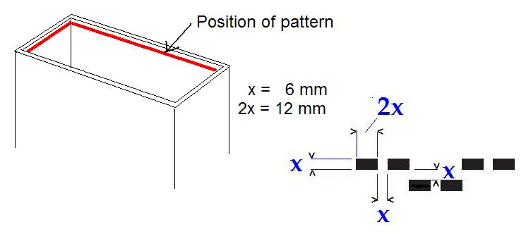

G'day peterbrorsson,
Try the following and see if this addresses you room node issues.
Parts list:
- Scotch Magic Tape (19mm)
- Duct tape (PVC)
- Cutting knife or blade
- Cutting Mat
- Ruler
Instructions
1. Lay strips of Scotch Magic tape sticky side down on a cutting mat
2. Lay a strip of duct tape sticky side down also on the cutting mat
3. Using a blade, cut the duct tape into 12mm x 6mm rectangles (blocks)
4. Pick the blocks off the cutting mat using the blade
5. Lay the blocks on top of the Magic tape EXACTLY as per the pattern pictured below
6. Peel up the Magic tape with attached blocks
7. Stick into the BIB mouth on all four sides (see pic)
I think you will be pleasantly surprised.
Alex

G'day Alex!
I have followed the enabl thread and I've hesitated treating the drivers. This what you describe is reversible and not complicated.
Though I doubt it will solve the excess of mids from the mouth.
I'll have a shot at it anyway.
There are for sure issues with panel vibrations at the mouth.
I would say side + back panel should be doubled or at least braced the last half of the pipe.
Regarding the inner baffle, I can't feel any vibrations. Maybe not necessary here.
Peter

G'day Peter,
It won't address excess mids from the mouth, but it should have an effect on the room nodes.
Alex

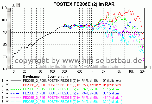

Hello,
look the published frequence diagrams of these drivers:
Visaton B200
Seas Exotic F8
Fostex FE 206 E
Audio Nirvana 8"
Sica LP 208.38 1100
Ciare HX 201
div. Lowther
Sonido 8"
Lyeco LY805F
Lowther by AER:
http://www.aer-original.com/html/hobby_hifi_01_jan_2002.html
than you will understand.
example 206 by Selbstbau.de:

I'm afraid you'll think I'm dense (you won't be alone in that...
), but I still can't see why everything below 800Hz requires boosting for every single driver.
Looking at the very interesting FR graph for the 206 you attach, we see at the bottom end of the scale, the driver's natural low frequency roll-off below its mass corner (the -3db point Fhm being determined by the equation 2Fs / Qt). And we also see the characteristic rising response of a low Q unit. This is a variable point -the AN drivers exhibit this rise at a relatively low frequency for example, while the response of the 206 does not start to rise until slightly over 1KHz. Are you using 800Hz as a mean value?
Anyway, regarding the rising response of a driver of this type, then AFAIK, there isn't a great deal a back-loaded cabinet with only a single driver mounted can do to correct for it without resorting to a shelving filter, though a lengthy horn of any kind should help attenuate the rise to varying extents due to its high damping causing HF roll-off.
As such, my own take on it (which is certainly not the only one; just my own view) is that you can really only concentrate on boosing the driver's SPLs with a back-loaded enclosure below its moving mass corner, or as far as that is possible / practical to achieve, & handle the driver's naturally rising response via other means, if it proves to be a problem. FWIW, the -3db moving mass corner fhm for 3 of the drivers you refer to above based on published specs (purely as an example) are:
Visaton B200: 105.96Hz
Fostex FE206E: 433.33Hz
AN Standard 8: 410.3Hz
Regards
Scott

Any low Qts driver need some help with enclousre for low and upper bass.
But at my opinion powerfull magnet and very well controlled movement of the diffusor (good relation between Bl and MMS) is realy great advantage of such drivers.
Sorry for bad technical english.
