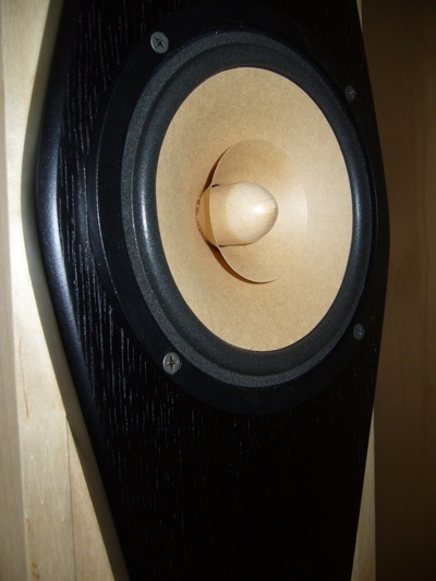

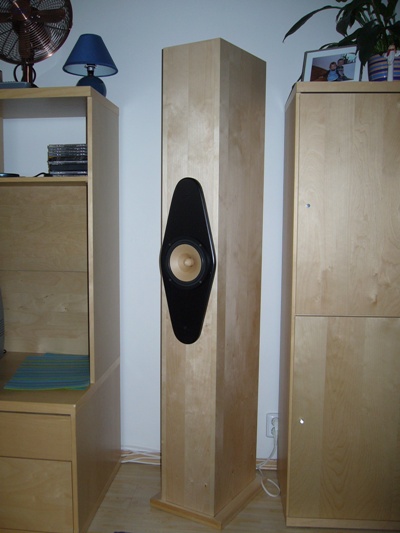

After one year, they're finally finished. I have build two pairs of BIB's with Monacor SPH60 before and had some issues with too much mids coming out of the mouth. I decided to give them one more chance with different drivers.
These Sonido boxes predates the formula given by GM, so don't know if GM's would be different, but doubt it!
These Sonido's are much better in the mids and treble than Monacor's. And despite they're bigger the sweetspot is much larger, probably due to the phase plug.
I will be careful about my opinions about the drivers until I have more hours on them. Not to say my ears also. After building speakers x years, I've learned when putting blood, sweat and tears on the the boxes, it HAS to sound good.

I've put in quite a lot of work on this pair. 38 wooden plugs are used in each speaker + silicon sealing on inside joints.
The only contact the black baffel have with the box, is two screws,
+a layer of duct seal take care of the remaining contact.
This was a test to see if the panel vibrations around the mouth disappear. My old BIB's have the same panel thickness and are also smaller. It seems to work, as vibrations are less on the duct sealed ones, but I would like to go even further and have the baffel screwed with a rubber bolt. We'll see about that later, maybe.

It makes me wonder if the boxes should be a tad shorter, lets say around 1.4m. This is possible to do without any problems technical speaking from wood working point of wiew.
It's just to cut them down from front, upper side walls, down backwards in a certain angle, that way one has the benefit of killing some ripple also.
Question then is, there will be two lines with different lengths.
The beguinning of line will be longer than the second one.
Peter
It's all one line, not two. It just means the horn will be a little shorter, that's all. So I wouldn't worry about that.
