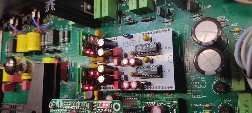

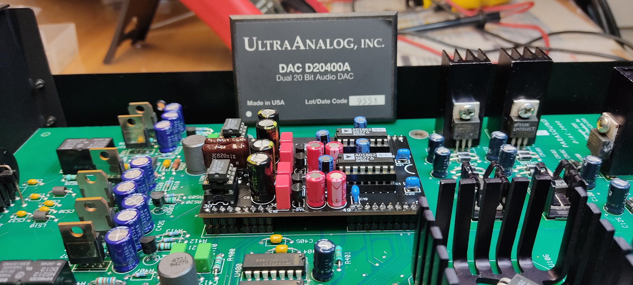

Funny, I had over 40 diferent dac. I had 3 psc parasound 2000, two was modified (vishay bulk foil resitors, muse ES, Silmic, Wima FKp caps, MUR860 diodes) I would not call it good dac. somewhere in the ball park of Sonic Frontiers sfd1mk2 - quite medciore. Even modified Denon DVD-5000 player with discrete IV sounded much better. even "lower" Parasound dac1500/1600 with redesigned analog filter) sounded better. I have Mark Levinson, Wadia, Spectral DAC's They definetely not ir the other class than parasound. They just completely diferent. Both sonicaly and from engineering perspective. I had many DAC with UA20400 and none sounded great (except spectral maybe, but there other things makes this dac sound good, not dac chips)- sound is always rounded soft in hights and wooly in bass. PCM56 is much better, pcm1702,1704,pcm64, AD1864 is better. seems everything is better than ua20400.
I'm not good in digital, but this PCB seems like a scam to me. this is not to insult designer. The sad times have come to DIY audio are where 4-6eur value items with few caps and voltage regulators) selling for 100+ eur. it even doesnt have selection of input /output bits lenght. the same people laught on high end manufacturers (who actualy had much smaller profit margins).

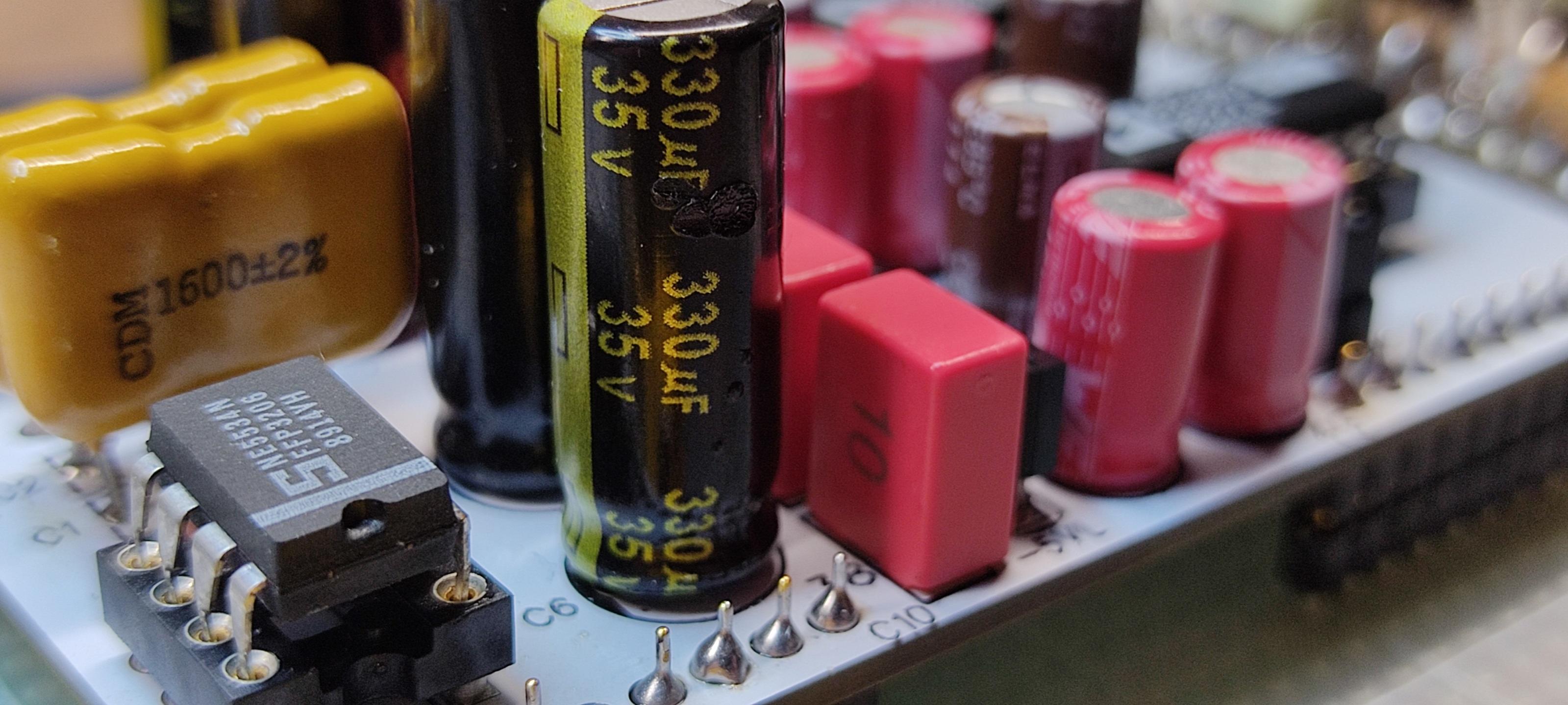

4-6€ for:
Cornell Dubilier silver mica capacitors
Elna Silmic II capacitors
Vishay/Dale resistors
Wima capacitors
Organic Polymer Wurth
Capacitors
Panasonic low esr capacitors
All bought on Mouser store
+ PCB cost
YOU ARE SIMPLY RIDICOLOUS
and I won't add anything else about your insinuation that I am a scammer, because anyone who knows me knows very well who they are dealing with!
Ciao!
Antonio.
I'm sorry if I offended you. it was not my intention. probably diferent cultures. this is rougly price for the parts. 7eur or so. it can be build cheaper buying suprplus parts of course and - in larger quantinities. I usualy buy silver mica CDE for 0.5eur/psc here. there is nothing expensive in this board. there is no rocket science either. I have build same module with PCM63x 2 dac chips-to replace broken ua20400. just step down regulators and rewiring , and bypass caps together with IV opamp socket. if there is really demand of that converters I can build same for 30eur(with some profit in mind) for diyaudio forum members. just gather minimum required qty of 20-30psc and I will do. for me this is clearly high margin profit sales oriented posts rather than trying to help other fellow diyers. I am not against business but this is definatelly business /profit oriented thread ather than helping diyers. just my two cents.

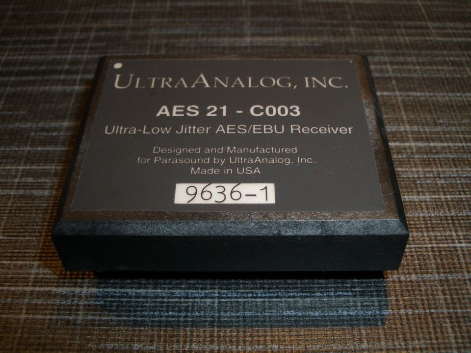

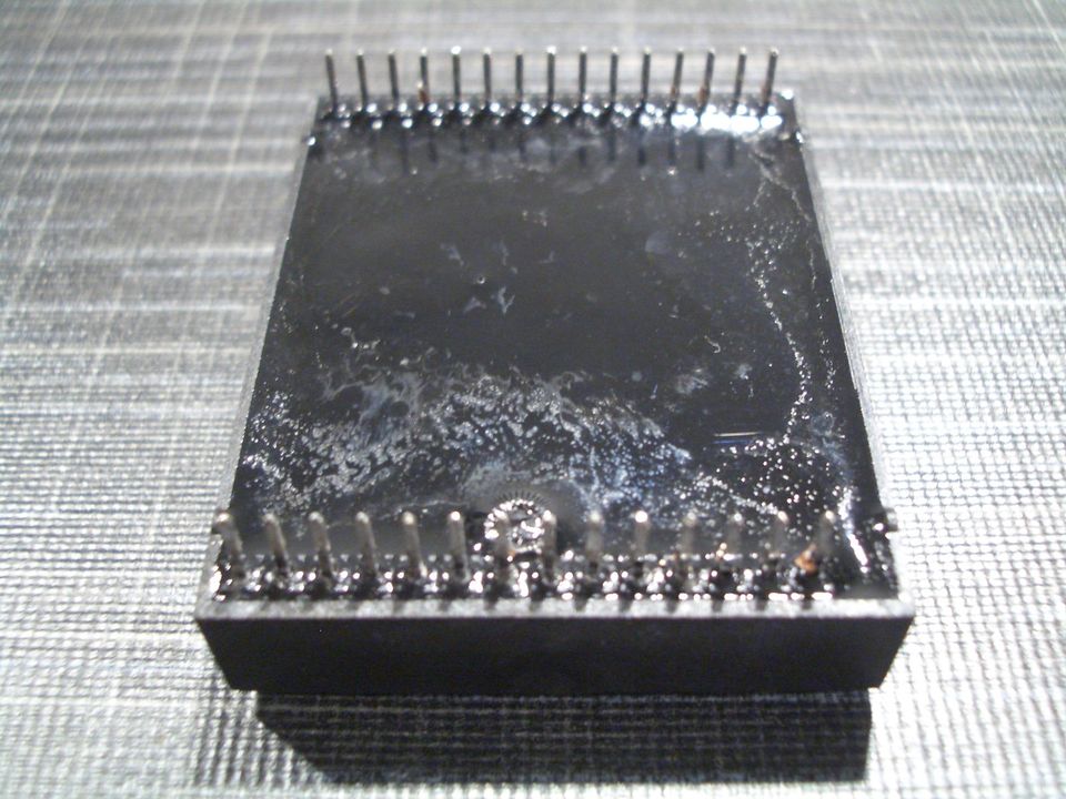

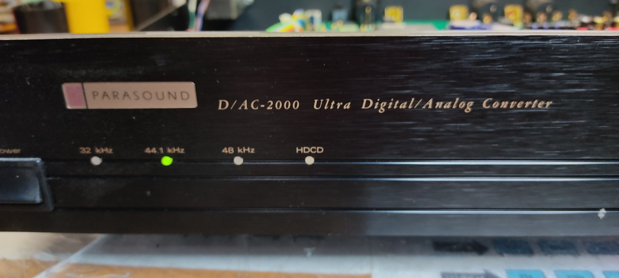

Yes it was mine, and this video shows the upgrades that I have performed on this unit.

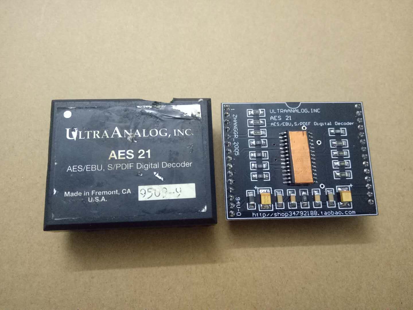

More recently, I have completed the design of an AES-21 replacement socket for the persons having a DAC with a faulty AES-21.
It has been successfully tested on a Parasound DAC-2000 , which was out of order because the AES-21 was broken. 🙂 😉 😎
but of course there are other DACs than the Parasound using an AES-21....
