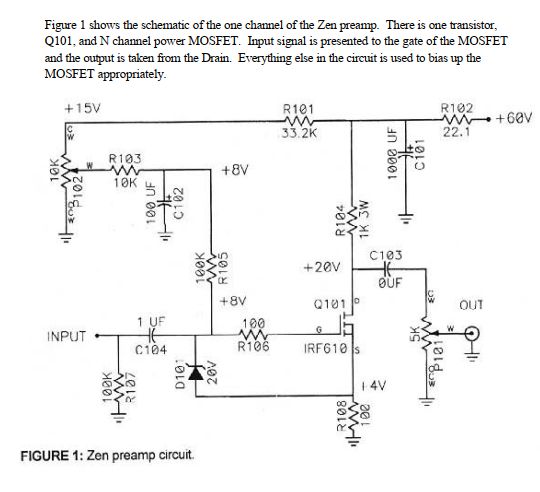

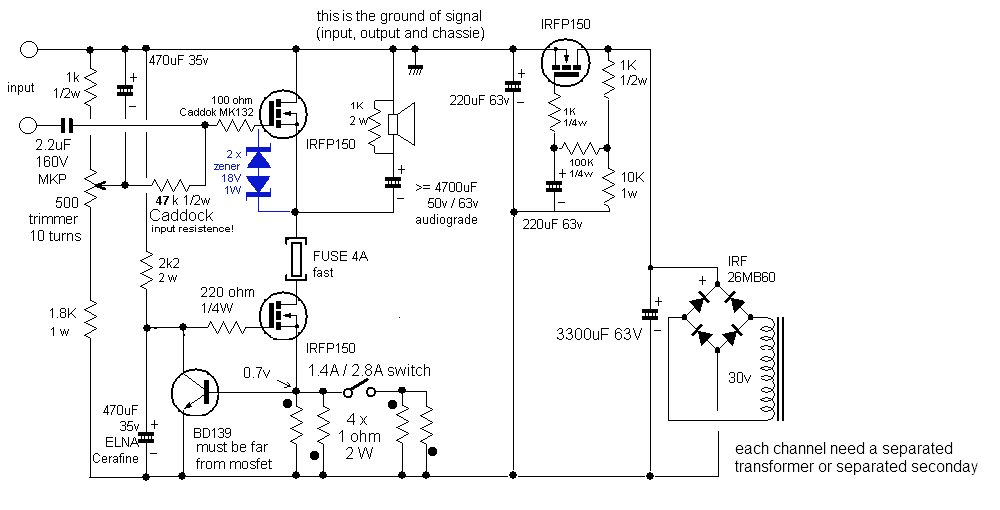

Regarding my way and the fear of input capacitance.
Here you can see what @Nelson Pass does with IRF610 input.
It is his classical 'Bride of Zen' circuit.
It is also a one mosfet amplifier.
Reactions: habosmakos

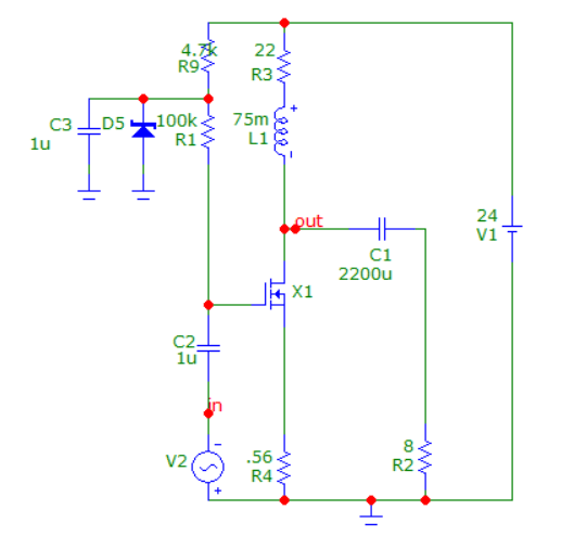

One MOSFET and One resistor ...
This amplifier is for you who have a headphone: 8, 16, 32, 60 or 64 Ohm impedance.
The trafo is 2x12VAC.
The MOSFET can be any TO-220 or TO-247.
For example IRFP240, IRFP140, IRFP044, IRF540. (IRF520 and IRF610 gives a little more distortion = more MOSFET sound)
The resistor should be 5 Watt.
If you have some MOSFET laying around, this project is for you.
You get good use of your MOSFET.
I have not built it. But the SPICE test shows it is a good, solid and fun design.
It works 🙂

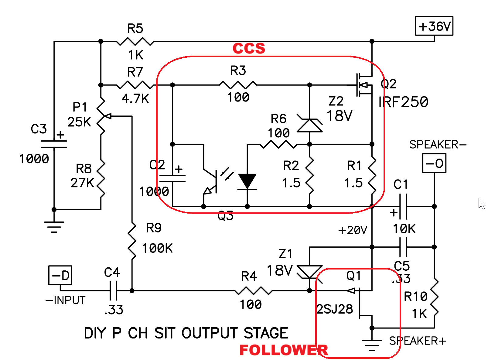

When I replace R3 by a CCS, I get Andrea Ciuffoli's single ended power follower - go to
Has anyone ever compared the sound of different MOSFETs in this version with CCS ?

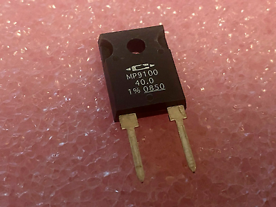

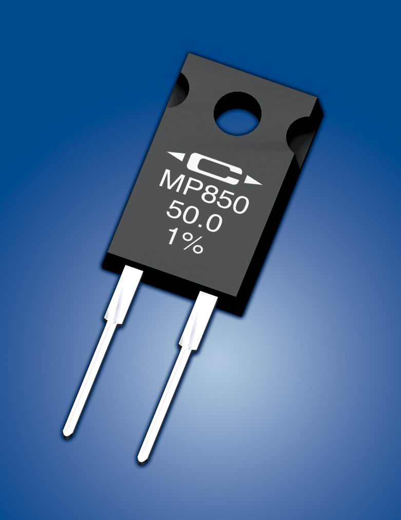

Important is R3 - best results you will get by use of a TO247 or TO220 outline from Caddock
P.S.: image 1+2 under
show a preamp version of this power follower - I guess, the headphone amp works even as preamp fine.

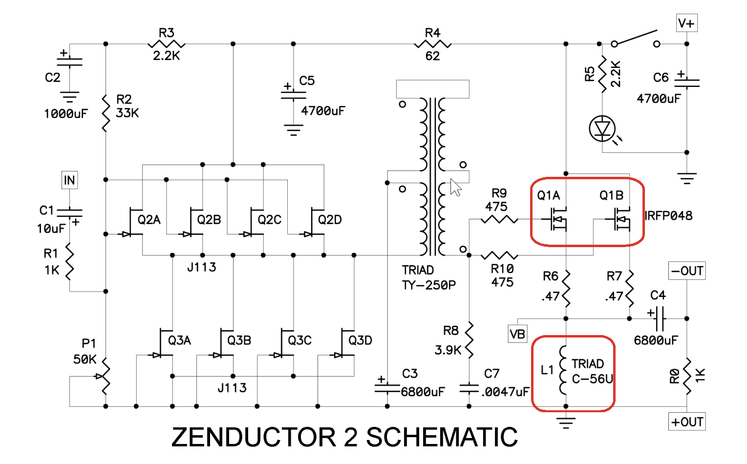

The VFET Lottery Amplifier is a source follower with a constant current load.
The Zenductor2 Amplifier is a (pair of parallel) source followers with an inductor load.
