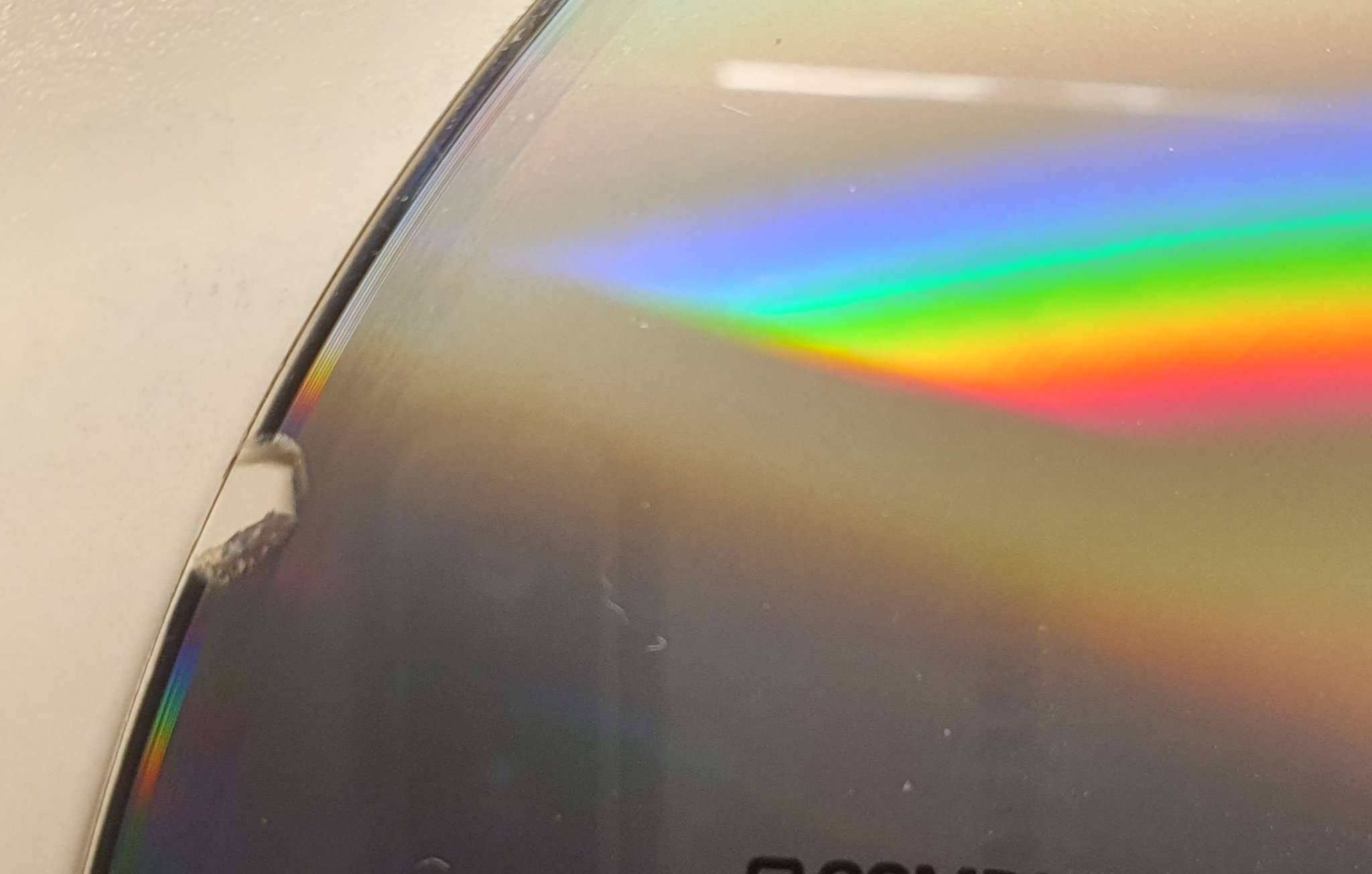

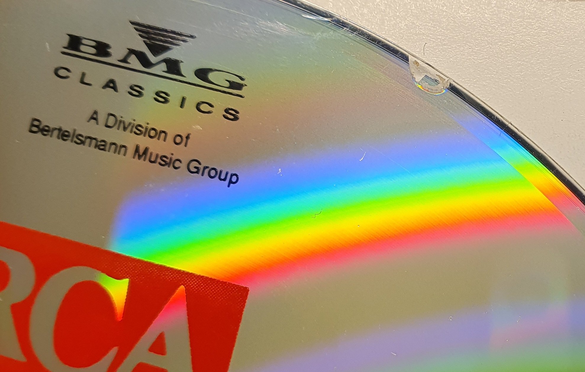

A nice example from my collection. It is interesting the damage does not reach the part where music pressing is visible, yet I am unable to play the last track until the end.

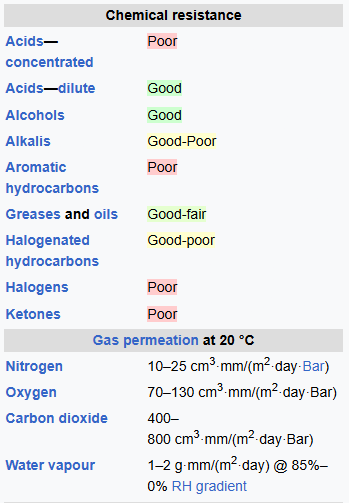

There is another thing not mentioned - osmosis, as the outside layer can and probably is porous. You can see this all the time in seemingly impenetrable layers of glass fiber boats.
Side delamination or simple chemical activity also can be a reason. Or many more. There is no "longevity" or "reliability" in CD by design.
https://en.wikipedia.org/wiki/Polycarbonate#Environmental_impact
From the chemical and resistance perspective something like Polyethylene could be MUCH better, except the low melting point and the fact, that you can probably set it on fire with laser...
