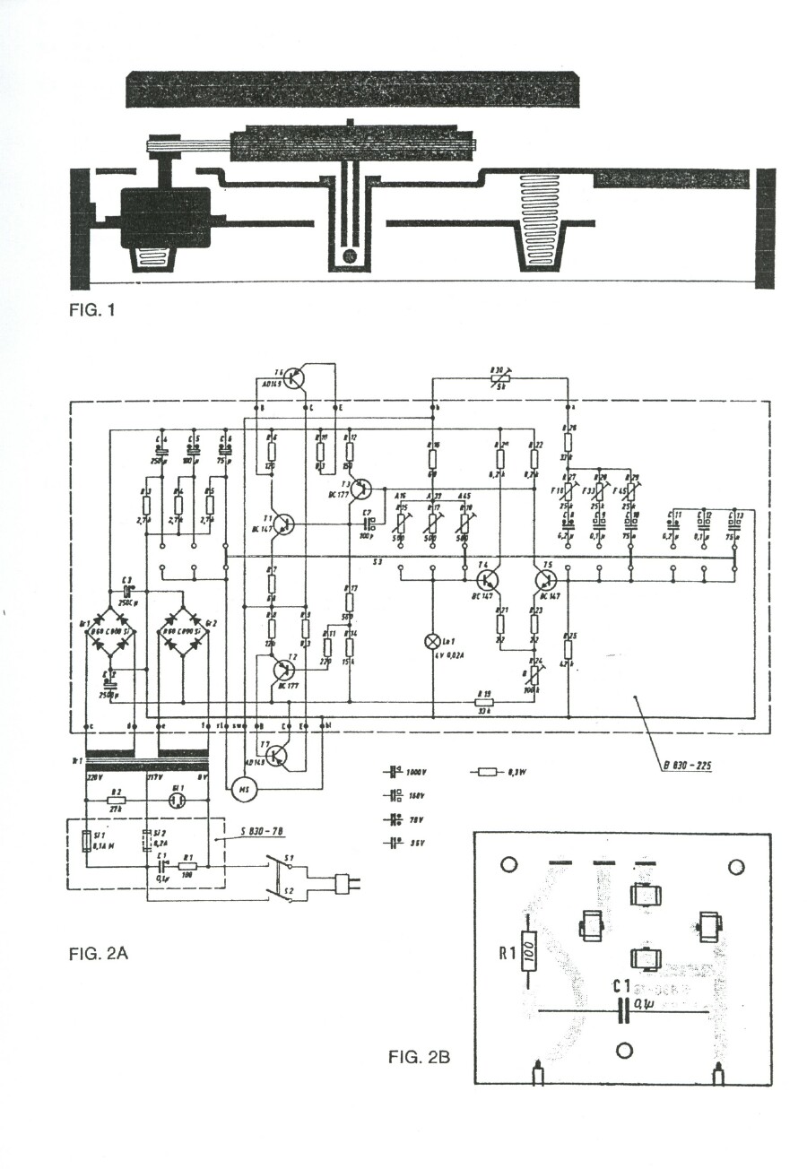

Shouldn’t the motor be mounted „behind“ the spring, so that any vibration of it get absorbed too?

I probably misspelled, here’s the official thing:Can you draw up a sketch?
That looks weird ... but interesting! 🙂
If the motor really is resting on its own subchassis - which is different to the one supporting the bearing and arm wand - then I would think it should work quite well.
I think that is a cutaway drawing of a Thorens table, a pretty common layout, Linn, AR, etc.
It may well be a dwg of a Thorens ... but a Linn has its motor fixed to the top-plate. (And the bearing and armboard fixed to a subchassis which is connected to the top-plate by springs & bolts.)
Right, same as AR. the point is the motor is mounted on the other side of springs that support the platter bearing and arm. Linn springs actually work well in the td125 because they are doing the same thing in both cases.
It’s the „schematic“ of a td-125 🙂 and yes, the motor is on it’s own stell-plate (with electronics and switches), while the platter and armboard are suspended on 3 slightly damped springs…
