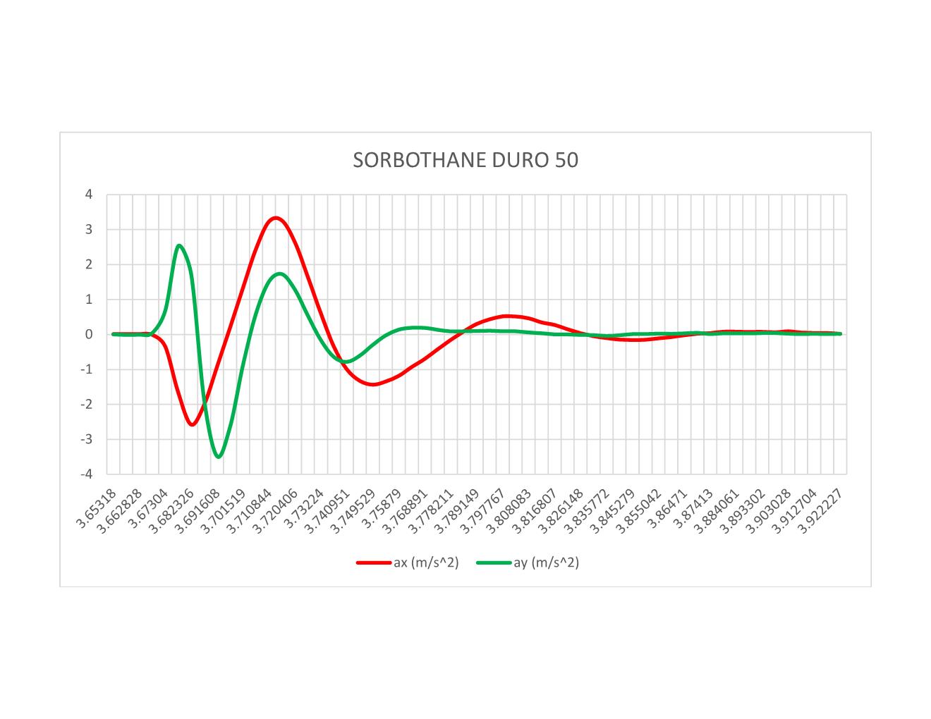

I measured some sorbothane pucks. I could not get anything clean in the Z dimension by either pushing down or tapping the plinth. This was taken with (4) 1.5” duro 50 hemispheres under a 26 pound platter/ plinth combo. the maximum weight suggested by the seller was 30 LBs. I have no idea why one of the dimensions (Y = short way on the platter) shows a higher frequency but in multiple measurements, it all looked roughly the same. I see about 11.5 Hz in the X dimension and 20+ in Y.

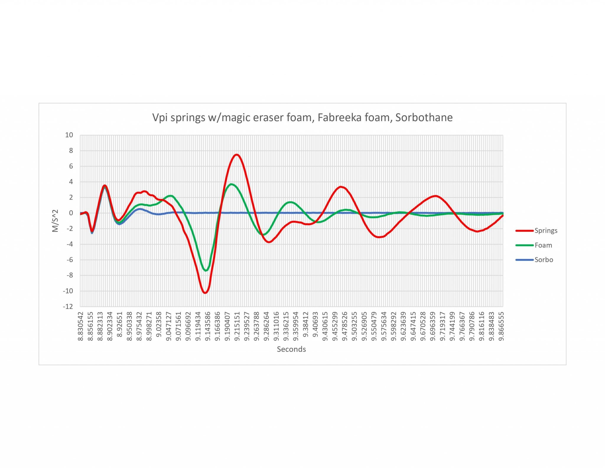

Wow that's a huge difference. There appears to be ~60Hz or so ripple on the spring and foam traces, which will be a source of audible colouration. That might be part of the Linn 'plum in mouth' sound character.

David, I used the sorbothane in lieu of springs, just sitting flat at the corners with plinth on top.
John, Yes that ripple showed up sometimes and I'm not sure if it is an artifact of the way I was releasing the plinth or something inherent in the springs themselves. I think I will measure the undamped springs again and check for ringing like that early in the trace. I was more focused on getting a good read on the frequency and damping rather than looking for anomalies

I’m playing around with a suspension for my new plinth and did some rough measurements of the two options that others might find interesting. In the plots below Z is up and down X& Y are horizontal. “springs” are a set of metal springs from a VPI HW19 “With Damping” means with the original VPI foam inserts in the springs. “Foam” is mixed cell polyurethane designed for building or machine foundation isolation. “Constrained” means that I built a solid wrap in the XY dimensions from plywood about 80% of the height of the foam blocks. I calculated the size of the foam blocks from the manufactures literature and should be getting a resonance close to what I get with the springs but I think the manufacturer’s data is based on wide thin sheets and the shape I am using (essentially a cube) is changing things a bit. One thing you can’t see in the roughly 1 second of data I posted for each is that the undamped springs rang for an incredibly long time, minutes in fact. The vpi foam inserts while they did raise resonance a bit cut the ringing time considerably.
