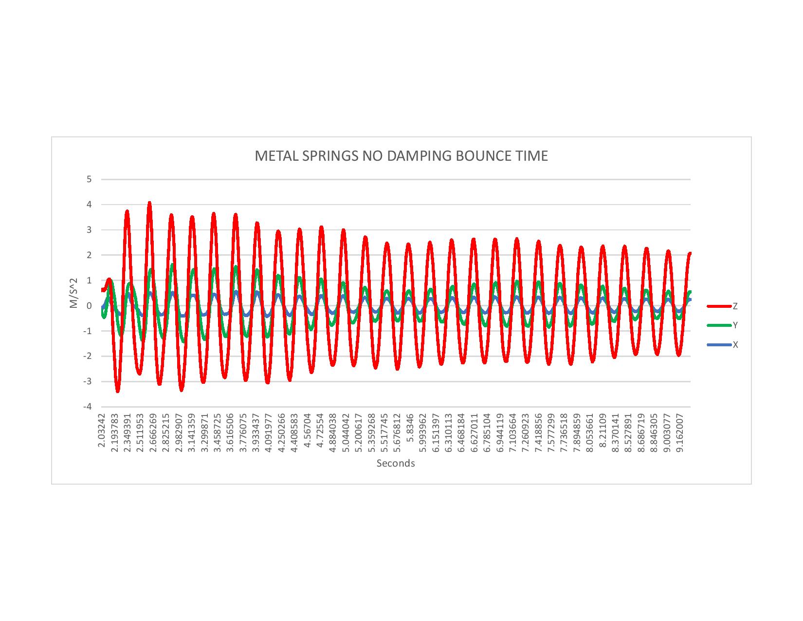

I’m playing around with a suspension for my new plinth and did some rough measurements of the two options that others might find interesting. In the plots below Z is up and down X& Y are horizontal. “springs” are a set of metal springs from a VPI HW19 “With Damping” means with the original VPI foam inserts in the springs. “Foam” is mixed cell polyurethane designed for building or machine foundation isolation. “Constrained” means that I built a solid wrap in the XY dimensions from plywood about 80% of the height of the foam blocks. I calculated the size of the foam blocks from the manufactures literature and should be getting a resonance close to what I get with the springs but I think the manufacturer’s data is based on wide thin sheets and the shape I am using (essentially a cube) is changing things a bit. One thing you can’t see in the roughly 1 second of data I posted for each is that the undamped springs rang for an incredibly long time, minutes in fact. The vpi foam inserts while they did raise resonance a bit cut the ringing time considerably.

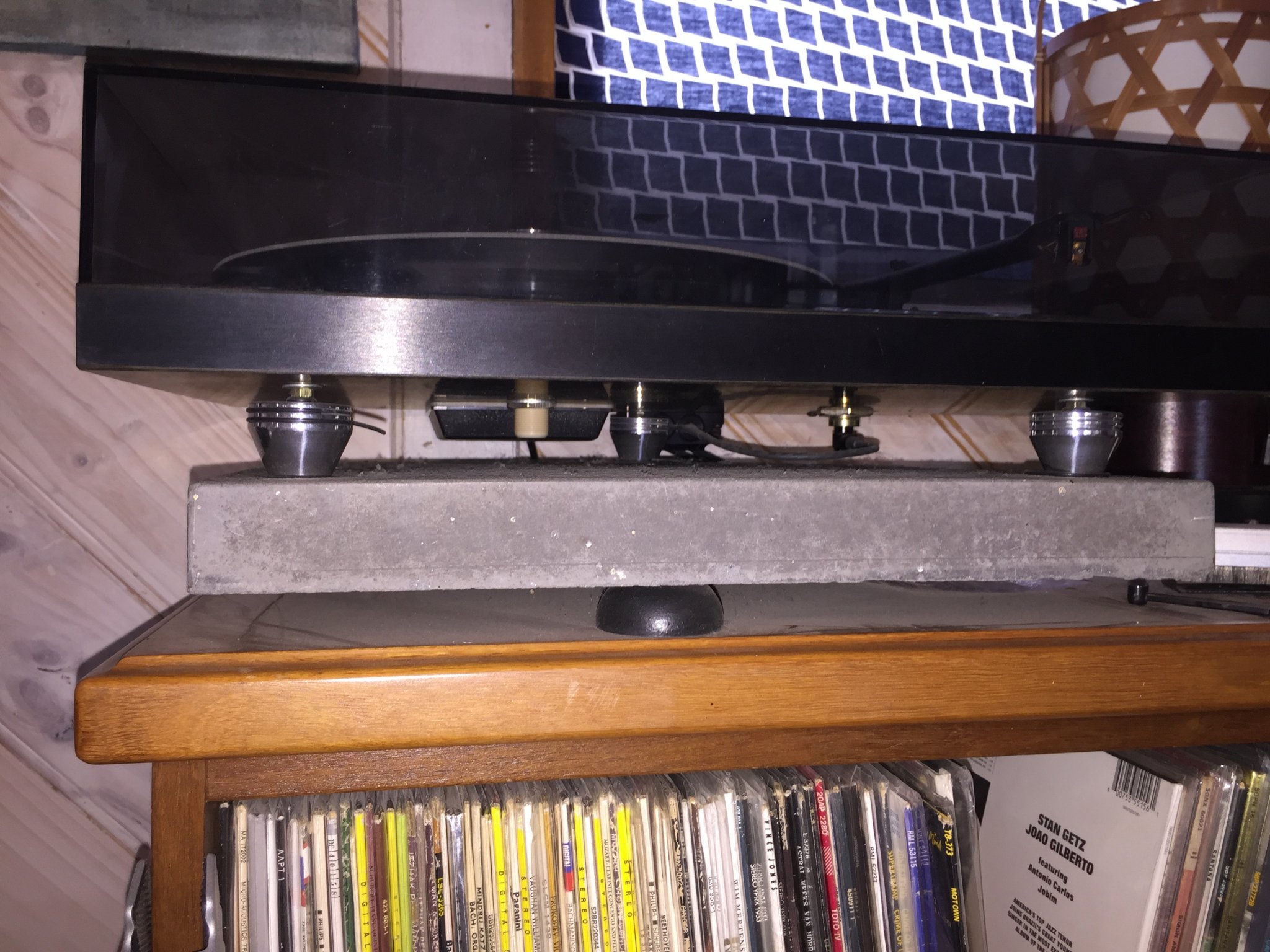

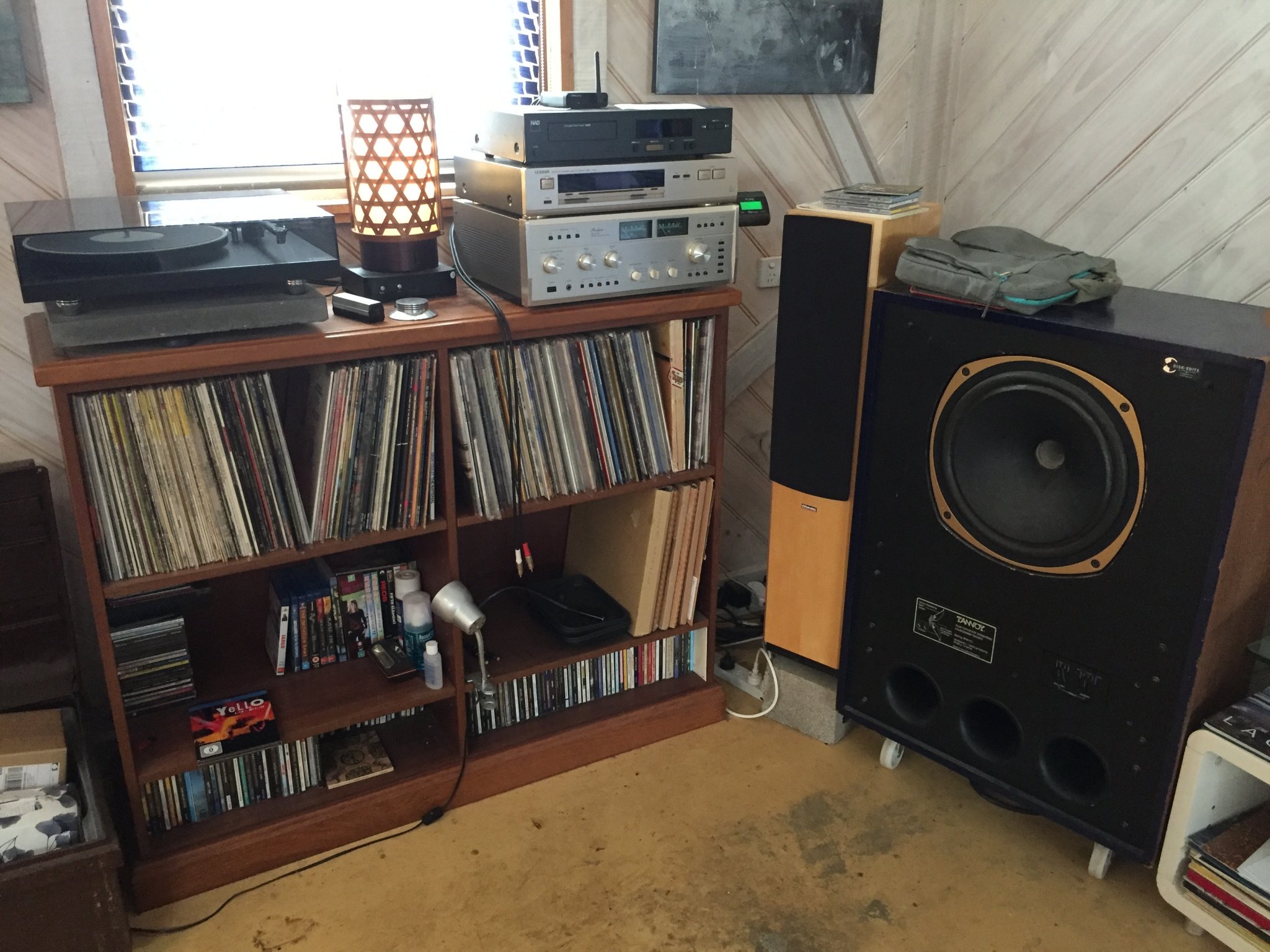

Pictured below is my 1972 Rega Planar 3 with Tangospinner feet (they have an o-ring in the bottom but are mostly decorative - still better than the Rega original) sitting on a slate sub-plinth with three 50mm hemispheres. I can hit the bench-top with a hammer while the stylus is on a non-rotating record and barely hear anything. I suspect this deck would play with a helicopter landing on the roof or through a minor earthquake, yet the plinth feels as solid as a rock.

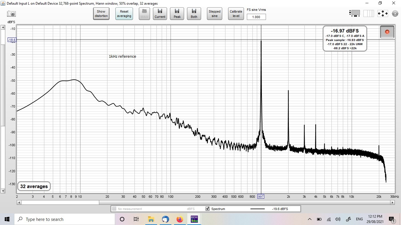

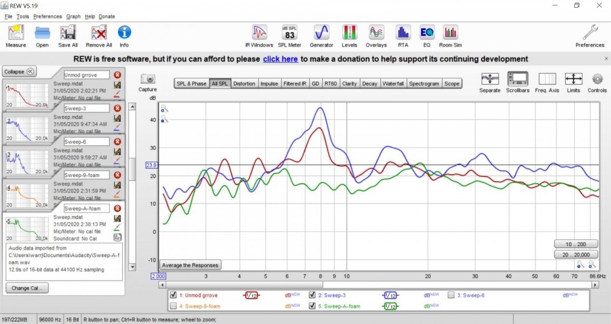

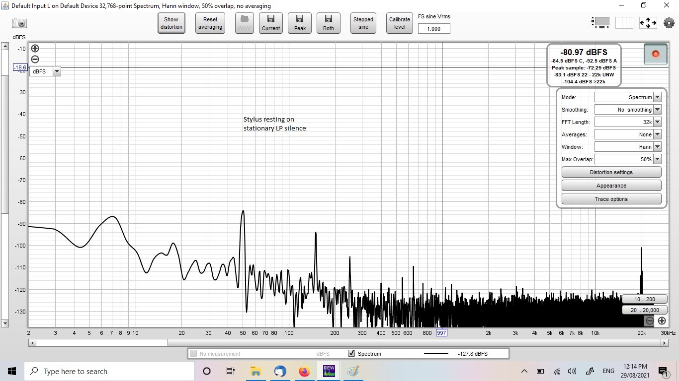

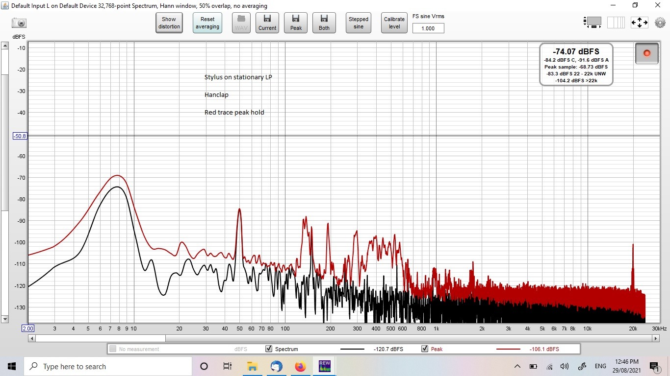

Here are measurements I did some time ago.
TT is a Technics SP10 sitting on plywood with 4x cheap eBay springs under the ply. Output taken from the phono-pre into a Focusrite Solo.
Red trace is playing an unmodulated groove. Blue trace is a sweep from REW through the speakers with only the springs. Green trace a small piece of soft foam was inserted into each spring cage. No other changes were made apart from the foam.
These are pretty self explanatory. The 1kHz was for level reference.

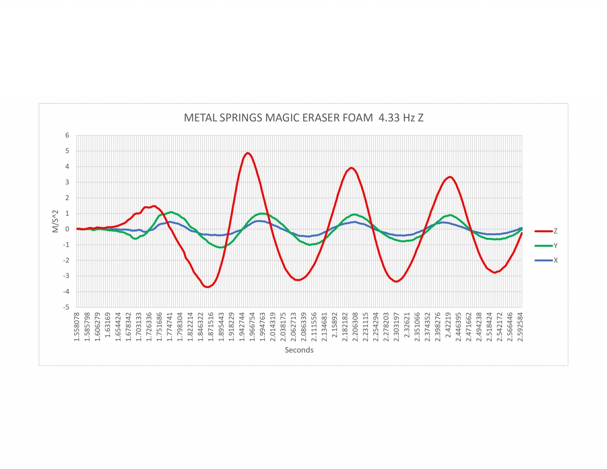

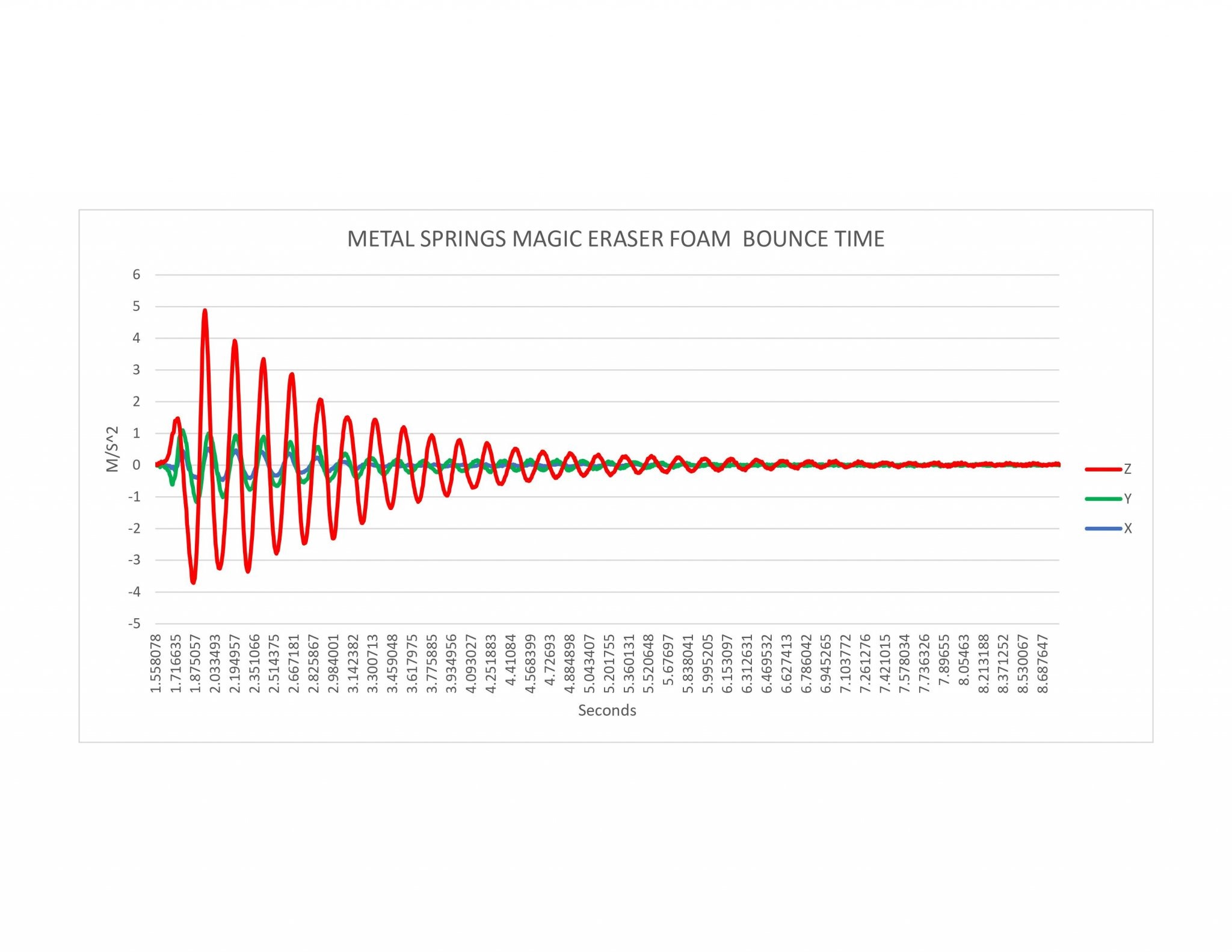

After a few failed experiments with foam springs and damping at the bearing housing I focused in on damping within the metal springs. I tried a few different materials ending up with blocks of foam cut from a magic eraser. This seemed to offer the best compromise between damping and resonant frequency. I’ve attached a zoomed in shot of the magic eraser damped metal springs and approximately 7 second clips of springs with no damping and springs with the magic eraser material for damping. I have some sorbothane hemispheres on order and I will see if I can get them to bounce.
One interesting thing I think I noticed in the multiple measurements I have taken is that the frequency of vibration in the different planes tends to converge. In most cases the frequency of vibrations in the x and y planes was higher than the in z plane, the z plane frequency went up as it tailed off ending 20-25% higher than where it started in one case. There seemed to be less disparity between frequencies with less damping in the springs but I think I would need greater control over the variables to be certain. You can see what I am talking about in the two bounce plots attached. The frequencies in the three planes line up pretty well in the undamped springs but are slightly off in the damped springs.
