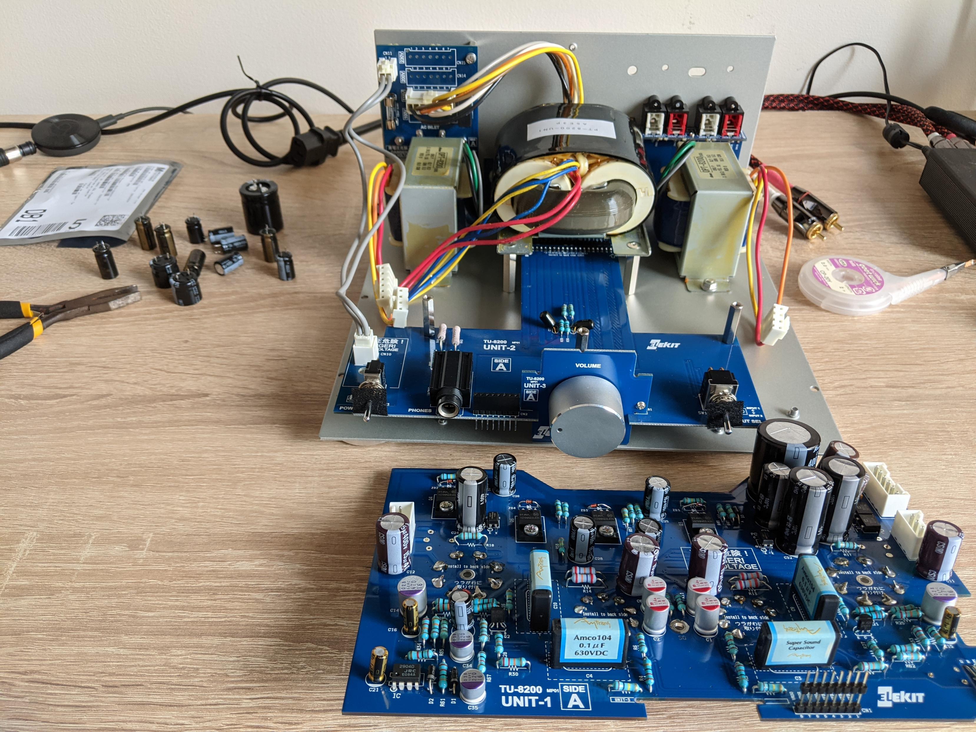

Hi Ferenc,
So well; it's a success!
I performed all the changes except the bridge rectifier as I ordered the incorrect one...
What has changed for me soundwise; greater detail which shows itself more in the decay of the instrument notes. Perhaps a more defined bass but I am only listening through headphones so it is not so easy for me to analize it.
Many thanks
Alejandro
Now listening through my main speakers. Yes, definitely a low end improvement!
I replaced the bridge, and got 6.5 dc at heater in the 12au7, so I removed the short at r64 and ended with 6.15 dc, so that was settled like that
Recommended modifications!
