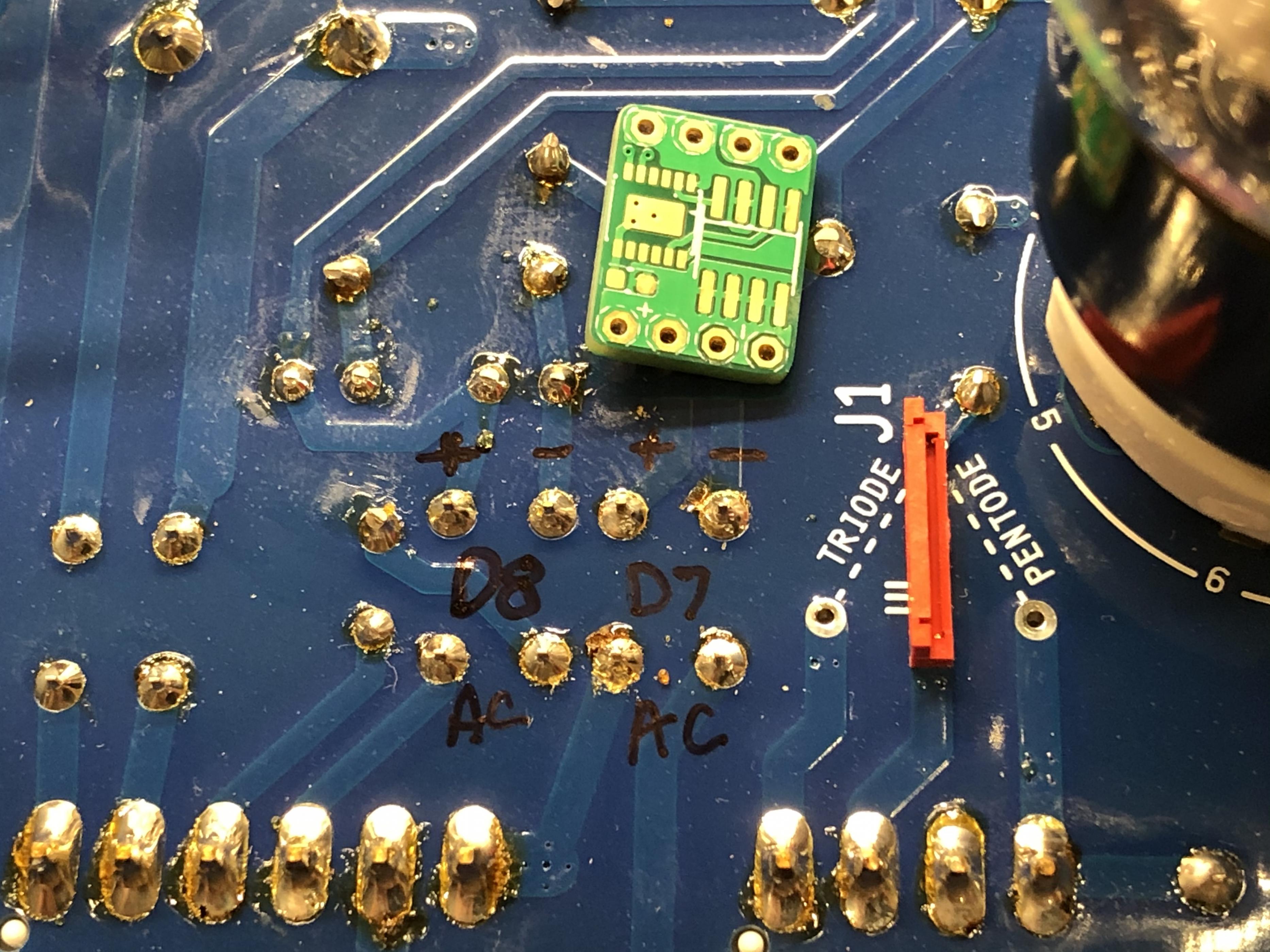

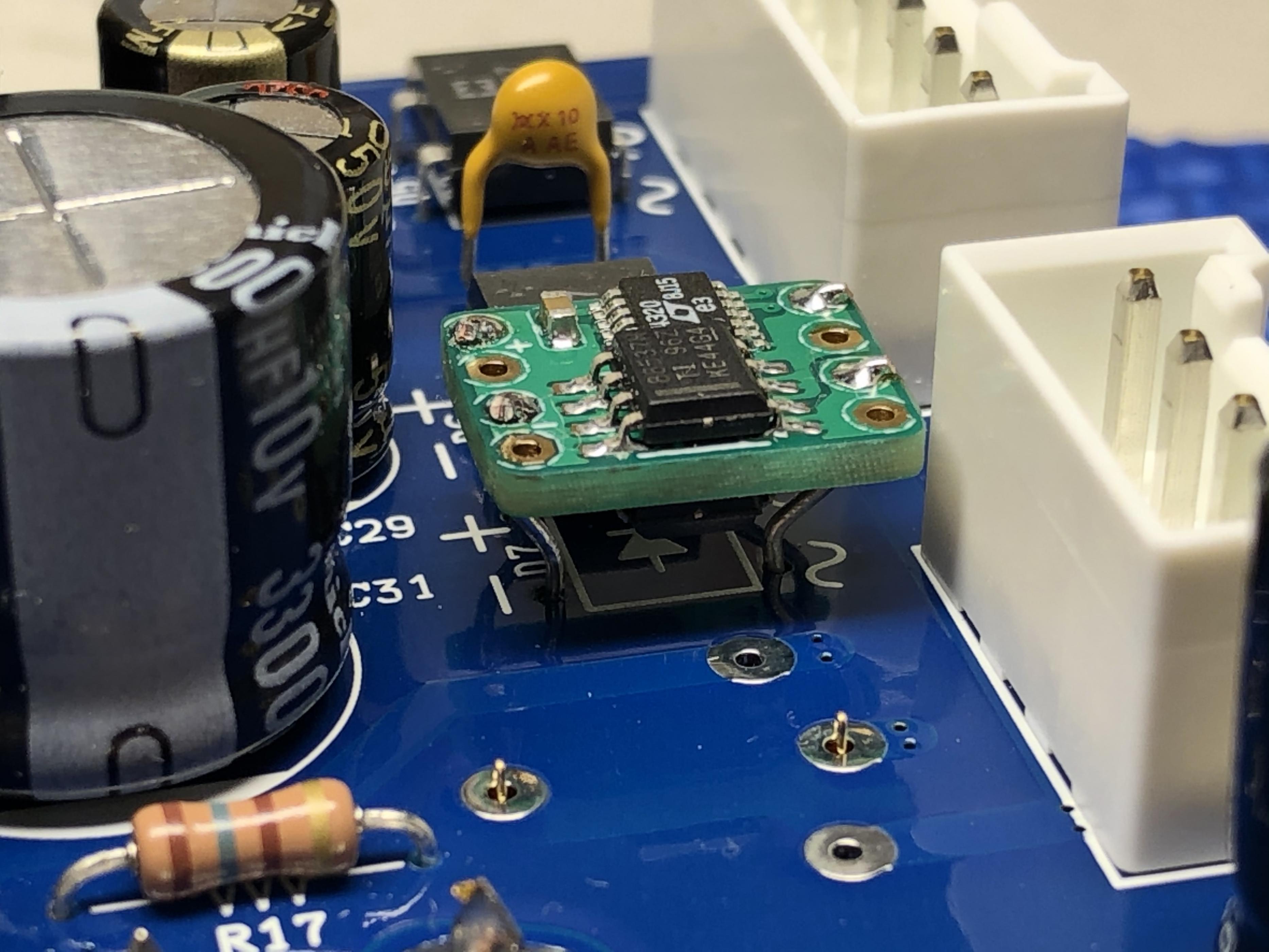

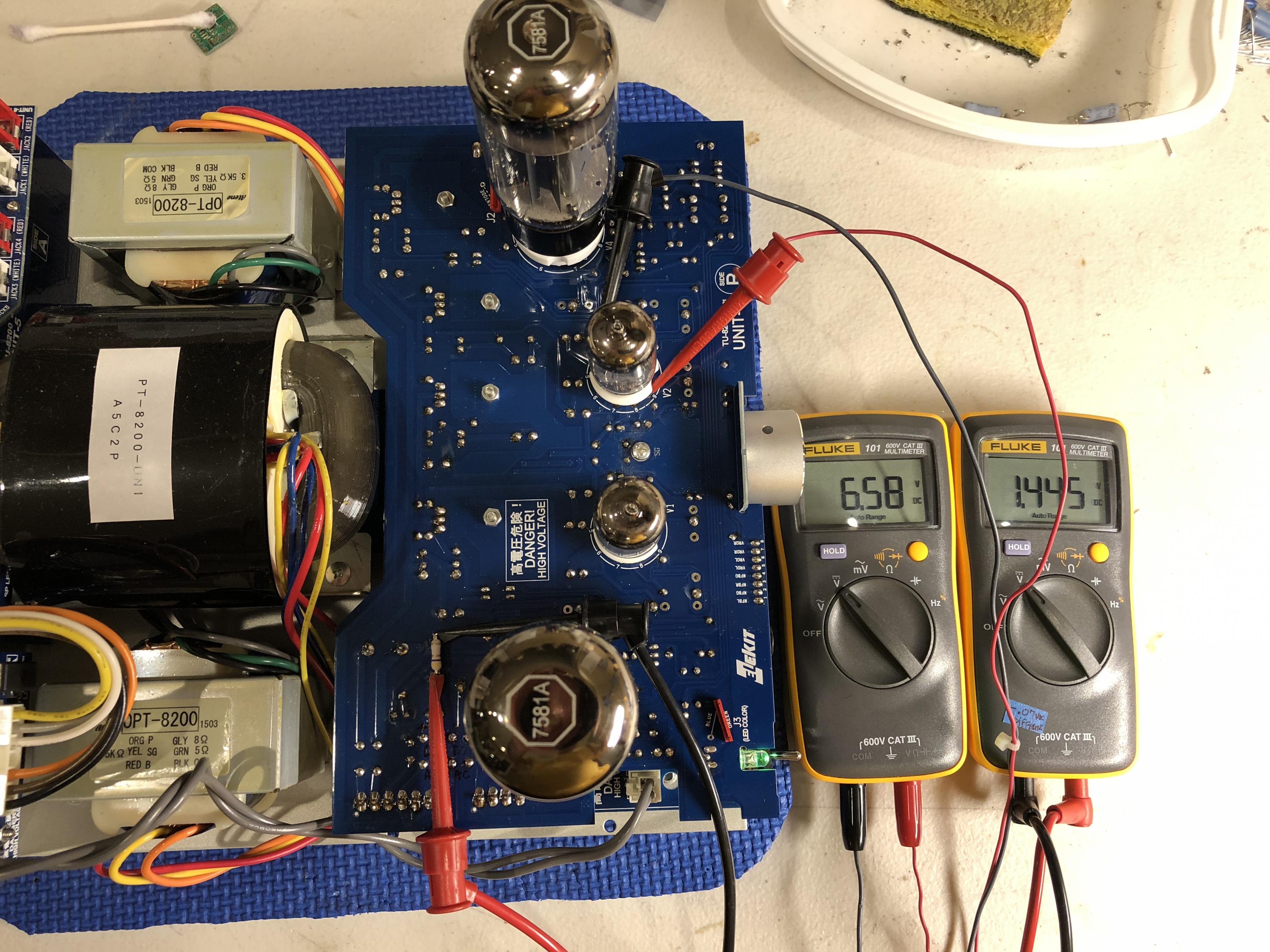

I opened up my TU-8200 today and checked the driver tubes heater voltage, it is indeed low at 5.8vdc. I’m going to replacing the BD107 with an LT4320 active bridge, that should pick up “free” voltage. If that is the case, I can keep R64 intact. If the voltage is too high, I’ll increase R64 to compensate.
The LT4320 pcb is very and will mount on the backside close to the red jumper.
Hmmm.... I referenced the LT4320 datasheet and 7vdc output is low for this device. This will truly be an exploratory surgery. I will continue, worst case, I must install another DB107.

I couldn’t wait for the other part to be delivered so I worked on the D7 rectifier replacement. The DB107 was removed and replace with an LT4320 ideal bridge. I soldered up the few SMD parts required and used some resistor cutoffs as legs. It fits very neatly in the original DB107 location.
Voltage at the tubes was 5.8vdc, after the rectifier swap it is 7.7vdc! Almost 2 volts were gained. Yes, way too high now, I removed the R64 0R47 resistor and installed a pair of parallel 4R7 1W resistors. Now I’m at 6.5vdc, just about bang on. I’d say the first upgrade was successful.
I know this is probably over the top replacing a $0.40 part with a $10 bridge, but it’s the fun of DIYA!! 😀
