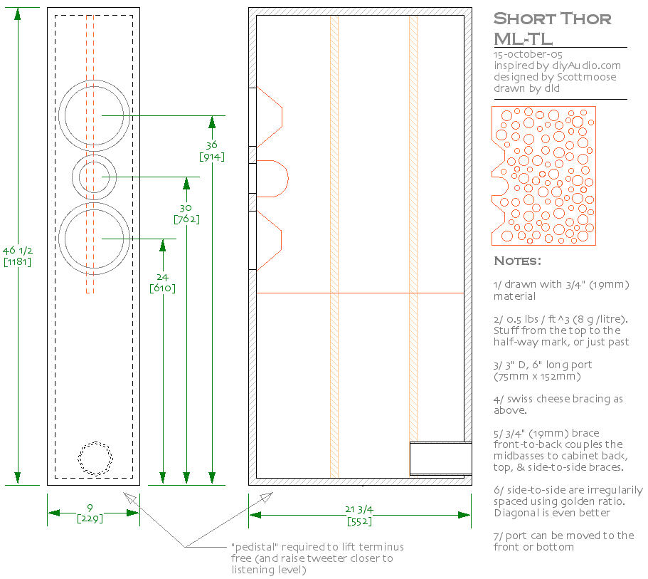

Short Thor is also on that thread -post 122. I've attached Dave's drawing of it. Small THor has not yet been drawn -it's in the waiting list for Dave's Thor Revisited article I understand, but it's dimensions are described in post 231. It's 48" tall, 7.5" wide x 10.5" deep (internal). The tweeter centre is 12" down from the top of the line. The port is on the front panel, 3" diameter, 4" long, positioned 4" up from the internal base. Stuff 0.35lbs ft^3 from the top to 20" above the internal base.

Small Thor Drawings
Hi guys, I am new to this forum so please bear with me, I have read much information about Thor projects. I recently built a pair of Odins my first pair of speakers 🙁 I would like to give the Thor a try and I am looking for drawings for the small Thor, if any body can help, it would be greatly appreciated
Post 296 on this page, in the middle
Here you go. I built the short thor and am a big fan - though I haven't heard the "small". Let us know how it goes!

Hi guys, first of all thanks to Patric again for help with Small Thor drawings.
Again I hope somebody will be able to help with my question. As I originally intended to build the SEAS Thor I purchased 25mm A-grade plywood, which I would now like to use for the small Thor, which is designed, around 19mm material, herein lies my query: Scott and Dave have designed the Small Thor to be nine inches, across (external dimensions) using 19mm side walls, this is in keeping with the original Thor dimensions, however D'Appolito uses 25mm side walls. Resulting in an internal dimension discrepancy of half and inch or 12mm aprox. Yes I can simply apply the extra 12mm to external dimensions in so doing keeping internal the same as Scott and Dave's Small Thor. However I am trying to keep the speaker as slim as possible. So can somebody tell me what sort of results I could expect from reducing the internal width down from Scott and Dave's model and or can this loss in volume be added to the rear of the cabinet?
Many Thanks
Niall
Many Thanks
Niall
Ed LaFontaine said:Yes, adjust the dimensions to maintain volume by increasing the depth.
What mongo says -- personally i'd just make the box 14mm wider...
dave
IF you choose to make the box wider, consider an increase in the edge radius. My simulations in EDGE show that the required baffle step stays about the same...but the resultant output contains fewer ripples and less p-p magnitude of the ripples.
