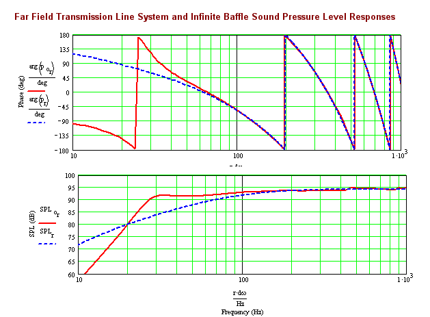

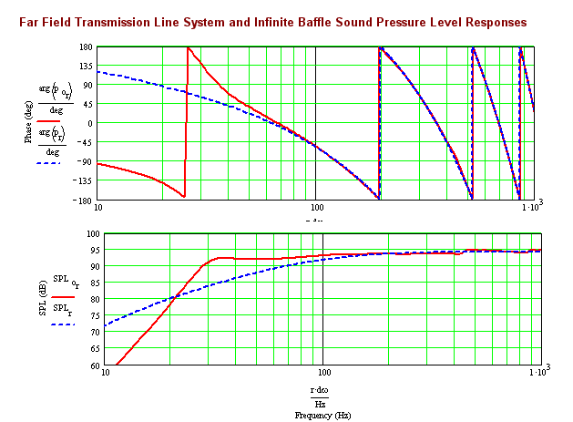

The two graphs to watch are the Far Field Pressure Level response, and the Woofer and Terminus Level Response. This last one is the most useful in trying to see the interaction between port and driver.
Having set up one set of values to give you a set of graphs, look at the curves and decide which value to change next, eg port length.
Go to the start and enter the new length but do not press enter. Scroll down to the Woofer and Terminus curve. The curve will not have changed from your original entry. Watch the curve.
Now press enter and the curve will jump to the new port lenth value. This way you can more easily see the difference the new value makes.
Excellent point! I forgot to mention that (where's my memory juice?) -it's well worth doing, and much, much easier to spot subtle variations by doing it in this fashion.
