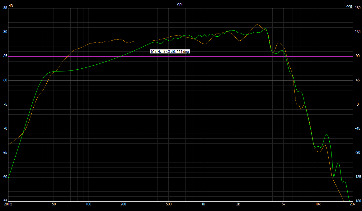

Here is what Troels has put forth as driver response in cabinet without crossover:
For a comparison, simply trace the manufacturer data, apply diffraction simulation and box model to get an idea of what to expect. The mid-bass deficiency is obvious, and the attached image shows exactly this, Troels measurement in orange, and something resembling what you should expect of an in-cabinet measurement is in green.

I don't really know how Troels measures his loudspeakers, it's kind of strange that there doesn't seem to be any bafflestep indeed?
That being said, in passive filters one can sometimes get away with a 2nd order filter that does kind of do a bafflestep at the same time.
Tracing manufacture data (hoping it has been measured in inf baffle) is a very handy trick yes.
I do it quite often to get a very rough sense how a certain speaker will perform on a certain baffle.
The bafflestep itself is pretty predictable.
One only has to be careful with diffraction, which is a lot more difficult to model.
(in many cases close to impossible)

Troels’ strength is his experience and prolific number of designs for all sizes.
But at the crossover frequency I don’t see a problem.
With this Troels design in particular, there absolutely is "some" BSC from a shallow filter rolloff, but probably not enough.
To me this isn't bafflestep compensation proper but just him compensating for a high frequency rise in the woofers response. This is something the PTT6.5 exhibits mildly anyway.
Yes you could say the end effect is that it gives the speaker a mild amount of effective BSC but this is more a matter of circumstance rather than by design.
In Troels' original measurements he's clearly neglected to take into consideration the effects of baffle step. If he had added in these effects, as you have in your graphs above, then I would say it was by conscious design and decision. In other words he was aware of the phenomena, had taken it into account in his measurements, and has then chosen, specifically, to only apply 0.5-1dB of BSC. But this is not the case.
