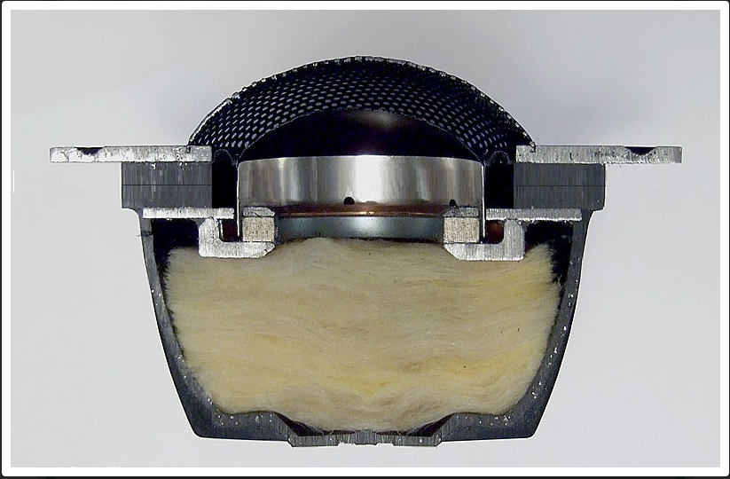

On another note. Just took a look at the Dayton RS52AN-8 (2in). If limited to 800-3000Hz, the distortion is down at -55-60dB. Does who have used it and measure it report that it is transparent and revealing. If the SBA 2.5” MD60N-6 midrange appear in a test, it will be interesting to compare them two.
I can see some improvements being made in the distortion department by adding an absorption tube just like the MD60N-6 uses.

So what I imagine here is that if the back-wave is allowed to travel in a cone shape absorber, one might control the reflections better. The question is if that absorption amount (wool) is enough as is.
I have yet to experiment with this but I think its an exciting idea. There might also be an issue with the "shelf" one can see close to the voicecoil which might cause some internal reflections.
This is something Laurence Dickie have explored extensively and SB Acoustic is employing it in their new 2" midrange.
I am currently working on two back chambers for a small ribbon used above 1kHz. One is a "transmission line"? style similar to the SB dome. The other is a simple box. The long tapered line has the smoothest response and is used as the test standard in attempts to get the box to work as close to the lines performance as possible.
I dont measure any significant distortion improvement from the line( the box is much larger than typically seen in commercial ribbons so thos may be why?) BUT it is easy to get a smooth response from it compared to a box.
A tapered horn/waveguide is always better than a straight pipe. Not only that, but any room, enclosure and encapsulation will have reflections and standing waves.
The more you absorb the cleaner the distortion will be. This was proven by Bell Labs in the 30's 🙂 and just like a 90 degree cabinet has diffraction, this pattern also exist inside drivers.
I did many the same experiments and didn't notice improvements in THD tooI dont measure any significant distortion improvement from the line( the box is much larger than typically seen in commercial ribbons so thos may be why?) BUT it is easy to get a smooth response from it compared to a box.
THD, distortion, reflections etc. come from many sources and if we can address one or a few of the many issues a driver might have, I am all for that 🙂
