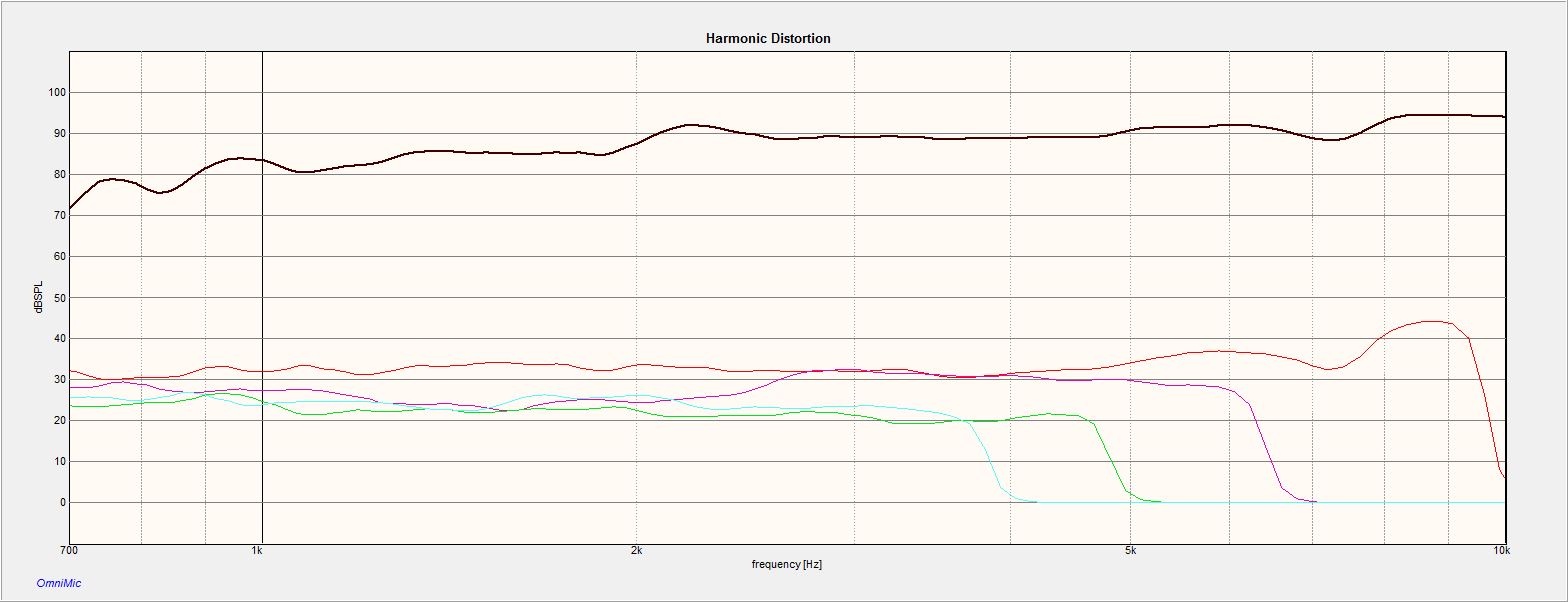

yes I understand
it is a good one for sure. The design is unique, well executed, and it does allow a lower crossover in a small ribbon.

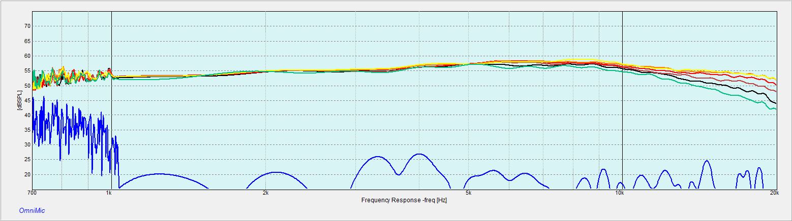

I have however a design that pushes the crossover and the distortion numbers even lower in a similar size ribbon

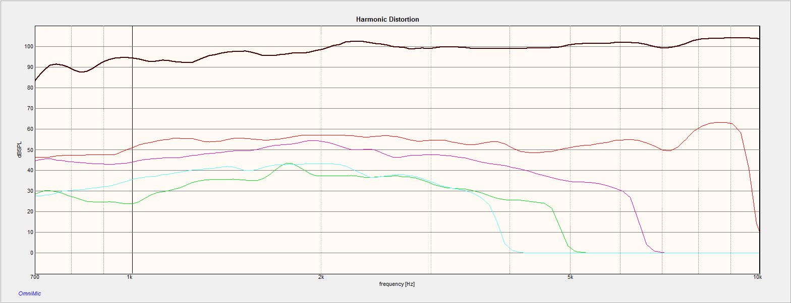

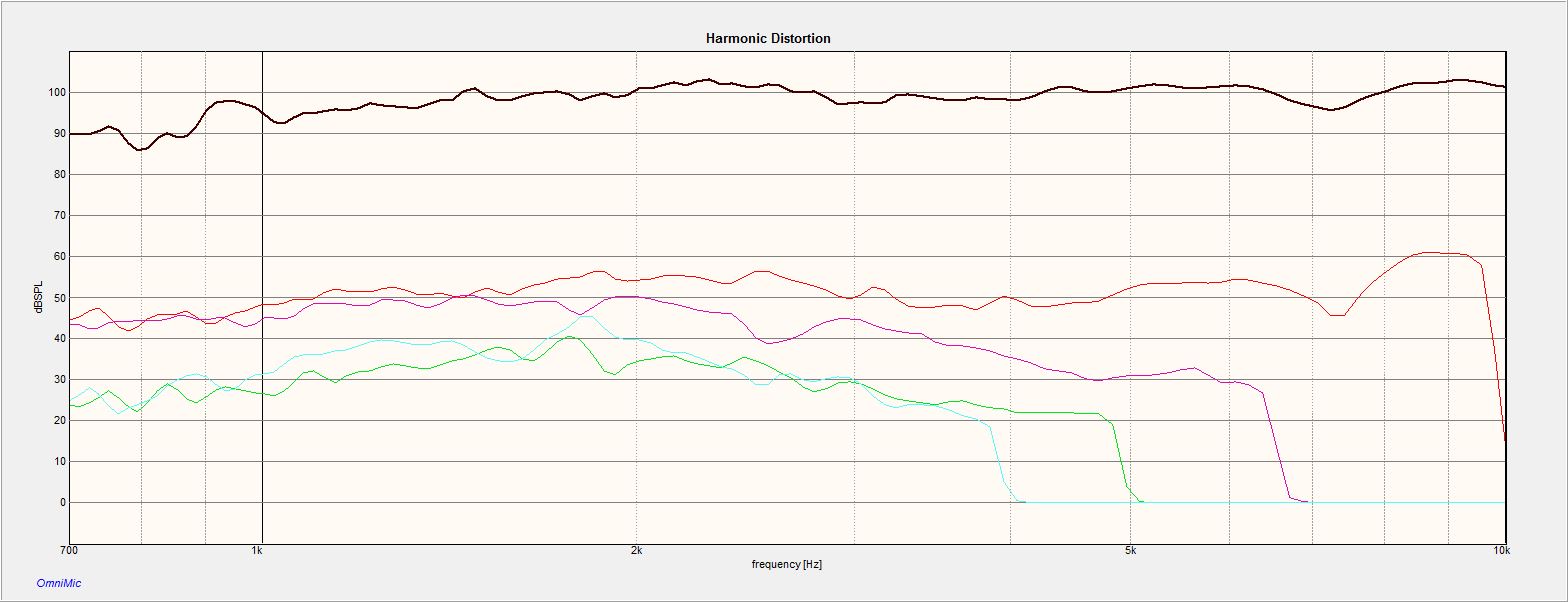

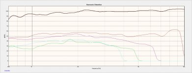

1st pic is at 90 db, 2nd at 100 db, 3rd 100 db with wave guide, all at 1 meter
all with a 12db/oct crossover at 1 Khz
ribbon is a free swinging design ( no side suspension/termination) 16mm wide by 75 mm long

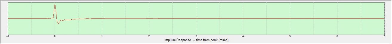

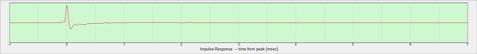

Ah, i don't believe in comparing drivers measurements in different conditions and systems, and i really don't trust distortion measurements done with Omnimic software. Software wise, STEPS or REW are the ones i do believe give good aproximation of distortion profile.
Also, it is not similar size ribbon. SRT-7 has Sd=7cm^2 and your ribbon (16mm x 75mm) has Sd of 12cm^2. That is 70% increase of ribbon surface. So even if it has lower distortion than SRT-7, it should.
I'd love to see your ribbon tweeter in Yevgeniy's hands so we could really compare the two tweeters. Not just to compare distortion but sensitivity, linearity of frequency response, resonances and off axis performance. And i'm not saying this in any negative way. I'd really like to see more planar tweeters with good distortion profile because i think that principle was left behind for too long and now with better materials and software it can maybe even surpass the ubiquitous dome.
yes, those are good points and I agree on the Omni mic and of course different systems and environments etc. Comparison is almost pointless. No negative taken.
Any confidence I have with my measurements come from measuring other commercial ribbons/ planers with this system, ( RAALs, Fountek, Arum Cantus,BG , then comparing to published reports and my own prototype work building copies of them all. While the Omni is not at the level of the systems you mention, I believe I’ve had enough comparative data over the development period to make useful conclusions. It’s not a high-end measurement system but you would be surprised at its usefulness if used this way.

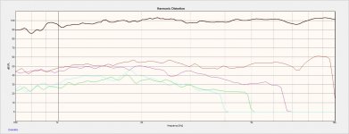

Also, your right, the ribbon I posted data from is not exactly the same size as the STR-7, However my 16 x 50mm long version shows similar perf to the 75 mm long version. Not as good BUT surprisingly close. Also take note specifically of the distortion profile below 2 kHz. A significant reduction in distortion below this line. Above this freq. the distortion is no better than present offerings but the issue with most ribbons isn’t above 2K, its below that. This was the intent of the design, to reduce distortion below 2k and increase motional control/ reliability so can use a lower and less steep crossover than typical ribbons. And then of course as you rightly mention off axis perf tells much. One of the biggest hurdles was getting diaphragm behavior right so that off axis response was perfected. See pic 0-60 deg at 1 meter

In the end I concluded, with a free swinging ribbon structure moving air anyways, that a great pulse/ CSD was far more important to the ear than a little extra distortion. It was that diaphragms measured behavior that I now use as a reference in developing the ribbon I talk about here recently. Eventually I came up with a construction that comes very close to it but doesn't tear itself apart in use.
