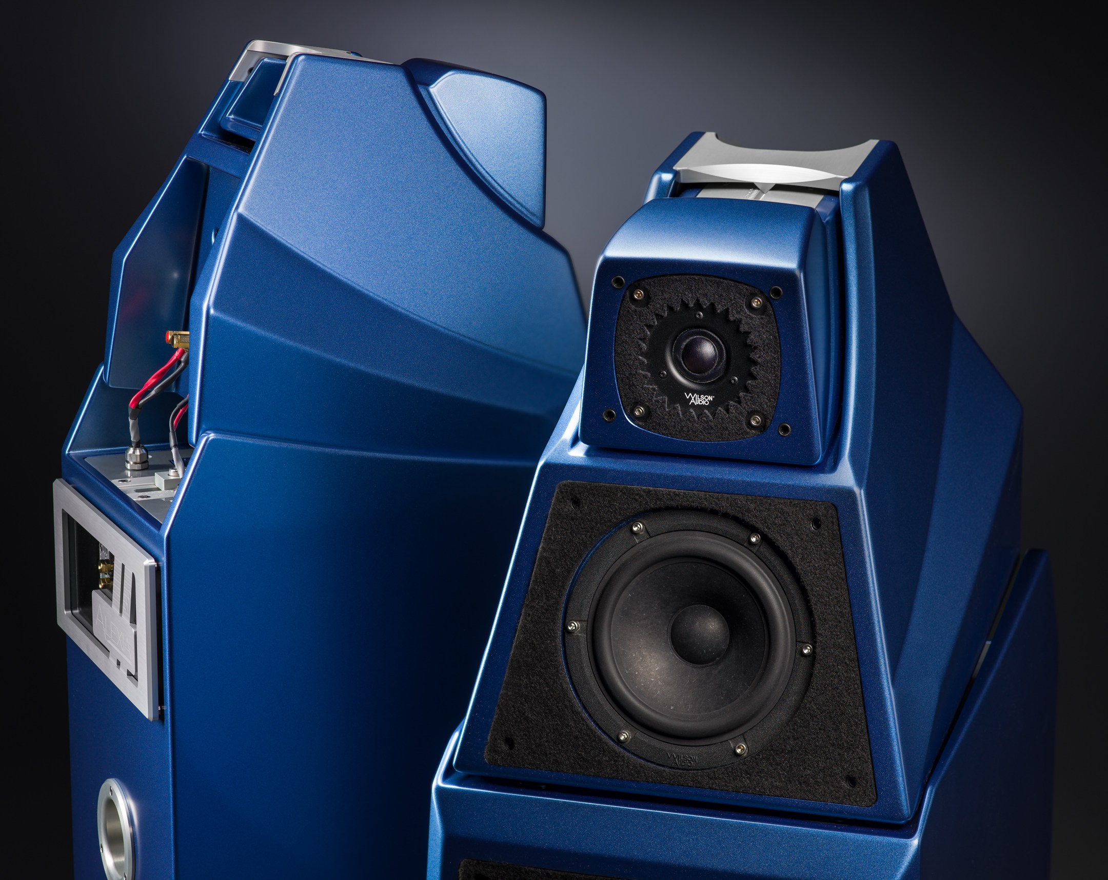

-look at a lot of Wilson Audio designs. Most (over their product grouping) have a 6-7 inch paper woofer (mid-bass) as a midrange driver that's ported. They place quite a bit of emphasis on clean (lower non-linear distortion) in the midrange for a higher dynamic range, while being far less concerned with narrow-band linearity.
I listened to Wilson Audio Alexandria XLF, Alexx, Alexia, Sophia 2 and Sasha Daw and only the last one have problems with the midrange shouting. I noticed it in two different setups and rooms.
