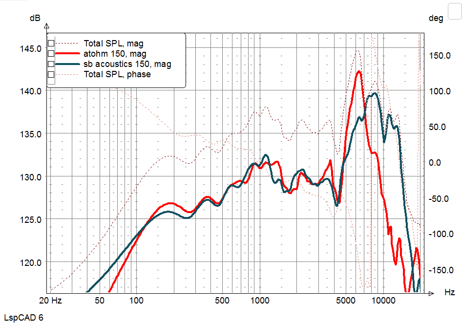

Measurements: Note!!!! Read data of ATOHM LD 150 CR04 only as reference to SB 15NRXC30-08 that both were measured in same box and conditions :
SPL Note Atohm spl was recessed by 3db because it has higher sensitivity than SB by 3db for the same voltage input. This was done for better comparison.

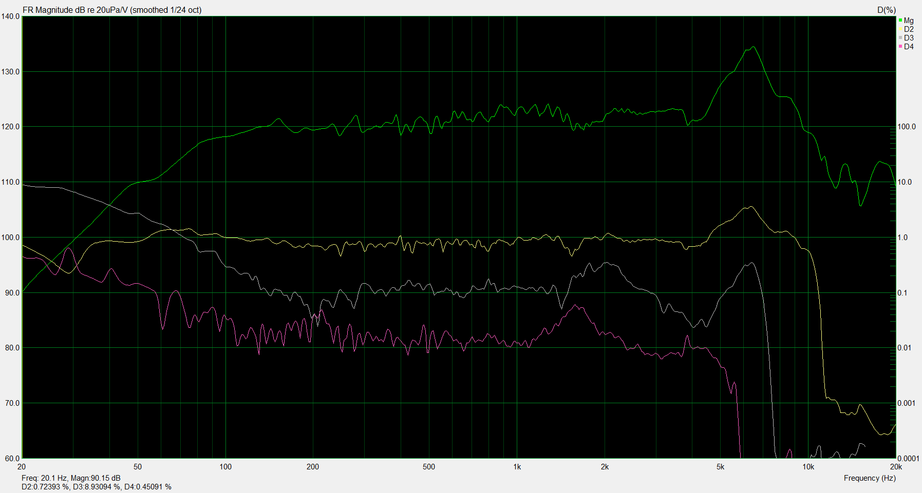

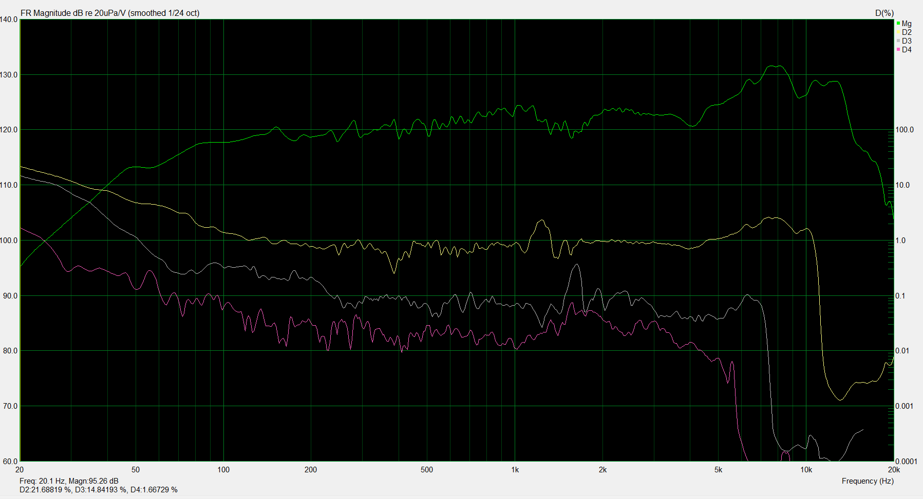

Distortion in percent of Atohm LD 150 CR04 (missing f5 component)
Distortion in percent of SB 15NRXC30-08 (missing f5 component)

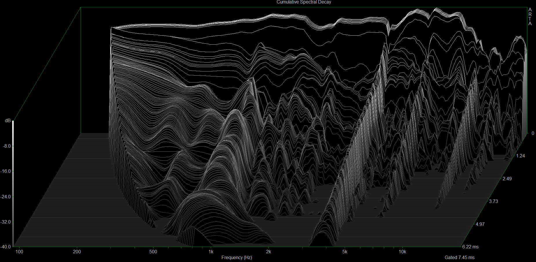

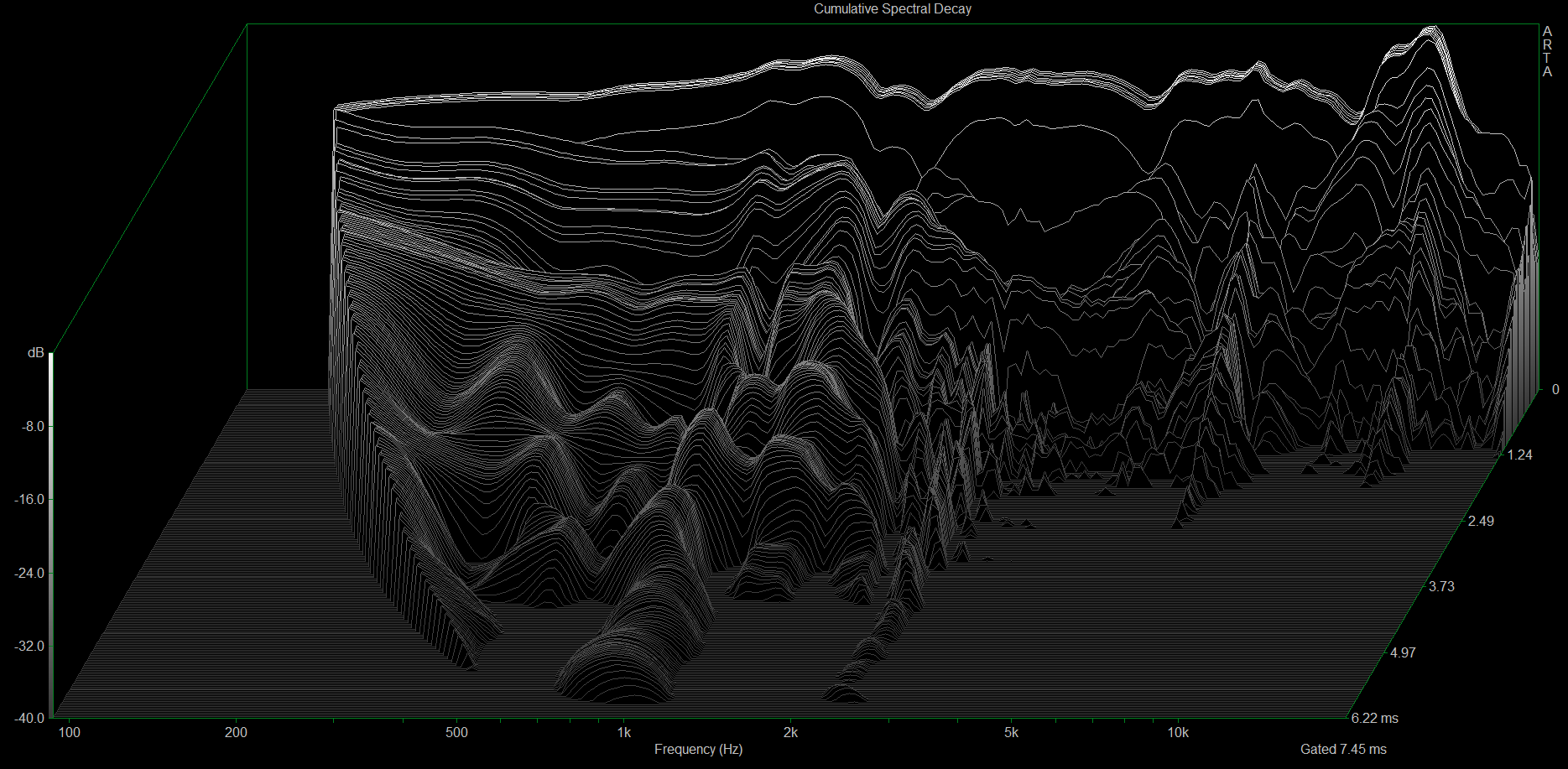

CSD of Atohm with a notch filter 6.3khz 12db q=4 taking the peak off for making the opportunity to see full csd window below useful 3khz (that is not possible with peak present)
CSD of SB with a notch filter 8khz 12db q=2 taking the peak off for making the opportunity to see full csd window below useful 3khz (that is not possible with peak present)

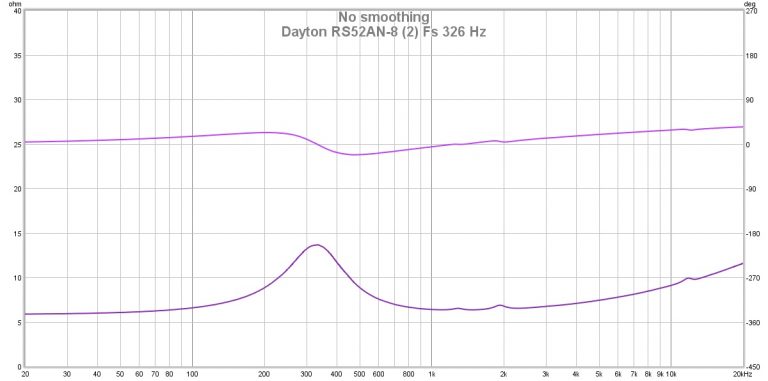

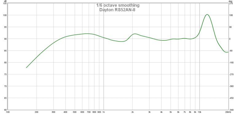

The measurements of the Dayton Audio RS52AN-8 midrange have been updated:
Dayton Audio RS52AN-8 | HiFiCompass
I don't know of better driver from 1000-3000Hz when it works properly. Shouldn't be used out of that range in my opinion. Here are measurements of few pieces from European batch:
I don't know of better driver from 1000-3000Hz when it works properly. Shouldn't be used out of that range in my opinion. Here are measurements of few pieces from European batch.
