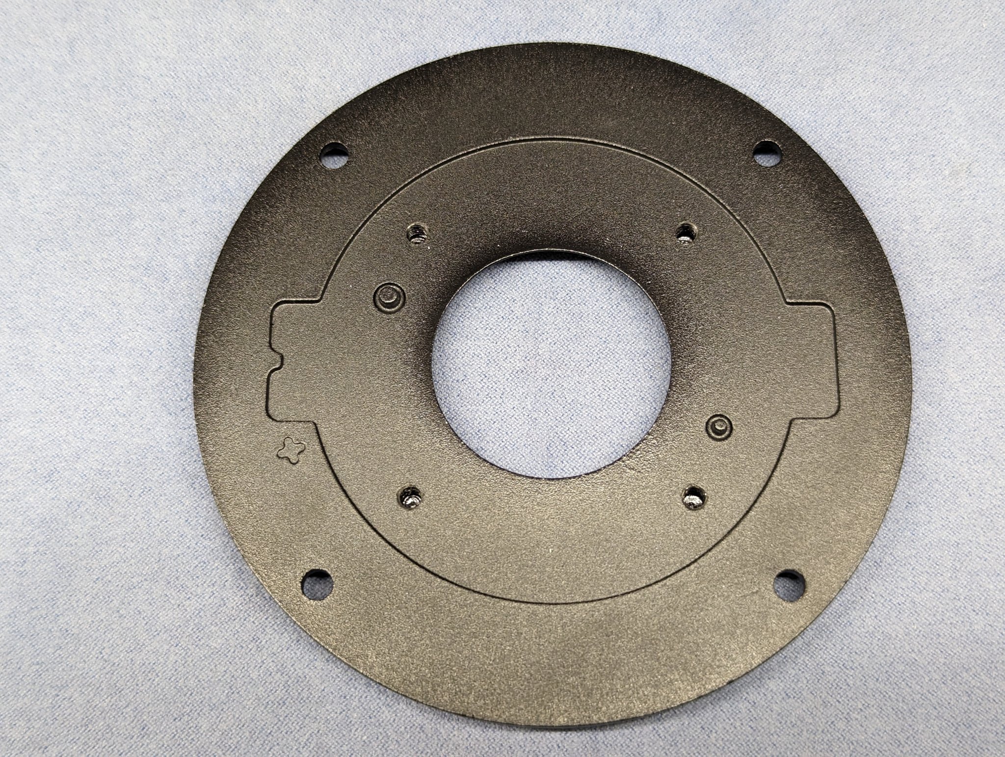

@HiFiCompass: thank you for the measurements. I see you dismantled t29x. The faceplate is removable. Are faceplate and dome assy one piece? I just want to check if this tweeter could be mounted to Jantzen wg, same as T35.
I really don't understand this faceplate with this "micro waveguide".
It's deep so you have problems >20kHz but small so it doesn't do anything in the 2-3kHz range. It just makes things worse?

WG is small to provide any directivity control at 2k, true. And I do not think Seas intended to make so.
Many tweeters with flat faceplate have troubles in ~ 4-7k area, still very wide directivity and often create mild power response bump. This seas solution might improve this a bit. Similar to wavecor and morel.

I've noticed that quite a few tweeters use a deeper but small WG. I think that's a crutch to boost extreme top end output by operating in a cavity resonance mode. This causes alot of abnormalities ie. notches, peaks, FR wiggle above 10k. It also can create stored energy problems. Morel does something similar with their IDR faceplate design. The diffraction will create more output above 10k and mimick a wider dispersion behavior, but it ruins transient response and produces early reflections slightly off axis. I really like alot of Morel domes, but that IDR lense thing isn't that great IMO. I usually replace those with flat faceplates.
