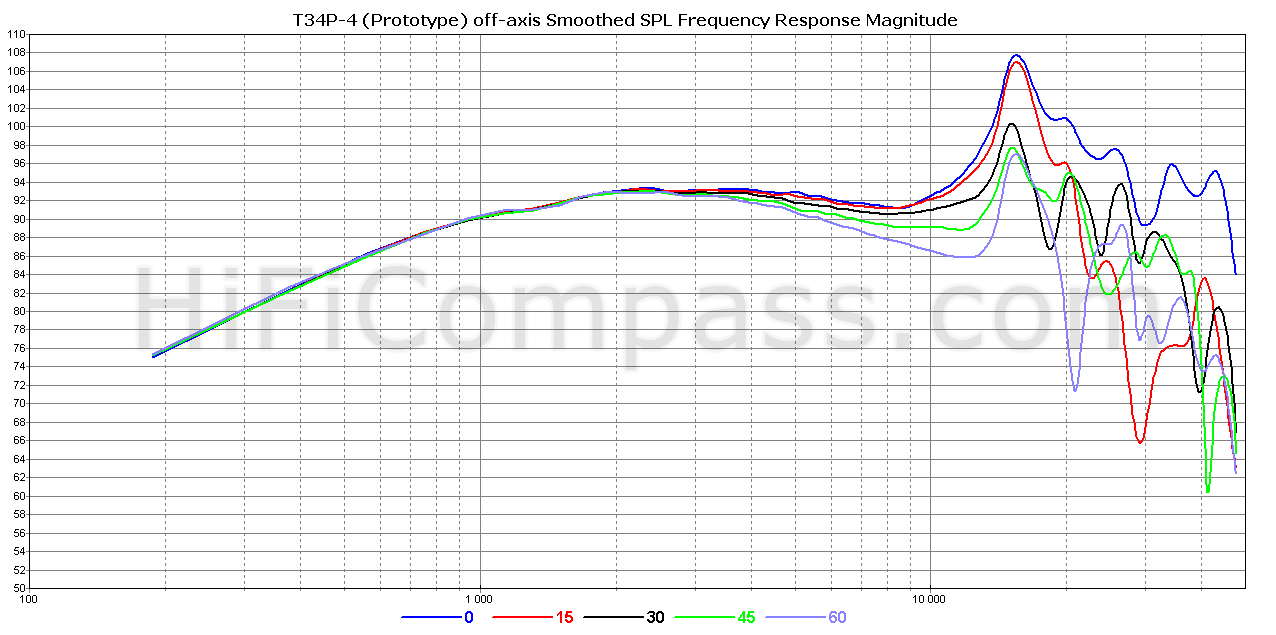

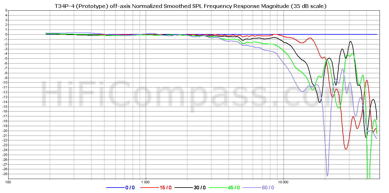

BlieSMa T34P-4 paper dome concept-tweeter:
https://hificompass.com/en/news/measurements/bliesma-t34p-4-paper-dome-concept-tweeter
Thanks for a great review, @HiFiCompass. Out of interest, what do you use for DSP corrections when doing your listening tests?
Will you try a passive trap circuit to tame the resonance? It should have benefits in reducing THD of harmonics of the resonance compared to active EQ.
This tweeter should be "bundled" with a fitting passive circuit to get it at least somewhat linear.
But that's not my cup of tea - I will stick with Beryllium 😉
For some reason my work computer has never allowed me to connect to HiFiCompass's site. Can someone post the response plot for this new paper T34? I've actually been wondering about this possibility since they came out with mid. Seems like a cool idea.
I have to say, I am more in love with the T34A... But with a PEQ of -12 dB at 15k, this paper version might work out well...
So, the P-4 is not doped/coated at all? It reminds me visually of the Philips AD0210/SQ4 pair of 'felted' paper mid domes I have, and those aren't doped either. I honestly feel at least a doping of the tip of the P-4 should be required for best top-octave performance.
Over the years I experienced with my tests that I prefer tweeters with their resonance as far out of the hearing range as possible (Beryllium) or with no resonances (ring radiator). That's not a tweeter for me I'm afraid ... 🤓
Even after correcting for it with a series notch filter?
I wonder what mechanism(s) are at play here.
