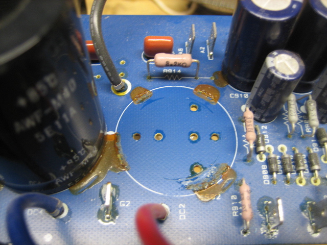

BTW, does anyone know what this brown dried up goo is on the power supply boards? Its pretty much under each electrolytic cap on the power supply board.
To me it looked like it was a leaking Electrolytic cap but upon removing one of those caps, it does not look like it coming from the cap.
Here is a photo or two to show what is going on.
That goo is an adhesive they use to attach the caps to the board. My PS board also had the goo. Your board is a different version than mine. My board is green where yours is blue and yours offers the more flexible 22.5mm LS 4 pin in addition to the 10mm LS 2 pin capacitor mounting configuration. This is a good thing because I just realized the 47k uF caps I linked to were a 4 pin 22.5mm LS like the ones your board has. When I did my search at Mouser I picked 10mm LS as one of the search options, I guess that 22.5mm LS cap got added to my search for some reason. Anyway, they'll work great for you. Anyone that reads this and is thinking about purchasing those caps you need to turn your PS board over and verify whether your board uses a 2 pin capacitor or the more flexible 2pin & 4 pin capacitor mounting scheme. If its the 2 pin only then you will have to find a 35mm diameter X 10mm LS 2 pin capacitor. As stated earlier, the color of the board may denote which version it is as well, but you cannot rely completely on that.

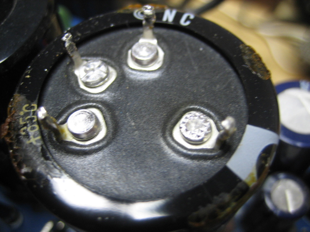

Prob old PS caps.
Connect amp to cheap test speakers. Take off the cover and give the 2 large PS caps on the humming channel a whack to see if the hum changes. If it doesn't change, pull all 4 rail fuses, and then measure the PS ripple in mVAC on the 4 rails for the output stage (and the 4 rails for the input stage, for reference). Don't cause a short. If one has much higher ripple than the others, then it's prob a dry PS cap.
Thanks for the advice. I happen to have a 6 inch driver from an old speaker with no enclosure or xover. Would that work for the test? If so it should be dead quite connected to the left amp output and humming when connected to the right output. If that works then I could try whacking the right side PS caps.

They are soldered in! See my post #24. Just be careful with those old posts as we were talking about lowering the rails and using 35vdc rated caps. The original main PS caps are 63V rated and my rails were about 61V under load so these caps do not have a lot of headroom. You might want to see if you can move up to a 75V cap. There is a lot more height available so you may find some tall replacement caps, a bit more capacitance wouldn't hurt either.

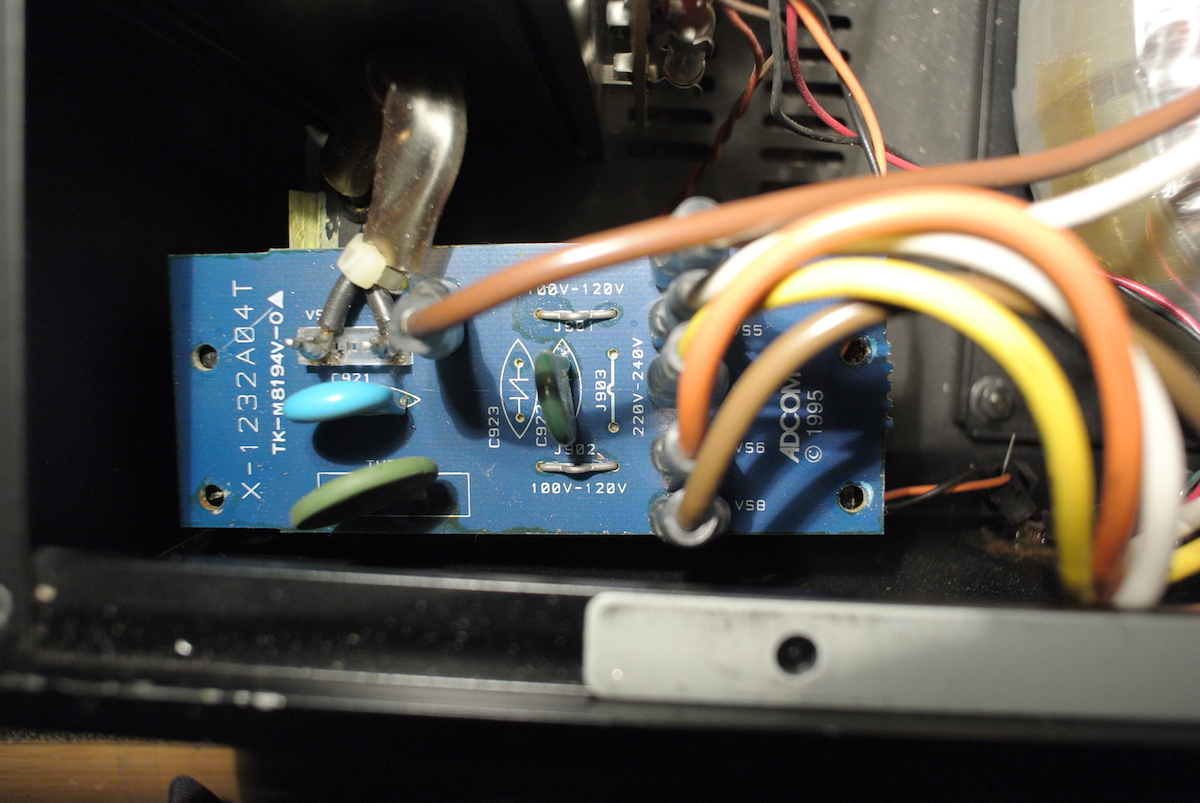

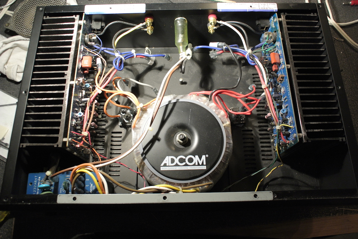

Hello Folks - resurrecting an old thread about modding an Adcom 5400.
I had to step away from the whole DIY thing for quite awhile and now am back
warming up the soldering iron trying to finish up the first mods to an Adcom 5400.
I am going the half voltage route to reduce power dissipation to effectively make the heatsinks bigger.
So I just soldered in new power supply caps (47,000uF @ 35V each) and the next step is to put the
primaries of the transformer in parallel to lower the rail voltage out of the secondary of the transformer.
Before I go ahead and do this, I'd like to ask, how is that best accomplished?
Here are three photos, first one showing the version of the amp I have.
Second one shows the voltage selection pc board where I believe the changes need to be made.

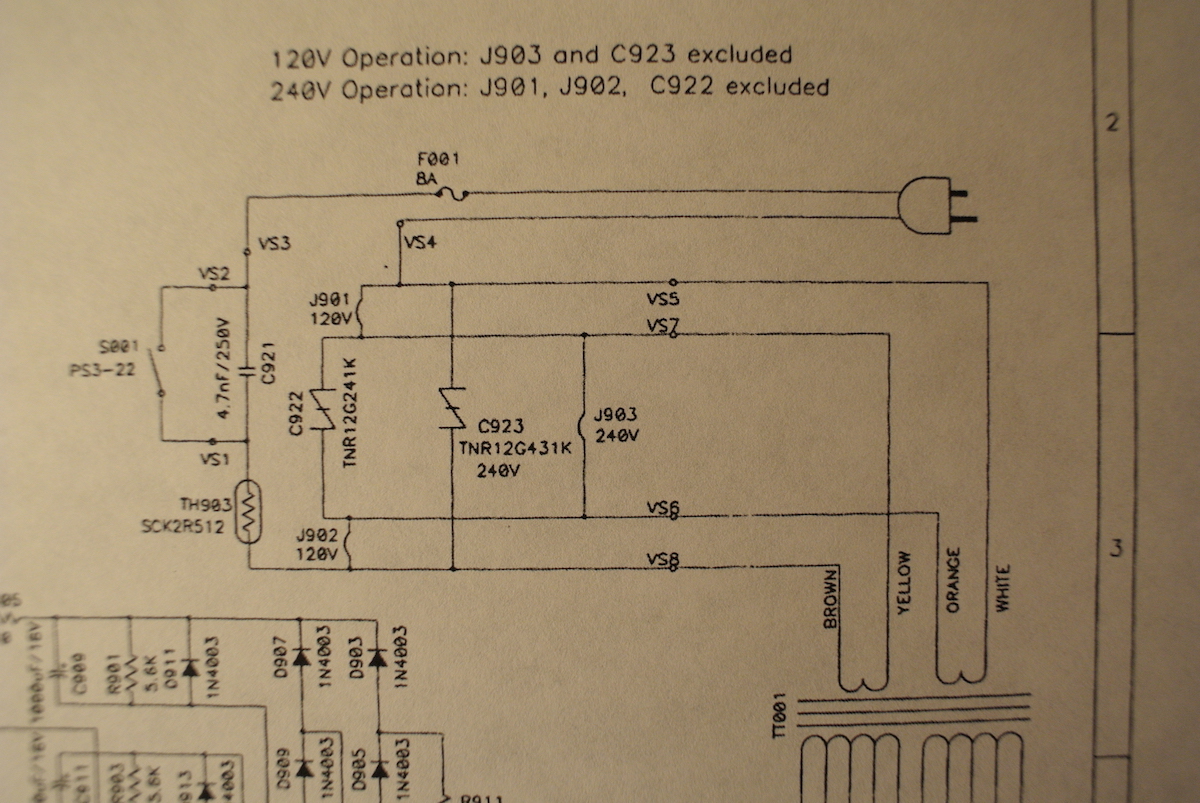

Third photo is of part of the power supply schematic that I have for reference.
I dont know if this schematic is actually for this version of the amp (schematic says Version 1 in the title box)
and thats why I am a bit hesitant to proceed without help.
It looks like all I need to do is remove two jumpers and add another.
Plus remove C922 which quite frankly, I dont know what kind of device that is.
To finish the conversion, I guess I need to add C923 which is different than C922.
Anyway, log post here, sorry. Any help, greatly appreciated.

Does anyone know what devices C922 or C923 in the schematic in my post just above are? I have no idea what they are.
C922 is present as the amp is set up for 120V operation.
For 240V setup C922 gets removed and C923 is installed instead.
Problem is, I do not have that that part and need to identify it.
Anyone know what they are?

Edit - got it figured out, the item in question is a metal oxide varistor (MOV).
Its purpose is to shunt unwanted transient voltages away from the circuit it is installed in.
It is a protection device.
Curt

Doesn't wiring the primaries in series effectively halve the VA rating of the transformer?
If we are just doing that, then there is no problem since all we are doing is reducing the amplifier's power.. but making the thing class A and ramping bias up might get you in trouble.

That IS the answer, sort of.
Like ZM said, without saying; if the traffo is overbuilt with a larger than necessary core and with secondaries that are over sized then all is well.
But if the secondaries are rated to deliver, say, 10 amps at 40 Volts - then they are still only rated for 10 amps at 20 Volts. The wire is still the same size.
VA = V x A
