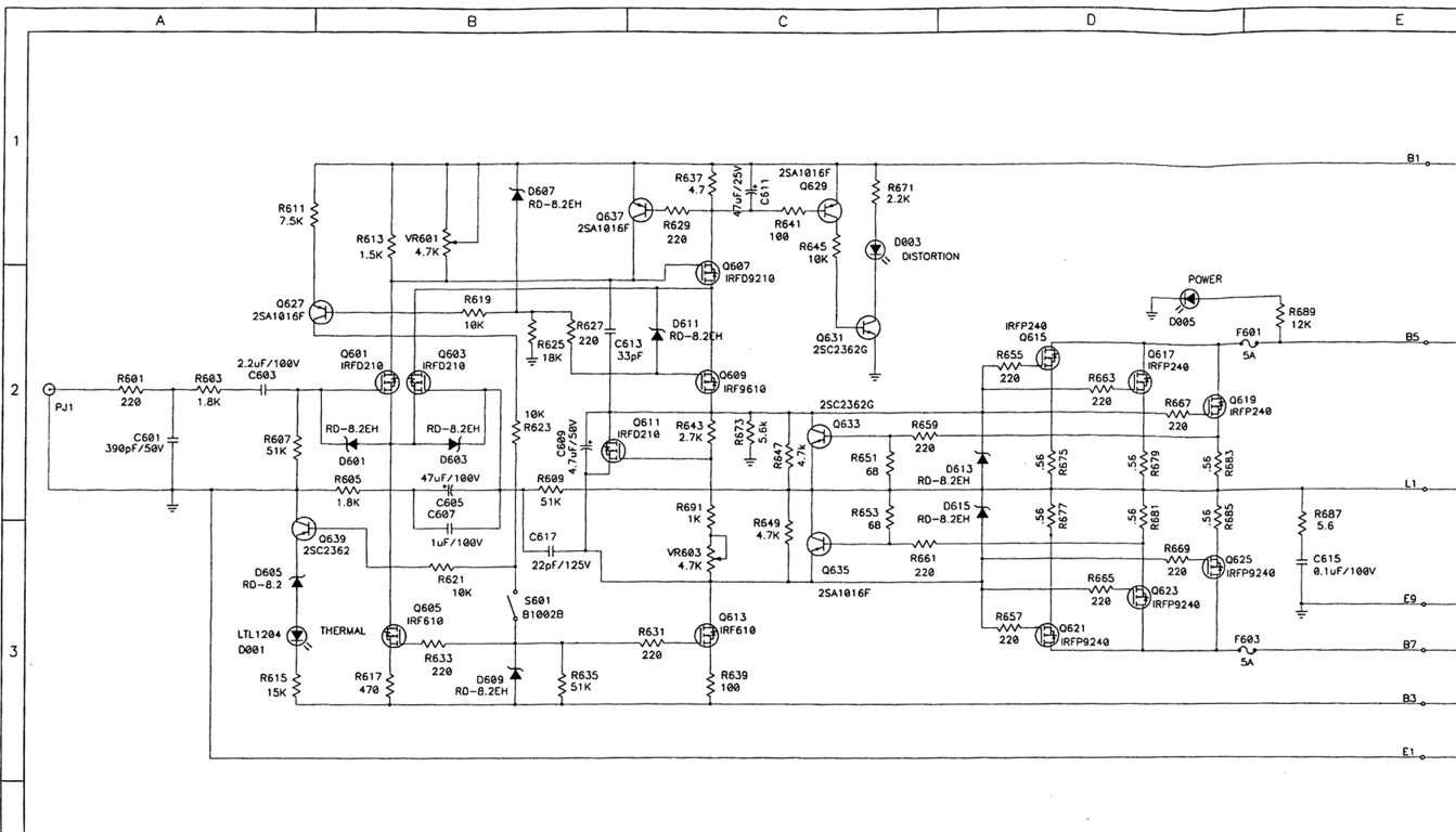

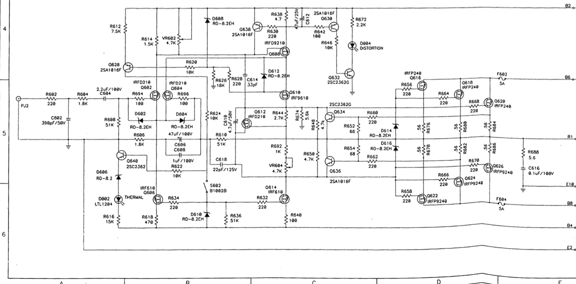

Here's the schematic for the L channel of the 5400:

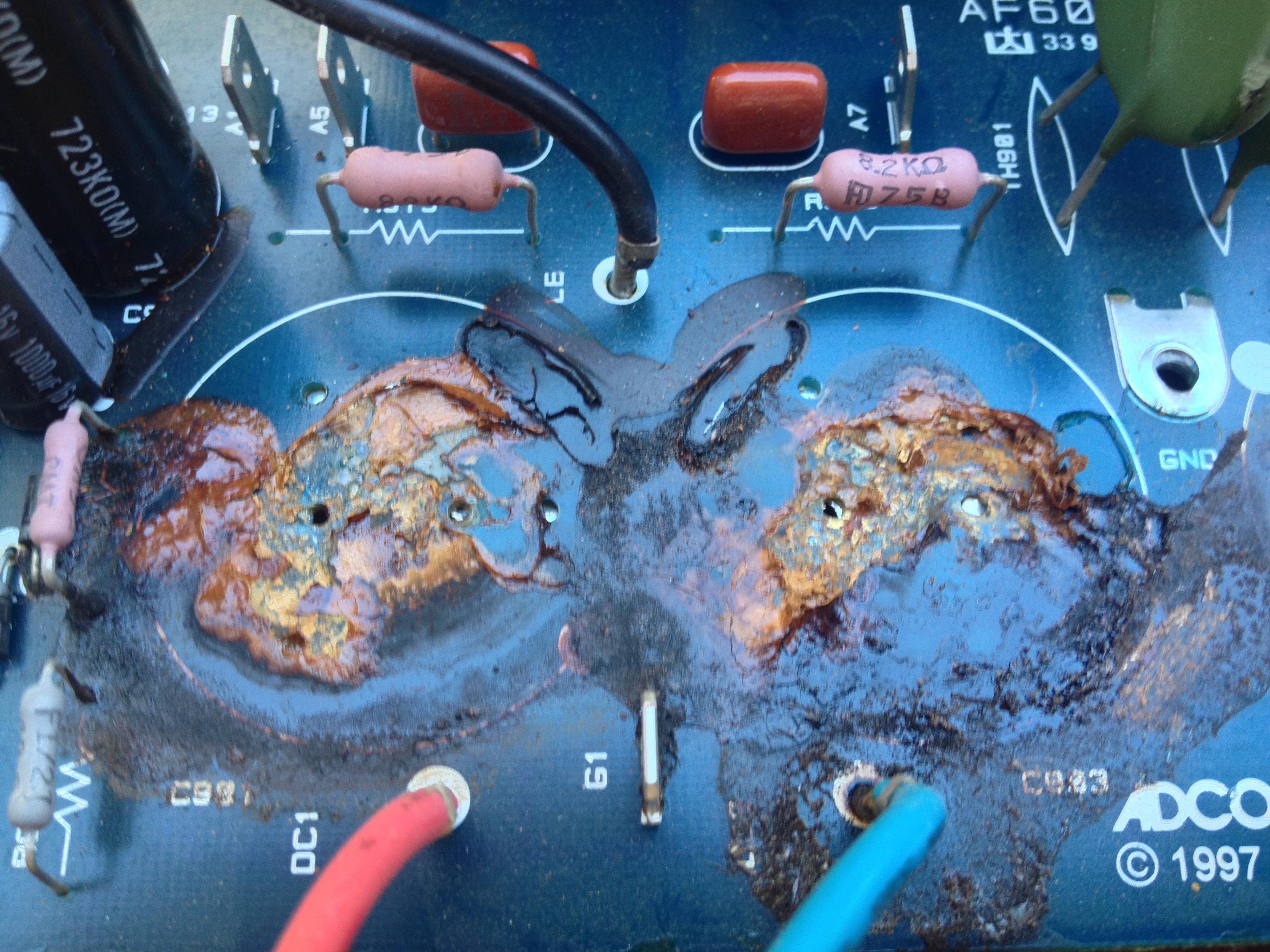

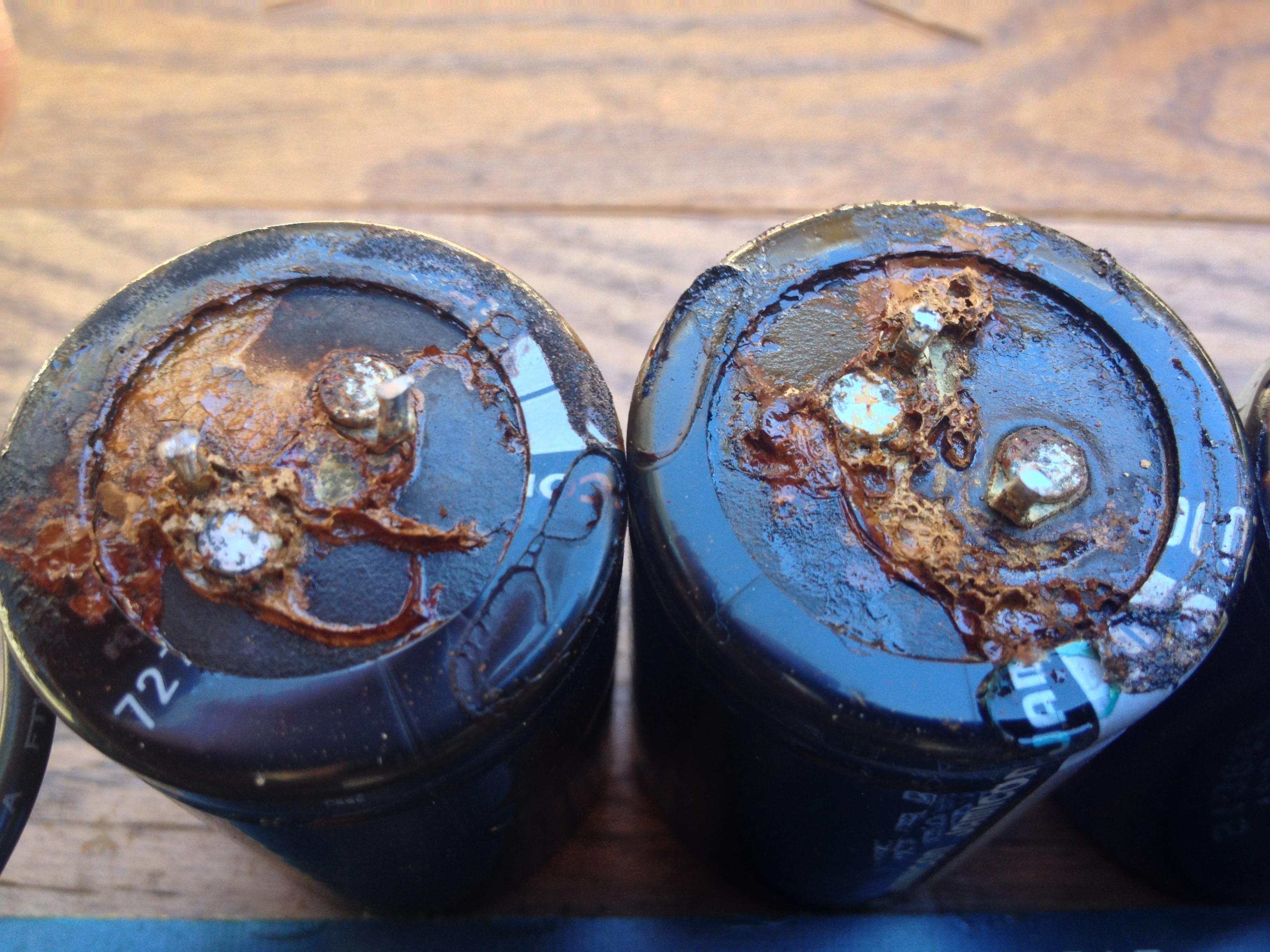

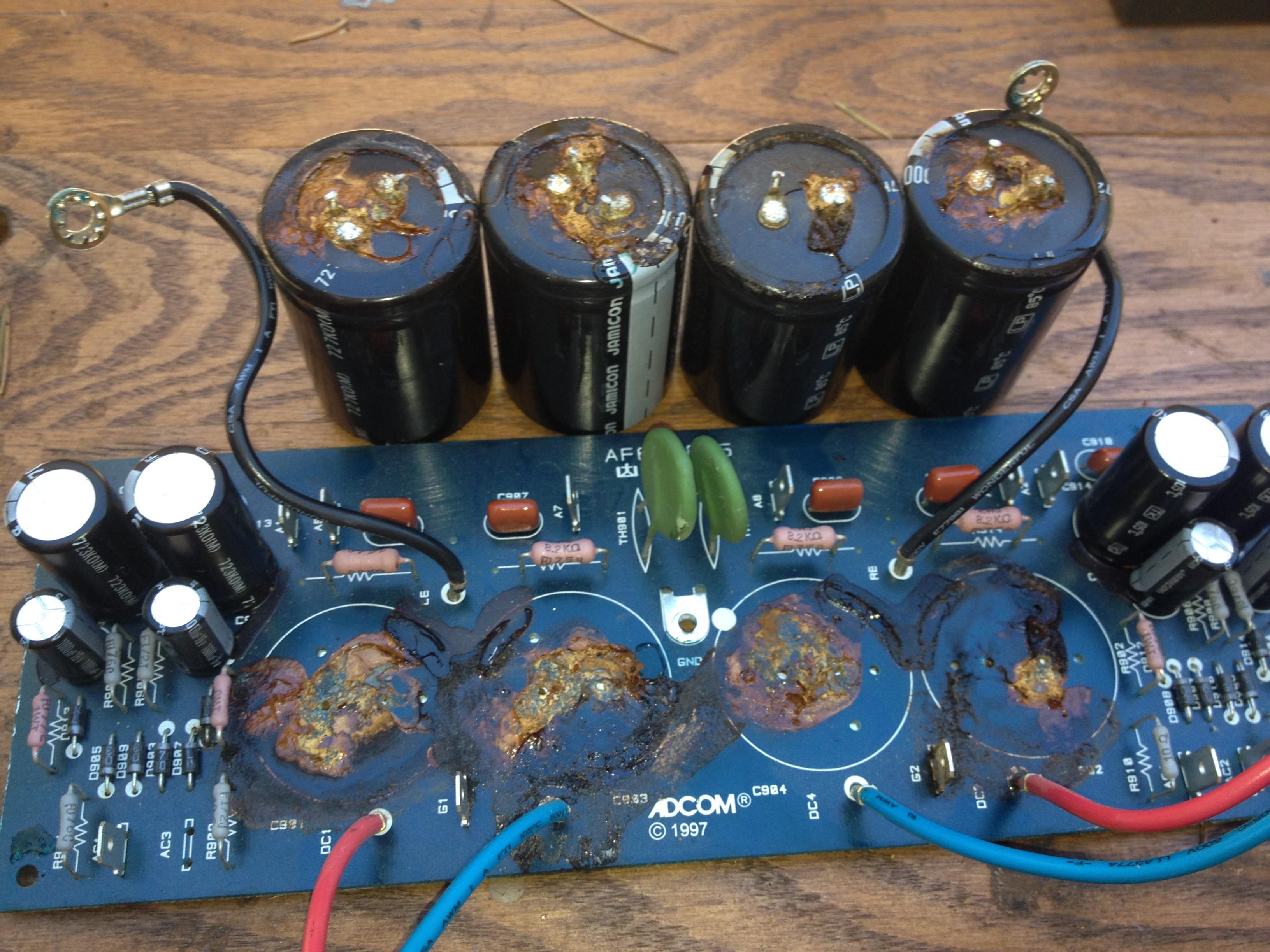

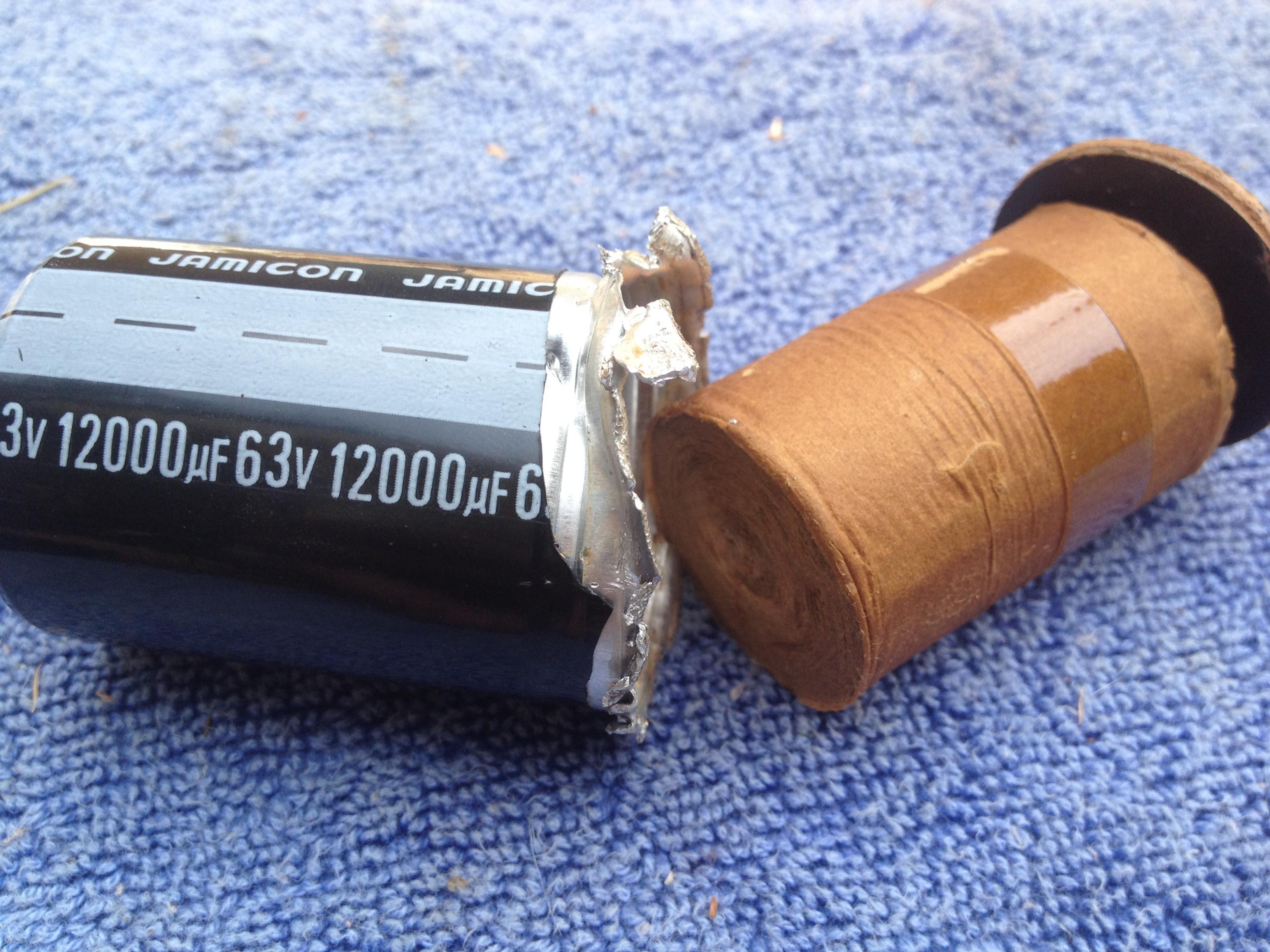

Not sure how much it adds to the thread but, I recently picked up a 5400 with some bad caps in the PSU. I was able to clean off the board good enough and Andersonix was nice enough to lend me some caps for a temp fix, I had to piggyback some smaller value caps but it works. Pictures below of the PSU board, bad caps and temp fix. I pulled one cap apart and it was near bone dry, only a few drops of electrolyte left inside the case.
I have 110VAC mains and re-tapped the transformer for 220VAC to lower the rail voltage. Now that I know I still have plenty of power at the lower voltage I should be able to recap with larger value caps on the stock PSU board.

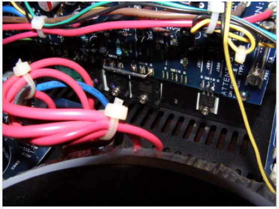

Is this even possible?

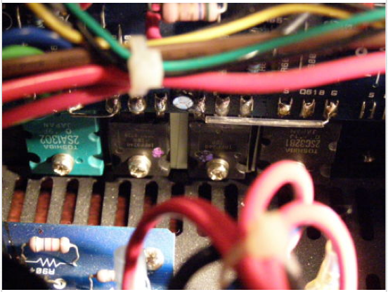

Currently on ebay there's a Stan Warren modded 5400: "which was custom modified by Stan Warren two years ago. He replaced some of the mosfet devises with super fast toshiba high current transisitors along with many other internal modifications. He felt that this was his best sounding modified Adcom. On the outside Vampire RCA’s, Furutech IEC and Gold binding posts were added. This amp sounds smooth yet detailed with allot of slam."
The pics appear to show one of the original IRFP240 Mosfets in parallel with a Toshiba 2SC3281 NPN (and similarly on the negative V rail, an original IRFP9240 Mosfet in parallel with a Toshiba 2SA1302 PNP) and one of the original Mosfets left out. It appears the Base of the 2SC3281 (in position Q618) is connected to the Source of the IRFP240 in position Q620) with an additional link (and similar connection on the -V rail).
What's going on there? Mosfets paralleled with BJT?
